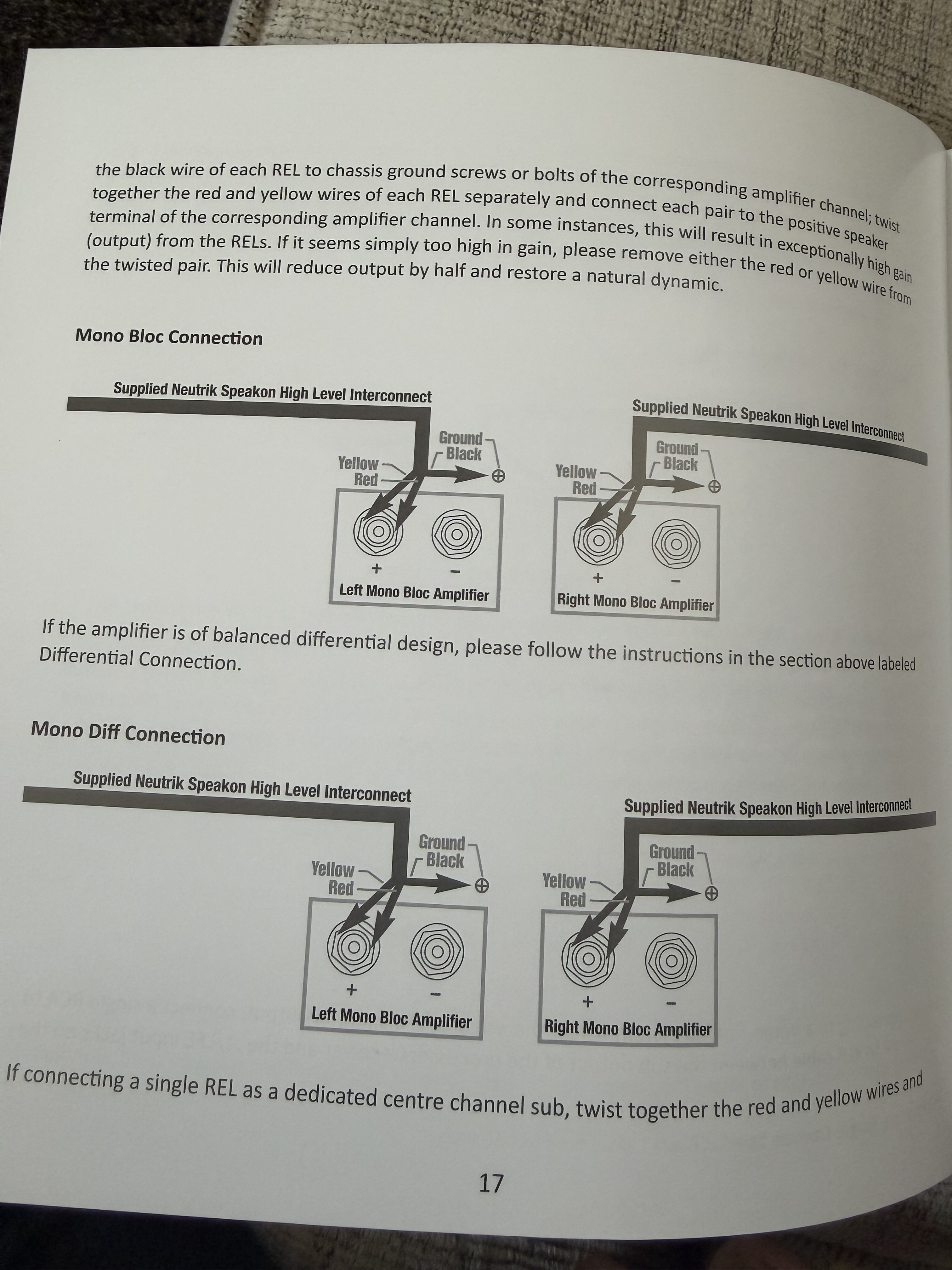

    I’m thinking I could start by disconnecting the ground wire from the cable from the subs, that they have you attach to a screw on the enclosure of the amp.
    I don’t understand why this couldn’t just be connected to the - negative binding post.

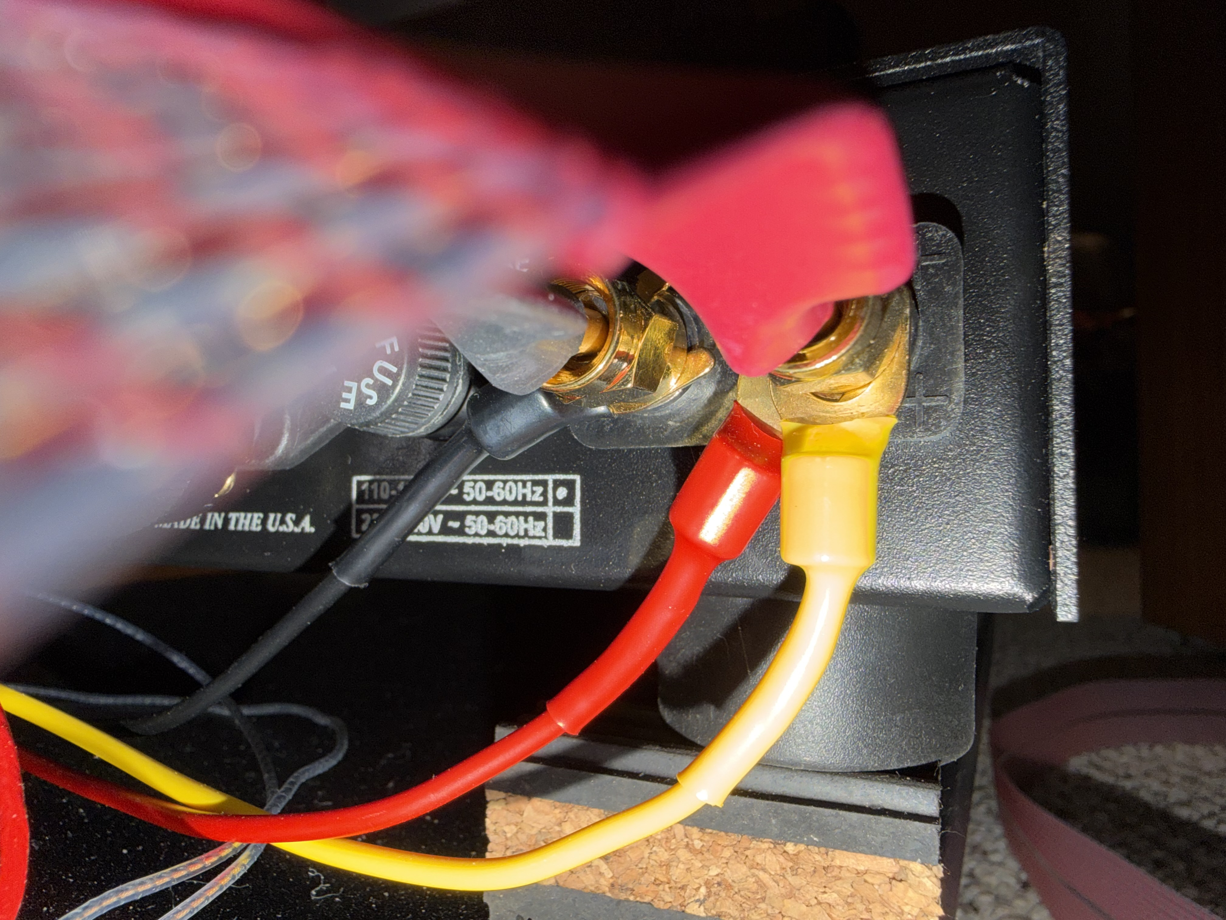

    Also, the cable that comes with these subs, is like 12 feet long, I also hate using bare wire, and wrapping bare wire around one of the screws on the back of the amps for a ground, is sloppy, and cheesy to say the least.
    I plan to shorten this cable, put a spade on the red/yellow wires, add a grounding lug on the back of these amps, put an eyelet on the black wire, and add a brass thumb screw..
    Be/look a little more professional on the backside of these amps..

    The manual said to ground it to a screw on the amps chassis..

    It all worked out for the better, the cables were 30ft, I cut them down to 12ft, put boots on the wires, and soldered spades , they cam out really nice..
    I had a set of SVS speaker cables, I desoldered the spades off them, what’s also cool about them, is they are kinda like MIT’s, you can swap the spades with bananas if you wish, since they screw on-off. I also stole the boots off them as well, worked out beautifully ..

    There are 3 types of grounding, earth, signal and chassis. You went from a chassis to a signal ground. One can Google the differences/reasons for each.
    I'm pretty sure REL used to tell users to connect the black wire to the negative binding post.

    The ground wire to the negative terminal doesn't work with all amps but it does with most. For example, PS Audio mono amps carry a balanced signal to both terminals so they include a dedicated grounding post on the back of their mono amps. The negative terminal isn't a ground on this type:

    Would have been nice if REL would have explained more in detail hooking them up with certain amps, and or not hooking them up with certain amps.
    I honestly kind of wish I didn’t look at the manual, and just hooked them up.
