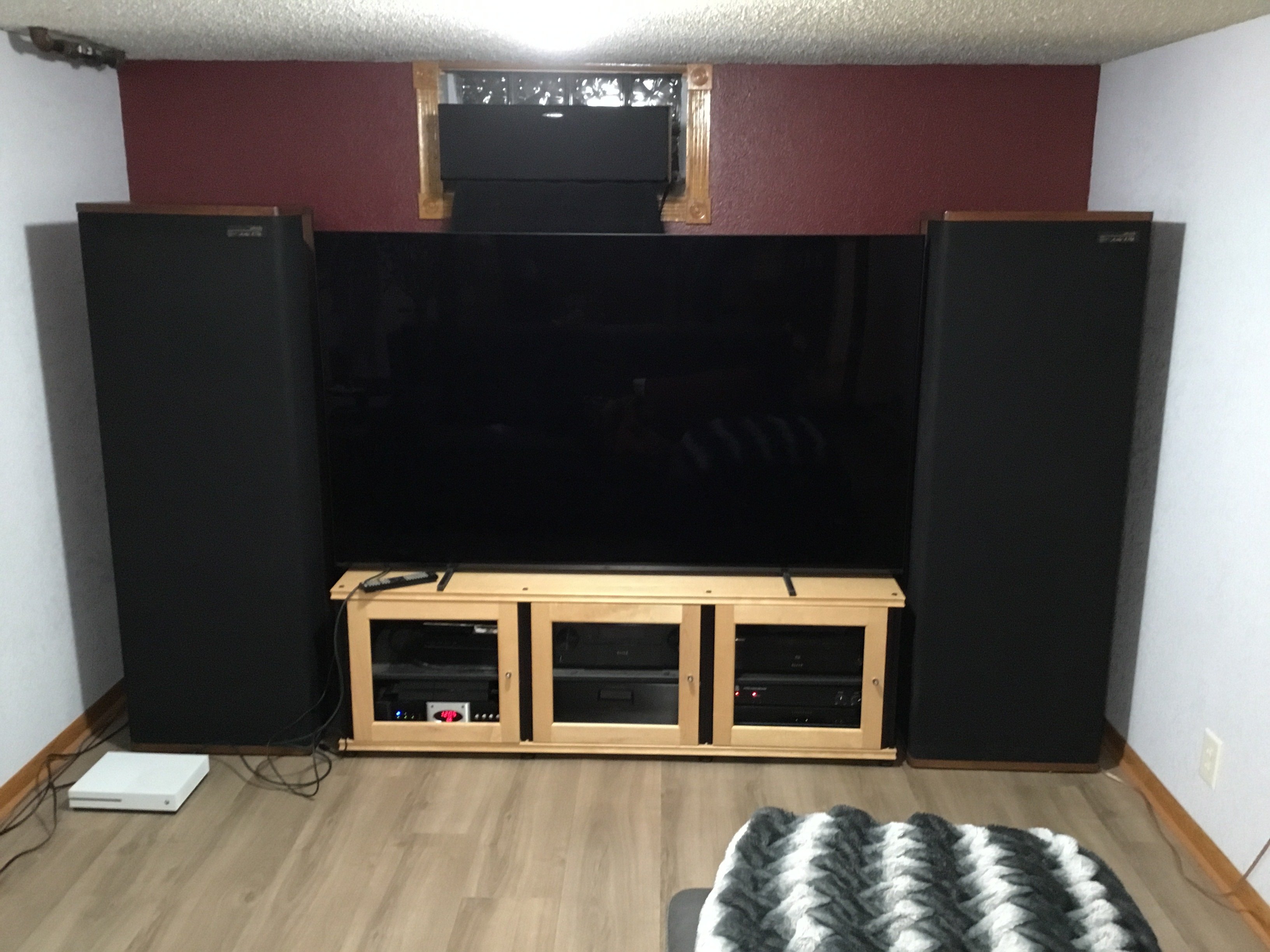

My home theater room is approximately 25 foot long by 10 foot wide. Went away from carpet because of wife. Now I installed LVP. I took off metal spikes from base of SDA and I am asking.
Do they have to go back on for great sound? Tried last night with washers underneath to protect floor. Cross threaded one of the inserts and gave up. Just have some 1/4” rubber pieces under them now.

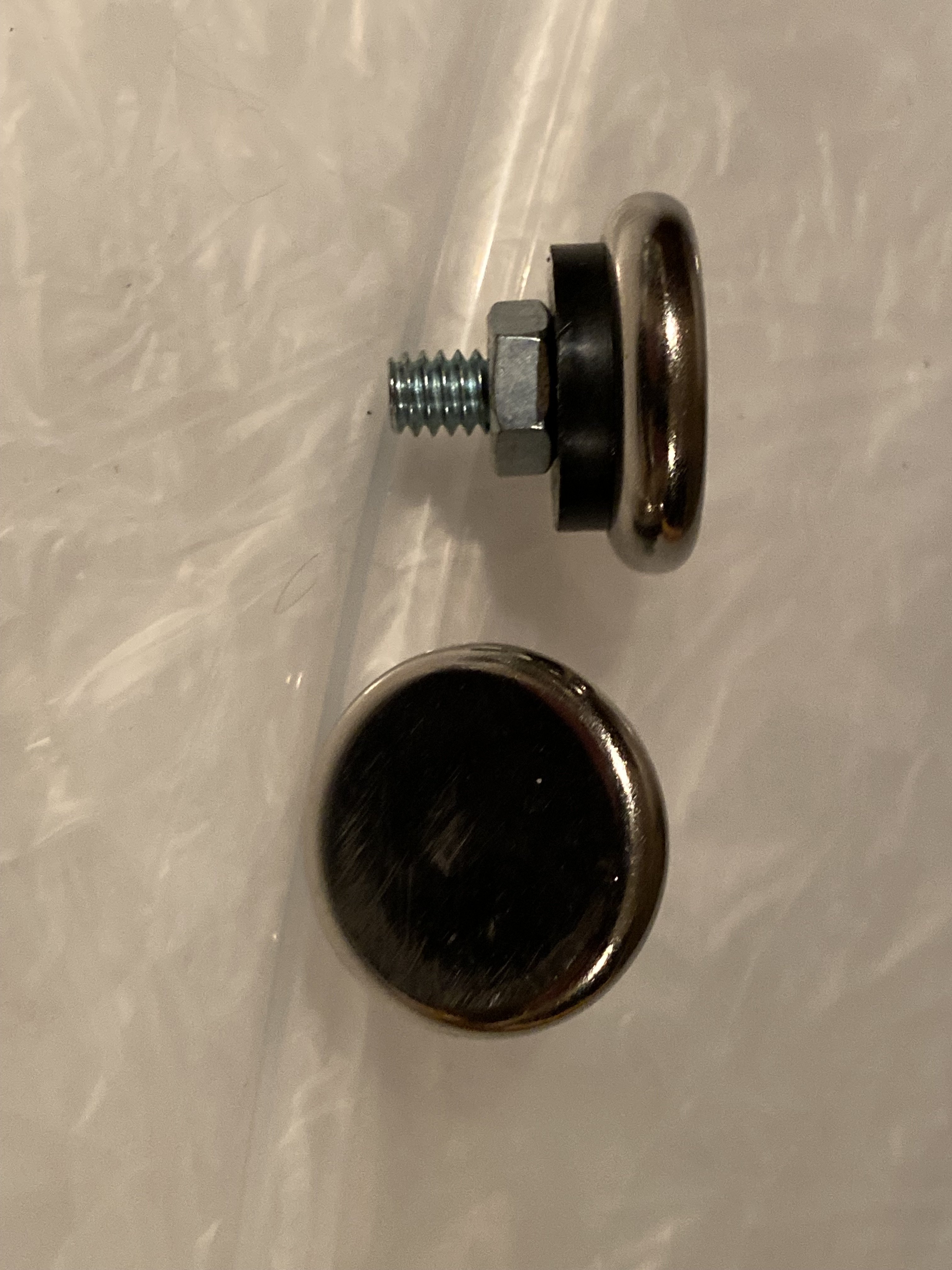

First question is are the screw in to base thread pieces available? They screw into wood and are threaded for the spikes. I believe they came stock on speakers.
My speakers came with discs that screwed in to threaded screws on base.
I think that is how they came from Polk.
Cannot for the life of me find where I put them?

    That room needs smaller speakers. Those being so close to the walls that is going to be problematic IMHO of course. As far as the cross threaded insert, I'd try chasing it with a 1/4"x 20 tpi tap to clean up the threads first. They are nothing special, just a 1/4x20 tpi T-nut. You would however more than likely need to remove the bottom cap.
    xschop Posts: 5,470
    Agree with Pit. A set of CRS+, possibly 3.1TL's would SDA image more correctly in that room.

    Yes the glides are very common. You're more than likely able to pick a set up at most building
    centers. Just make sure the thread is 1/4x20. On that floor with glides those cabinets will walk, on my 2.3tl's on very short carpet on a concrete basement floor with no padding my 2.3tl's would move ever so slightly after a good session. Move enough to mess with the stage image, ON carpet. So yes on LVT they will walk from the drivers motions.

    Because of the short cabinet depth, the tall cabinet height, and because a lot of the weight is in the top half the speakers where the active drivers are located they are inherently unstable. Spikes help stabilize the cabinets. The threaded rod insert in the backs of the cabinets to brace the cabinets to the wall were also a good idea but I never saw the need to use them on mine when I was using spikes.
    The ones I had came with furniture leveler feet things that went into the inserts. Easier to move them that way but I replaced those with spikes.

    Wondering if they would be better suited placed on the long wall?
    Would help with imaging but may still over-power that room.
    Would have lot's of bass placed that way.

    I had a pair set up close to the walls in a smallish room and they performed surprisingly well. Of course they turned the room into a big bass drum but they still sounded impressive! Stereo imaging was good but the SDA extension to the sides wasn't there.

    Hardware stores like Home Depot, and online sources, carry the furniture leveling feet like the ones that were originally provided with the SDA-SRS but not all of them are in the same thread size from what I remember. Some have their own inserts for mounting into cabinets though.

    bcwsrt Posts: 2,554
    Finally found my pic …

    skipshot12 wrote: »
    Agree. Long wall placement would have many benefits. It would place the screen very close to the seating, but that's not always bad. You need to be within ~7 feet of a 65" 4K screen to see the full resolution. I don't know if that would be enough distance to have a good SDA experience or not, which might support a smaller set as mentioned above.
    I have my HT system setup on the long wall because it was the only way that worked and I love it. Although, I have about 14' of depth to work with. It ends up with a 10' viewing distance to a 100" screen.

    Tv is 77 Sony Oled.
    I have thought about going the long wall way. But doors to other rooms and closets defeat being practical. Yes those are the feet that came on my speakers. I don’t remember seeing the wall braces. I will look. Thank you all. Been gone for a while from posting. Just no need to . Nice to see a lot of the same ol characters are still here to help.

    The bass brace was specifically made for earthquake zones. Polk said it also improved bass performance in lieu of spikes. I can say from personal experience that is false. Spikes are far superior.
    In addition, the bass brace does not prevent the cabinet from moving in a pivot manner.

    Hey there Dab. My SRS are in a room just like yours, but about 14' wide. I have a low ceiling as well with popcorn finish.
    My .02 - at 180lbs per cabinet, I find the sheer weight of them to couple with my carpeted concrete floor sufficiently. Adding foam to the rear panel helped immensely with the bass and richness. I am not going to spike (maybe someday) due to the leverage when tipping the cabinet to adjust the spikes for level, and the cumbersome task of moving the cabinet slightly when spiked, it's just me available, so unwarranted for my situation.
    I will second the vote for a pair of 3.1 tl if the elusive creature comes available. In my room they proved a better fit and I preferred them to the 2.3tl I had.

    You can ask just about any of us that. The answer is 5 to 6 inches off the wall works best with a half inch one way or the other making or breaking it.
    F1nut Posts: 52,050
    I was. Nine inches off the wall is too far out.
    F1nut Posts: 52,050
    Wait a sec...are you talking about the side walls or the wall behind the speakers?
    Distance from the side wall should be 3 feet. Distance from the wall behind should be 5 to 6 inches as I mentioned above.
