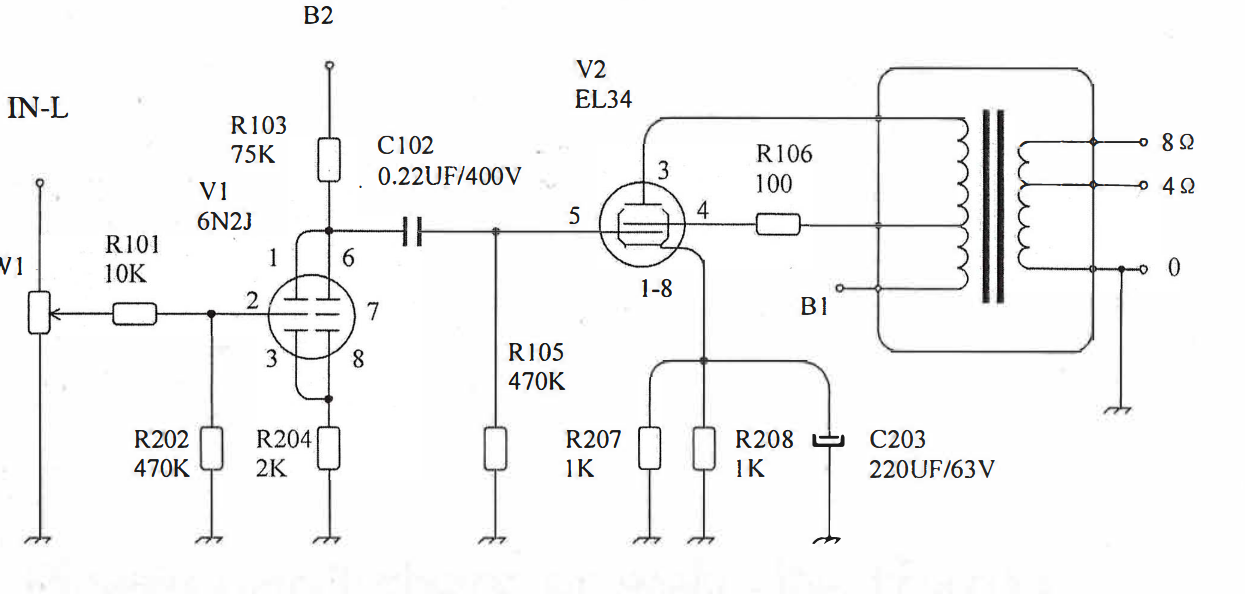

    mhardy6647 Posts: 35,562
    Single-ended EL34 outputs in that amplifier?
    Are they wired as triodes or natively as pentodes?
    If the latter, does it use single-ended ultralinear output topology?
  • Irrenhaus
    Irrenhaus Posts: 1,105
    I have no idea. Will this help.

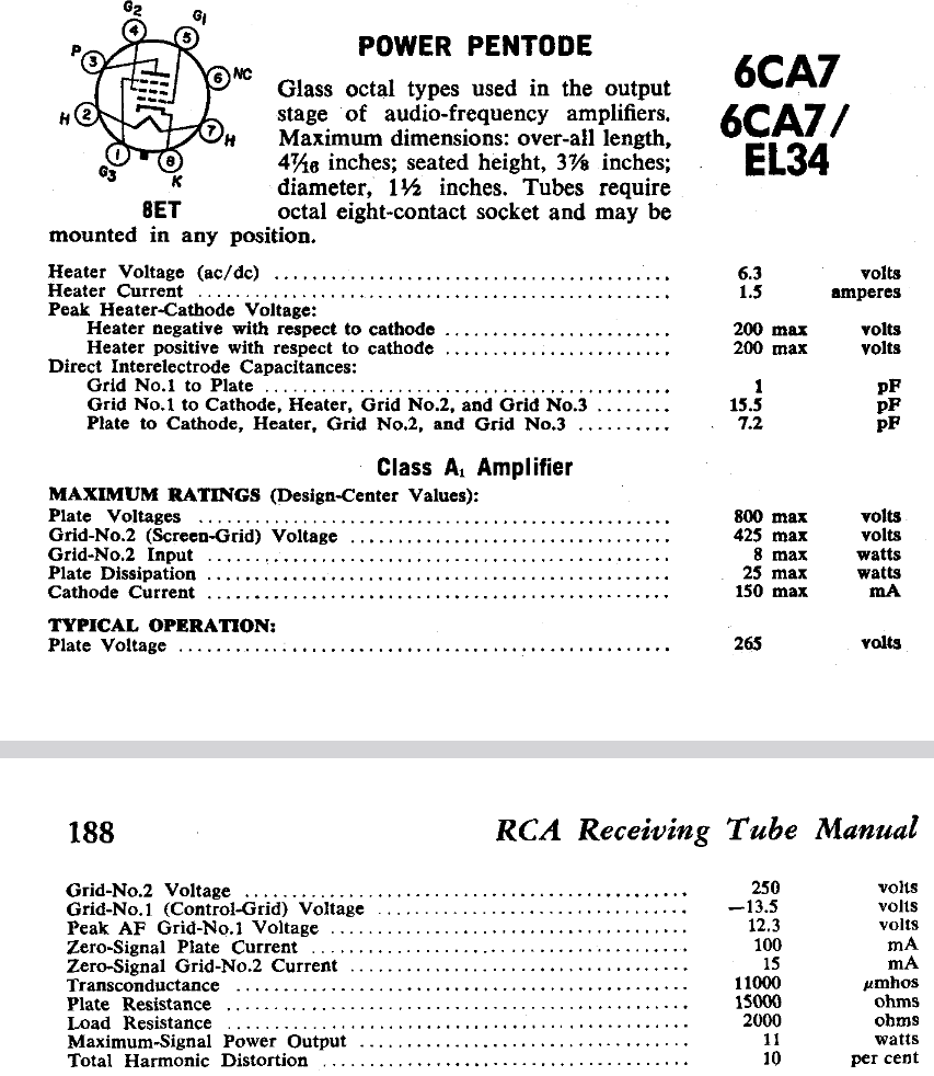

    Yup. EL34 Single-ended pentode ultralinear. You can see that 100 ohm feedback resistor from the primary winding of the output transformer, connected to pin 4 (screen grid) of the EL34 power pentode.
    Thanks!
    Probably about 8 to 10 watts per channel at "hifi" distortion levels (1%).
    source: https://www.worldradiohistory.com/BOOKSHELF-ARH/Technology/RCA-Books/RCA-Receiving-Tube-Manual-1965-RC-24.pdf

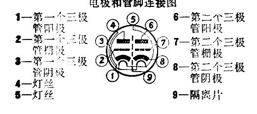

    note: The 'front end' (voltage amplifier) uses a Chinese 6N2J twin triode. This is apparently similar operationally to a 12AX7 but it is not interchangeable with the latter (different heater configuration and pinout). The Russian 6N2P appears to be a drop-in substitute, though, FWIW.
    EDIT: 6N2J is a military version of the 6N2.
    source: https://frank.yueksel.org/sheets/095/6/6N2.pdf
    6.3 volt heater (pins 4 and 5) with no center tap; pin 9 connects to a shield.

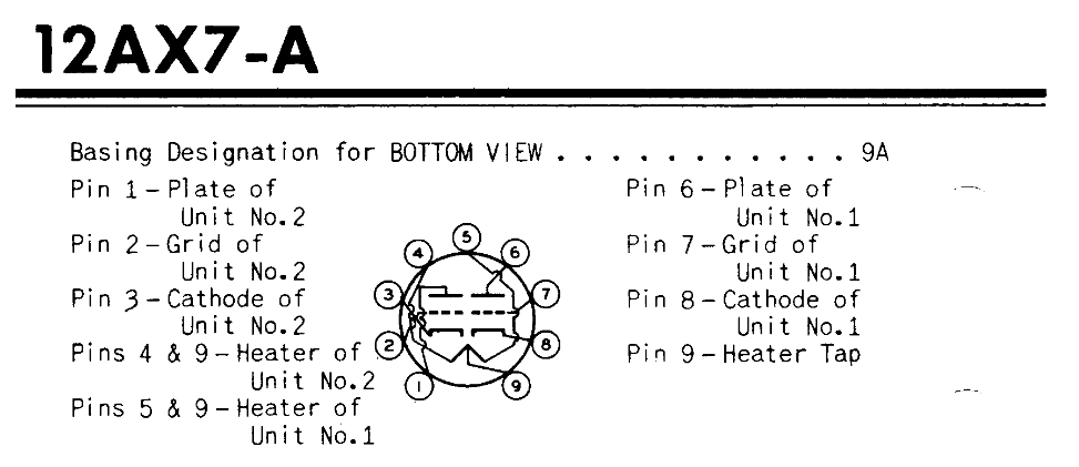

    Here's the "pinout" (basing) of the 12AX7/ECC83 for comparison.
    source: http://www.tubebooks.org/tubedata/HB-3/Receiving_Tubes_Part_2/12AX7-A.PDF
    12.6 volt heater with a center tap at pin 9 (allowing one to wire the two triodes' heaters in series or parallel)
    Bases are shown from the bottom.
