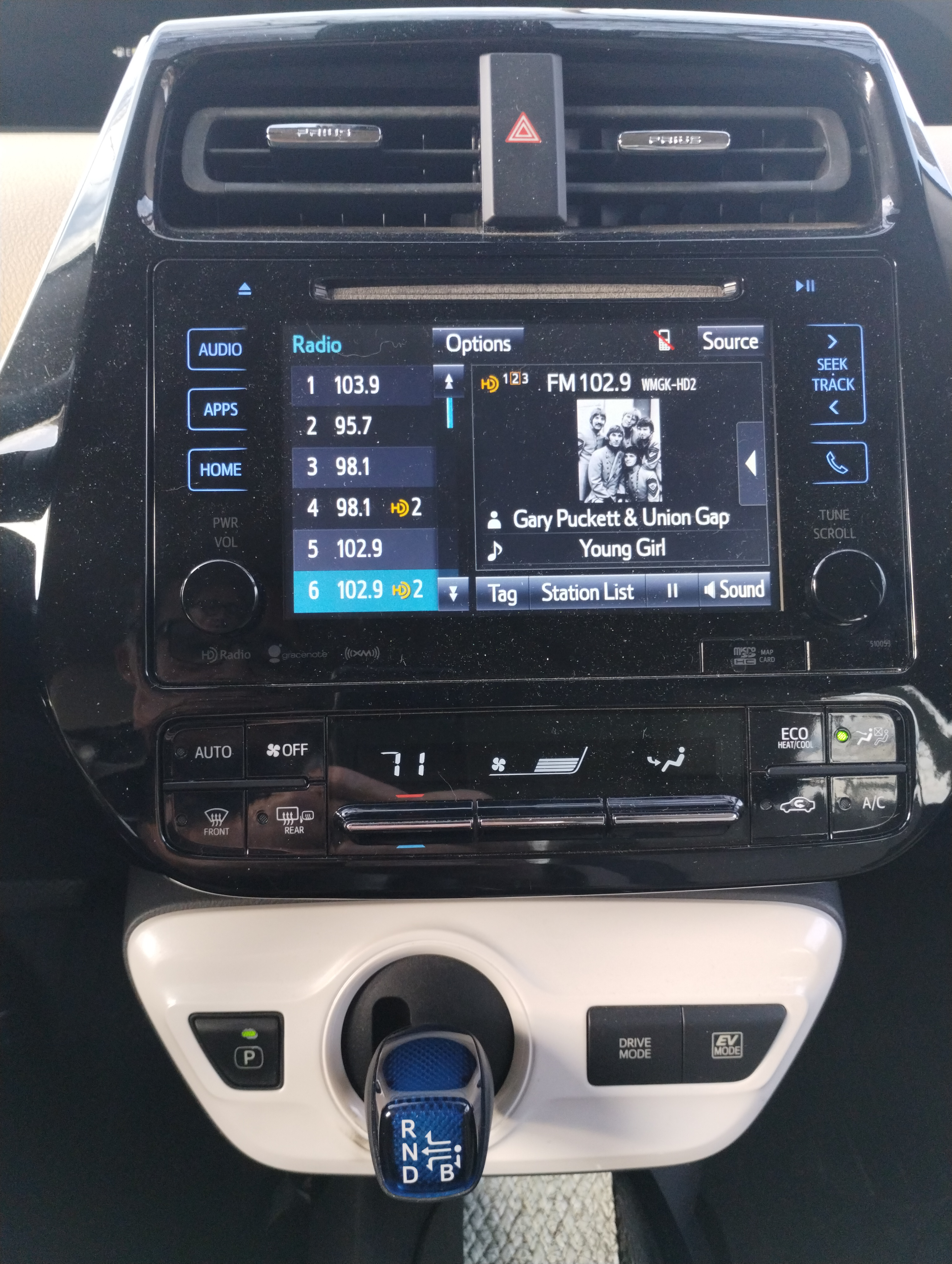

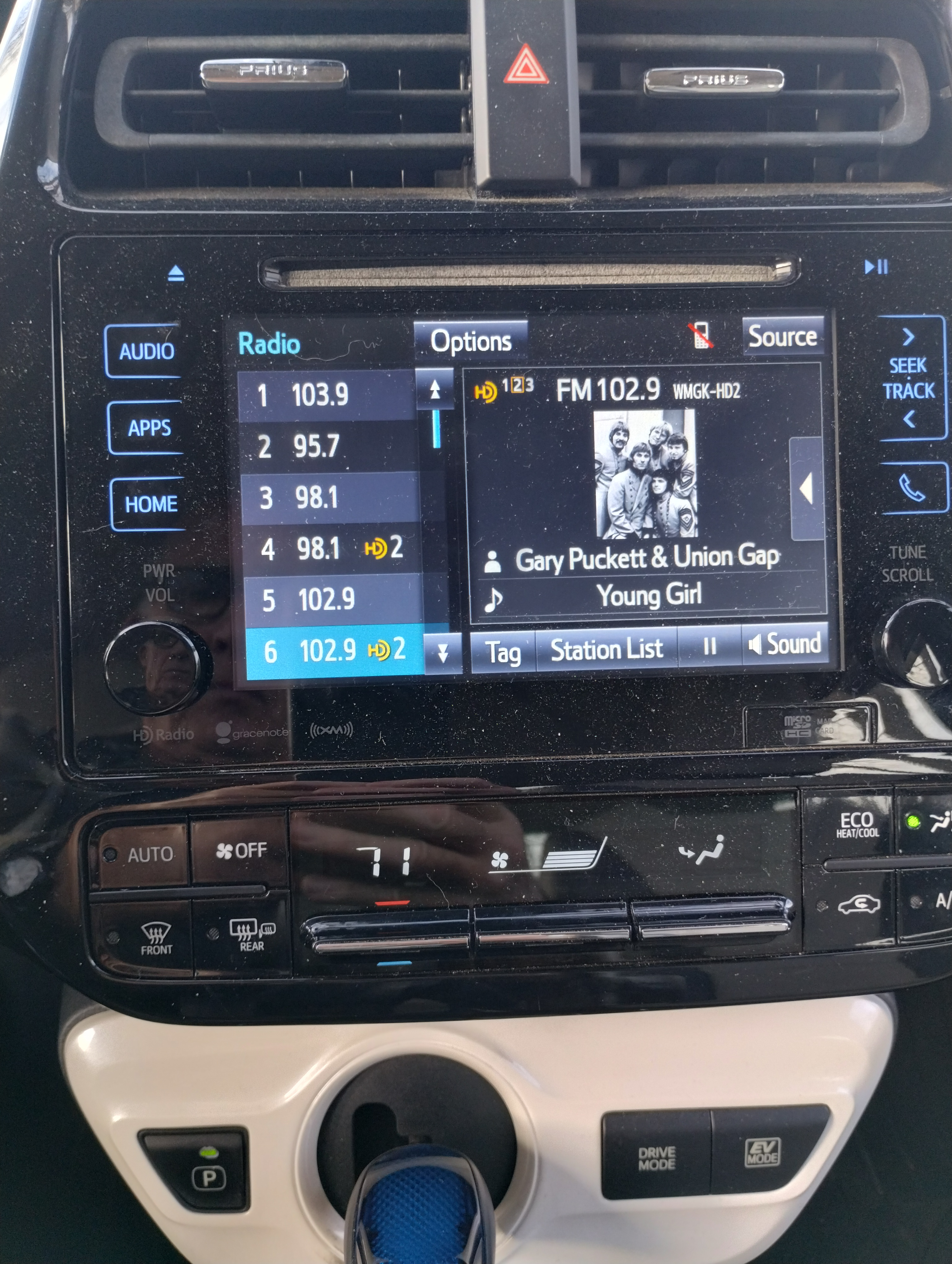

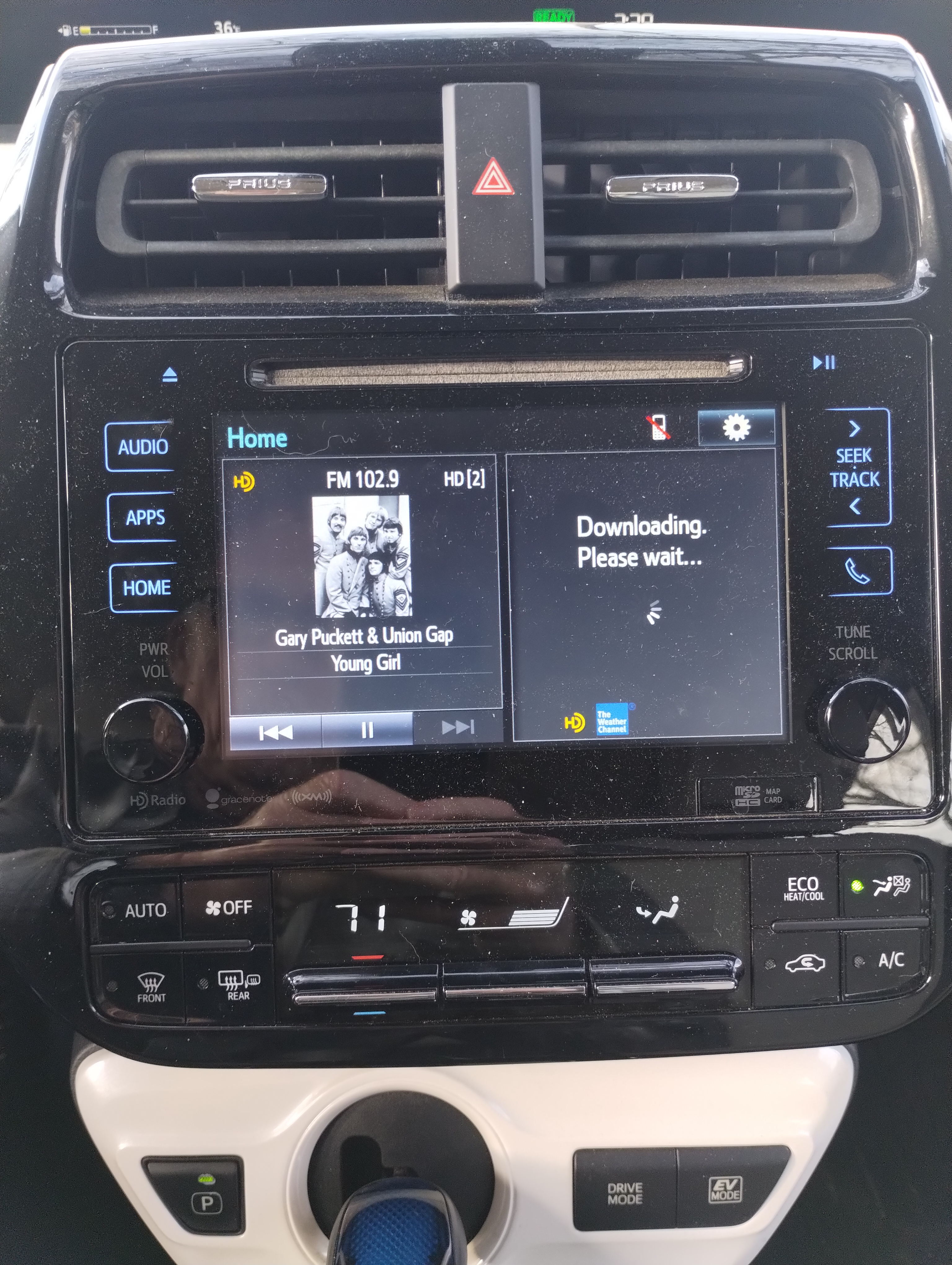

  • Jstas
    Jstas Posts: 15,001
    Yeah, I know Angelo too. The Greek mechanic I worked for was good friends with him. I wasn't sure if he was still in business, though. He knows his stuff too.
    But looking further into your situation, there, it looks like you have the premium stereo with Navigation. If there's no orange JBL badging anywhere then you should be able to get an aftermarket head unit for it.
    If you have JBL branding, it's going to be difficult and probably require a bunch of extra stuff to make something work.Im betting that if the JBL systems in the Prius are like the JBL systems in some Fords then there's amplifiers everywhere and that creates a signal path problem that will either need some fancy, expensive electronic chicanery to work or you'll have to bypass everything and wire the head unit amp directly to the speakers with new wiring. Lots of labor and probably almost as expensive.
    If you don't, it can still get expensive because there's an entire bezel around it that will have to be changed to adapt to whatever aftermarket setup you get. But it's not going to anywhere near as expensive as if you had the premium JBL system.

    Yeah he's still in business. He's a character for sure. I don't see any orange JBL labeling on the unit so I'm assuming it will be an easier install.
    I'll give Crutchfield a call just to get there take on it & pay Angelo a visit to see what he says.
