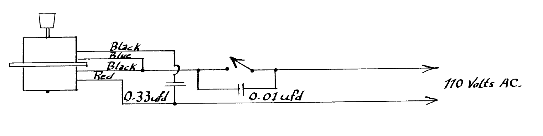

I took a TD-150 to a guy for some work and suddenly the platter spins backwards sometimes upon start or it needs a helping hand to start spinning other times. Both capacitors were replaced. Anybody have a motor or a problem-child TD-150 I could purchase for the motor? I’ve heard the motor from TD 165’s are the same but I haven’t confirmed that. Don

    It's a pretty simple circuit, make sure the wiring was done correctly when the capacitors were installed:
    The service manual for the TD 165 shows the exact same wiring for the motor, however the part number for the 150 motor is S 804-550 and the TD 165 part number is 7.861.017. This might mean the two motors are similar but the mounting brackets (or pulleys) are different.

    Maybe the polarity of the caps needs to be switched?

    It should be a non-polarized motor start/run capacitor.
