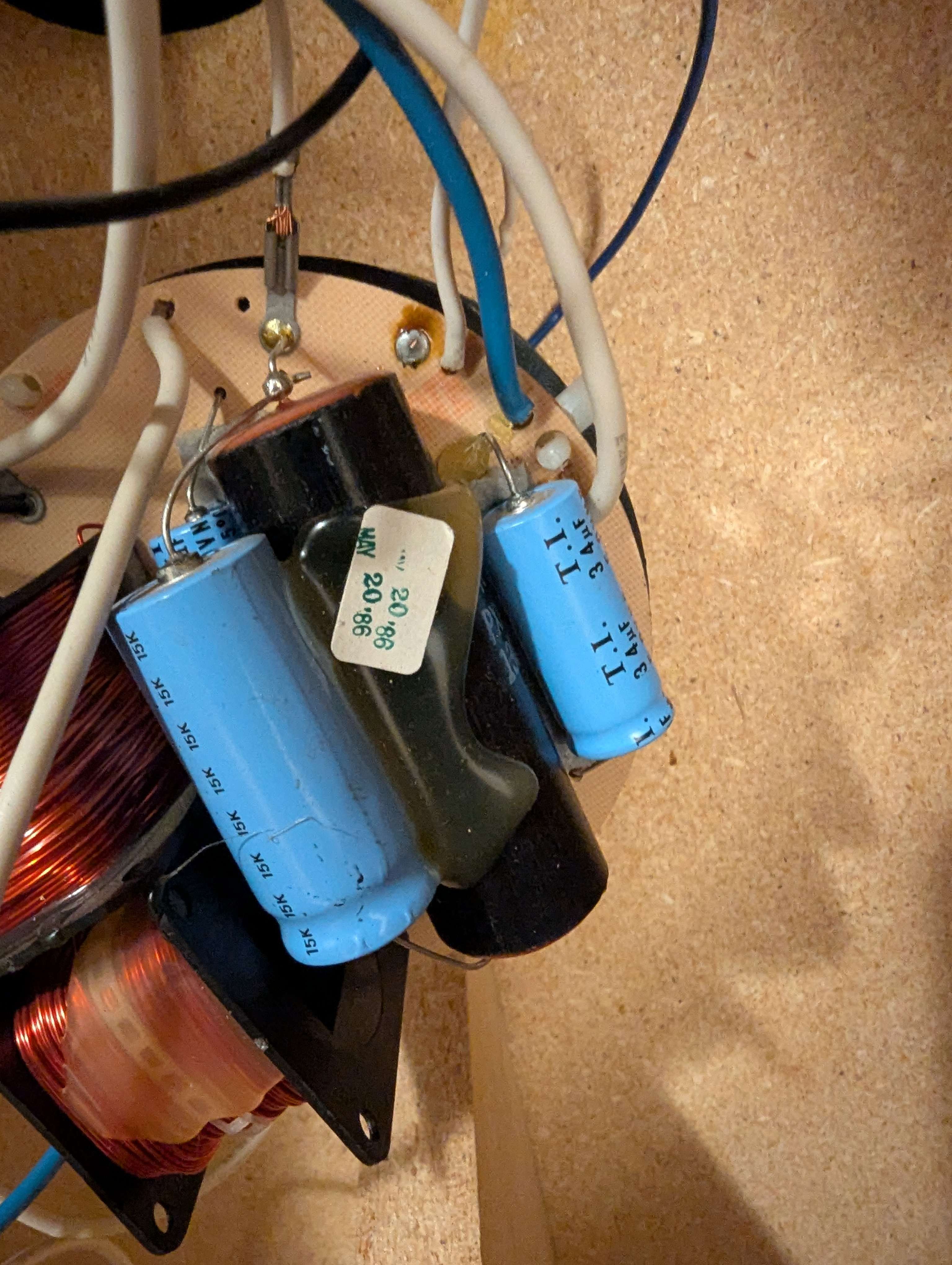

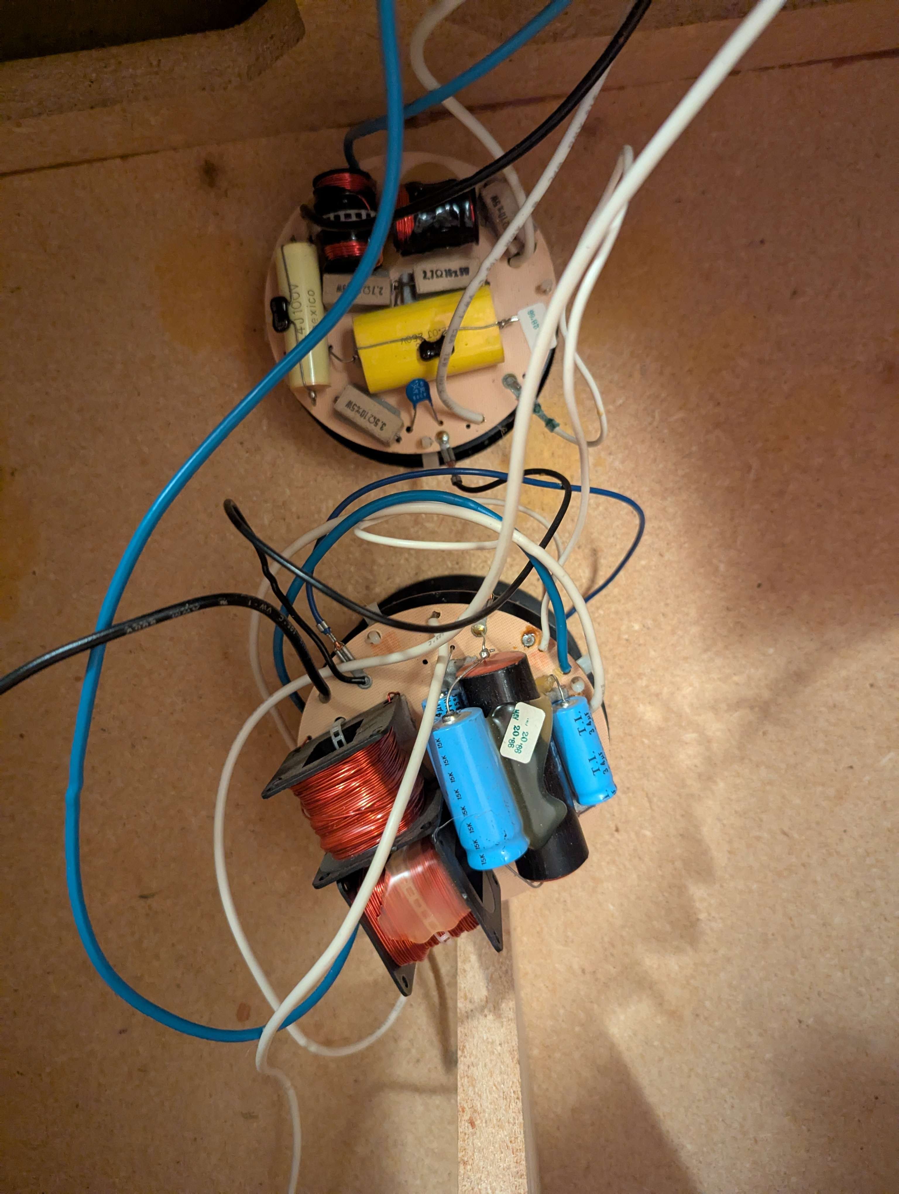

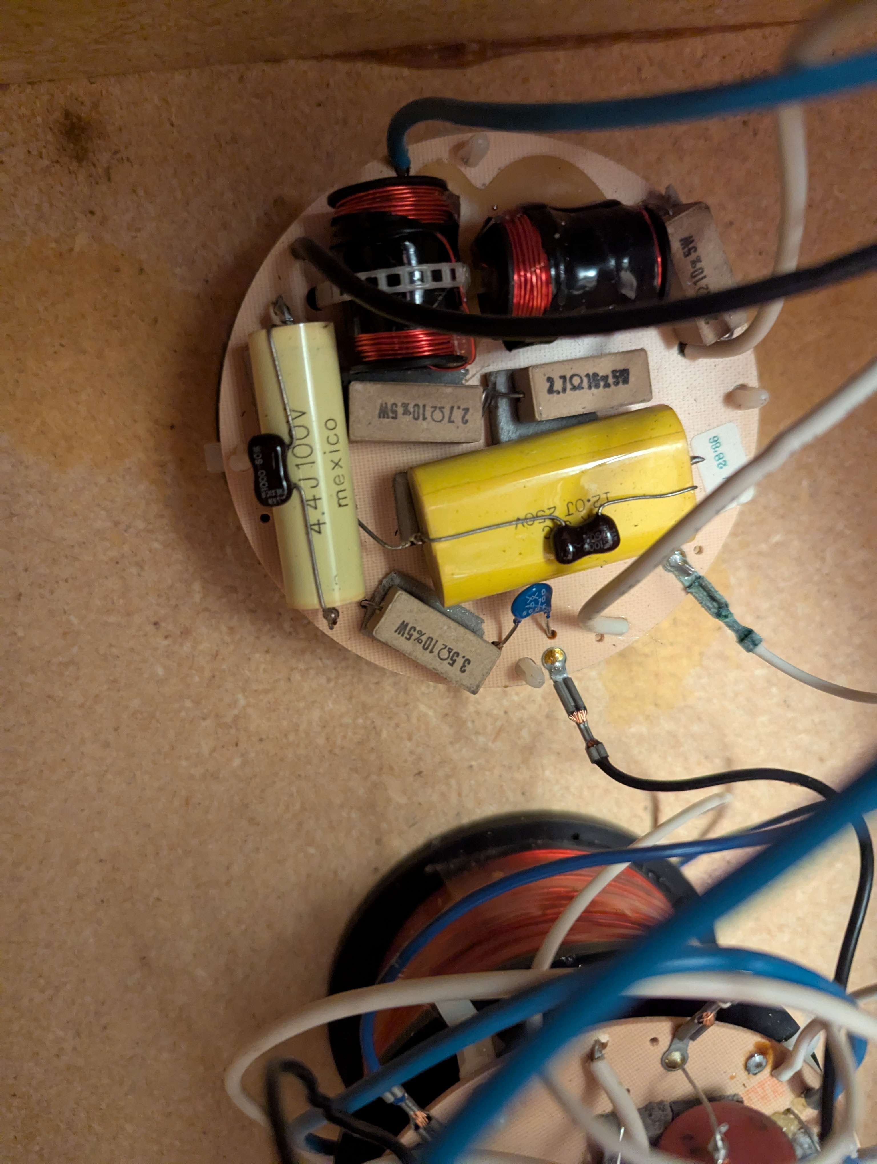

    Attached are some images of my stock crossover. I also notice that the VR3mod version states for "1987" revision.. concerned this would not work for the Blade/Blade 1986(?) variant I have.

    The RD-0194 is the only option you have. There was no sanctioned Polk upgrade to use the RD-0198 tweeters in the blade/Blade or Pin/blade. It was talked about but to my knowledge none that Polk sanctioned.
    Your best bet is to replace all caps, resistors and inductors.
    Jantzen air-core perfect lay inductors is what most of us used in our rebuilds.
    With good quality poly caps and resistors (not sandcast or ceramic)you can take them to the next level.
    Most have used Sonicaps and Clarity caps. Resistors have been replaced with 10 or 12 watt Vishay-Mills, Jantzen or Mundorf.

    You can ask Trey (VR3) your questions about his work either through his site or here.
    I can say the 2 crossover versions are very different, so yours does not look like the 1987 version.
