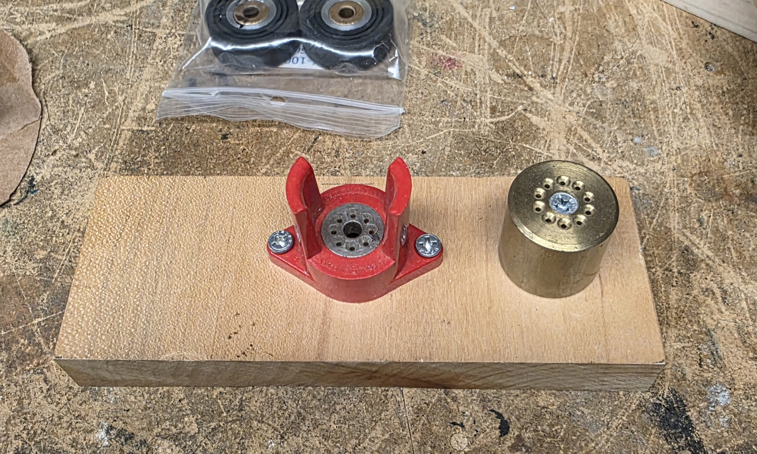

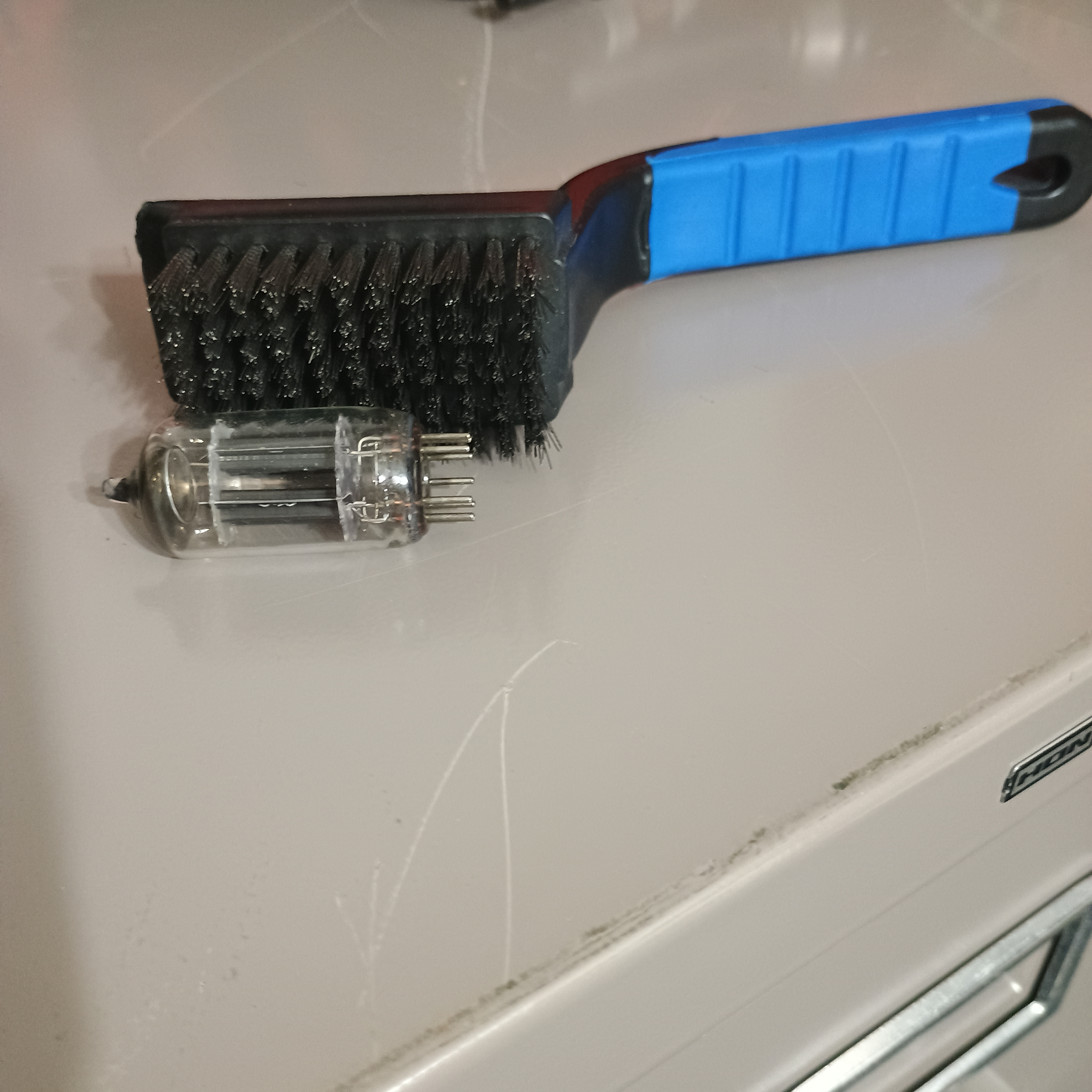

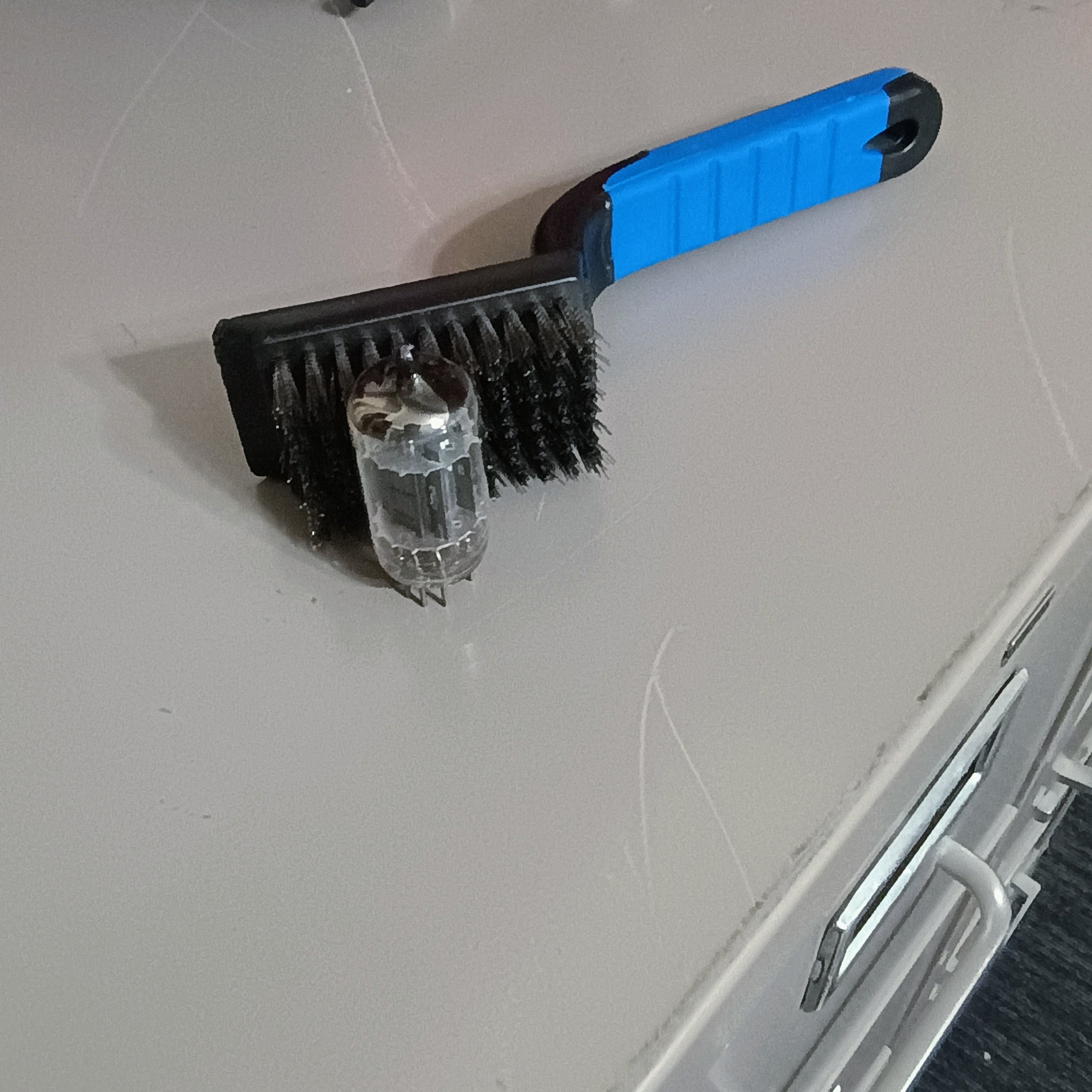

    I use a stainless steel brush from Harbor Freight. It works REAL well on tubes that do not have a guide pin {6sn7}. I just hold the tube and move the brush back and forth and circular in nature. I then spread some red deoxit on a toothbrush and do the same on the pins set aside to let dry/evaporate some so none is running off the pins into the electronics below. Honestly I do not use so much that it would, I rather be safe.
    Those that do have guide pins I use a 3M green scrub cut to a size that works easily to get between the pins and guide pin. I've even used a piece of 800-1500 or higher wet/dry sandpaper then blow off. Personally I've not found anything that cleans the socket well for 9 pin tubes. All the super small brushes I've found were too large, definitely don't want to make those bigger, or break them. I just work a firm toothbrush on the sockets best I can get it in. nvdnfznkyvpb.jpgithvwivzhqoc.jpg

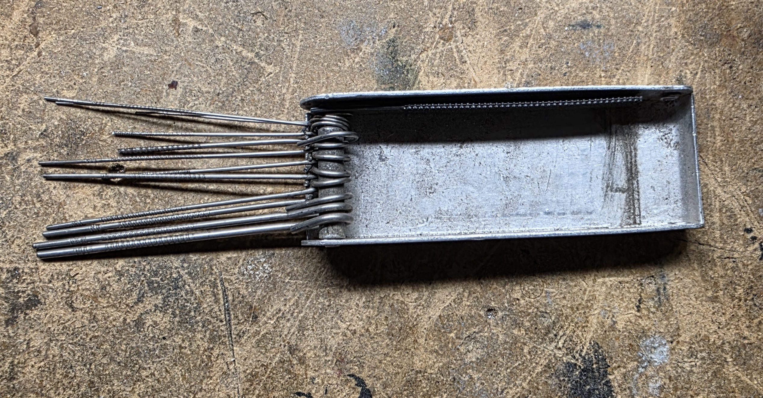

    I have used spiral torch tip cleaners on really nasty old receiver tube sockets. They are the break glass in case stainless didn't work. Start out small with those as they are like a file and will remove material. A Dremel cut off wheel or side cutters can lop off the pilot end. You can see some of my tip cleaners are trimmed to business end.

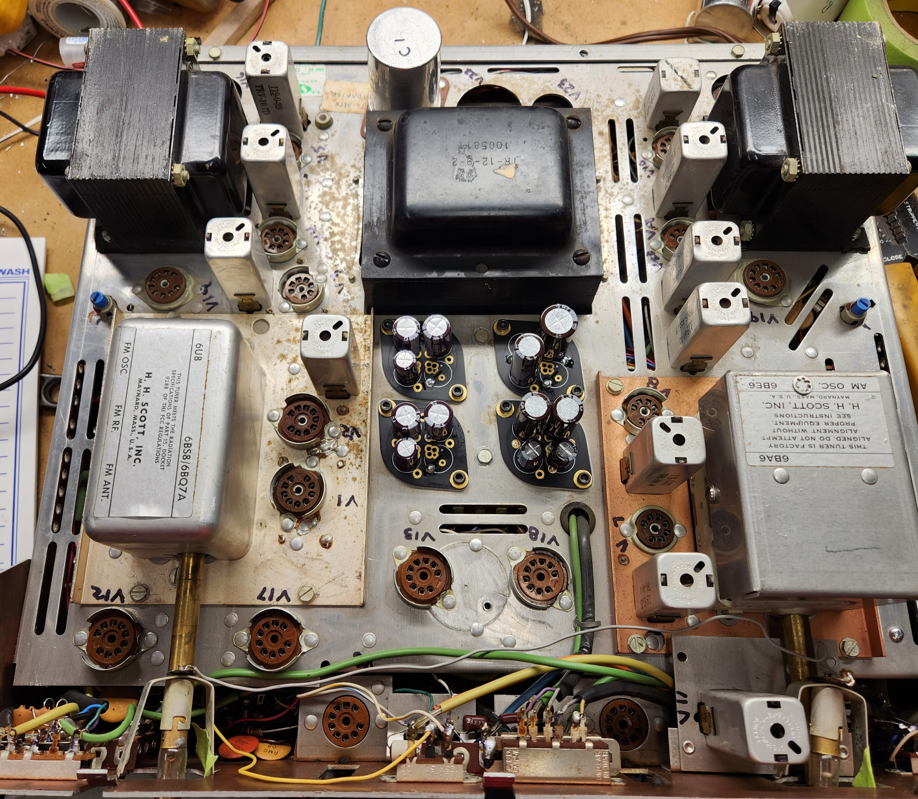

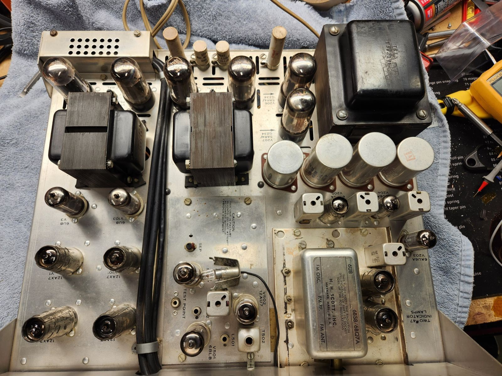

    The Scott 340 and 399 (early '60's) I refurbed had some nasty tube socket terminals. 18 tubes in the 399.
