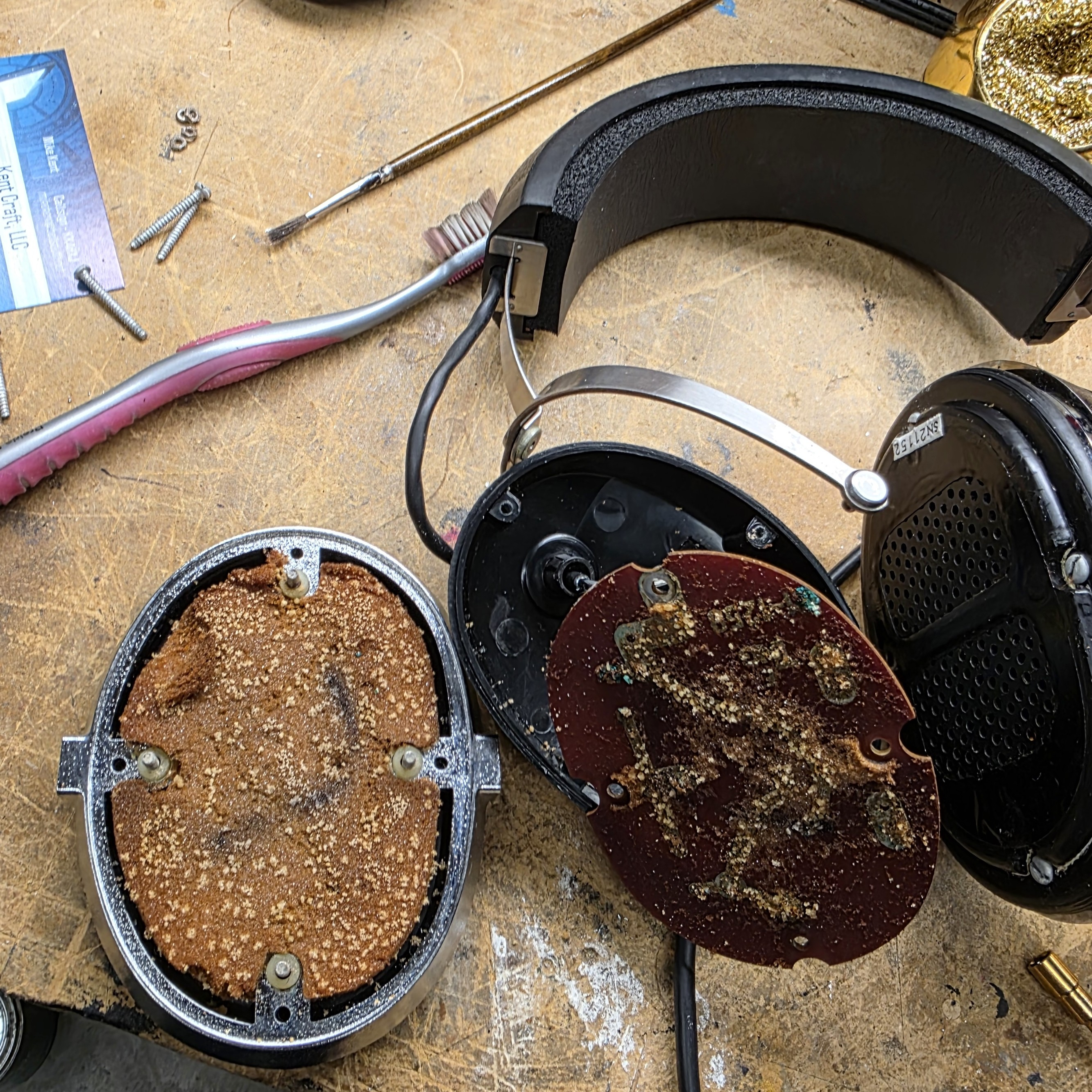

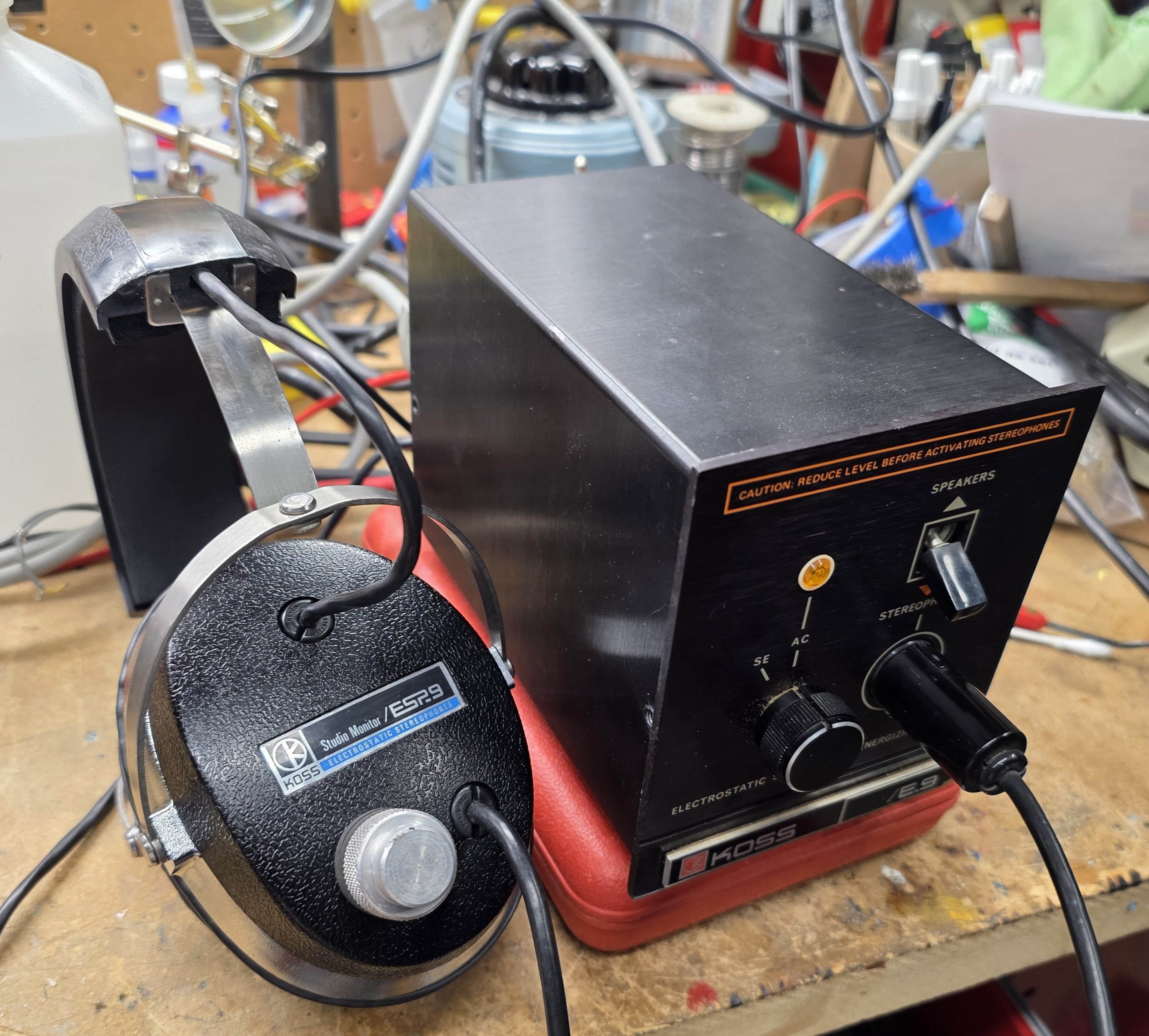

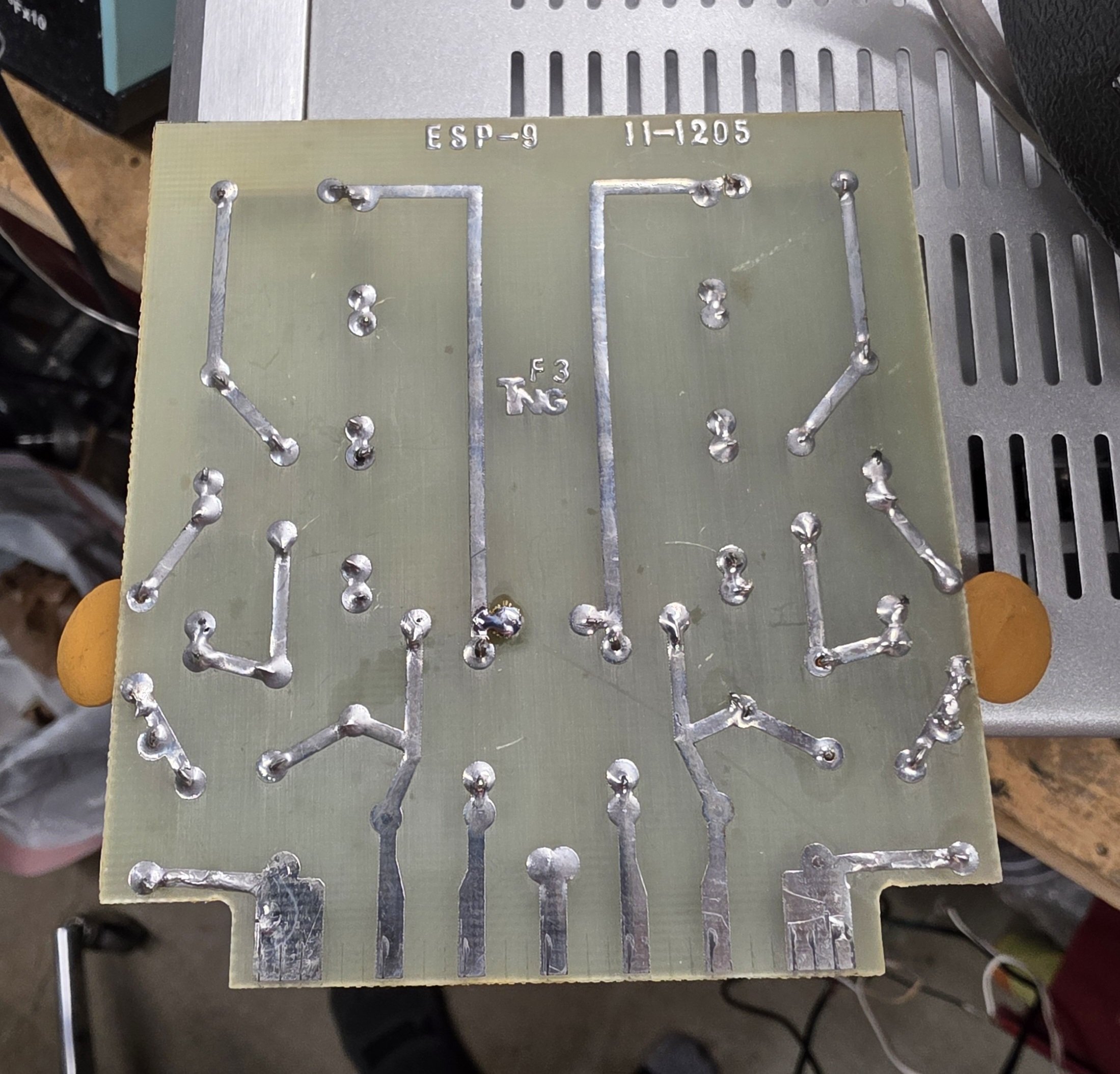

I've had these Koss ESP-9's here since February when Ed the SRT King dropped them off picking up his R2R. I figured I'd better dig into them. They didn't work. A little research, foam deteriorates in the cans and can corrode the traces on the PCB's.

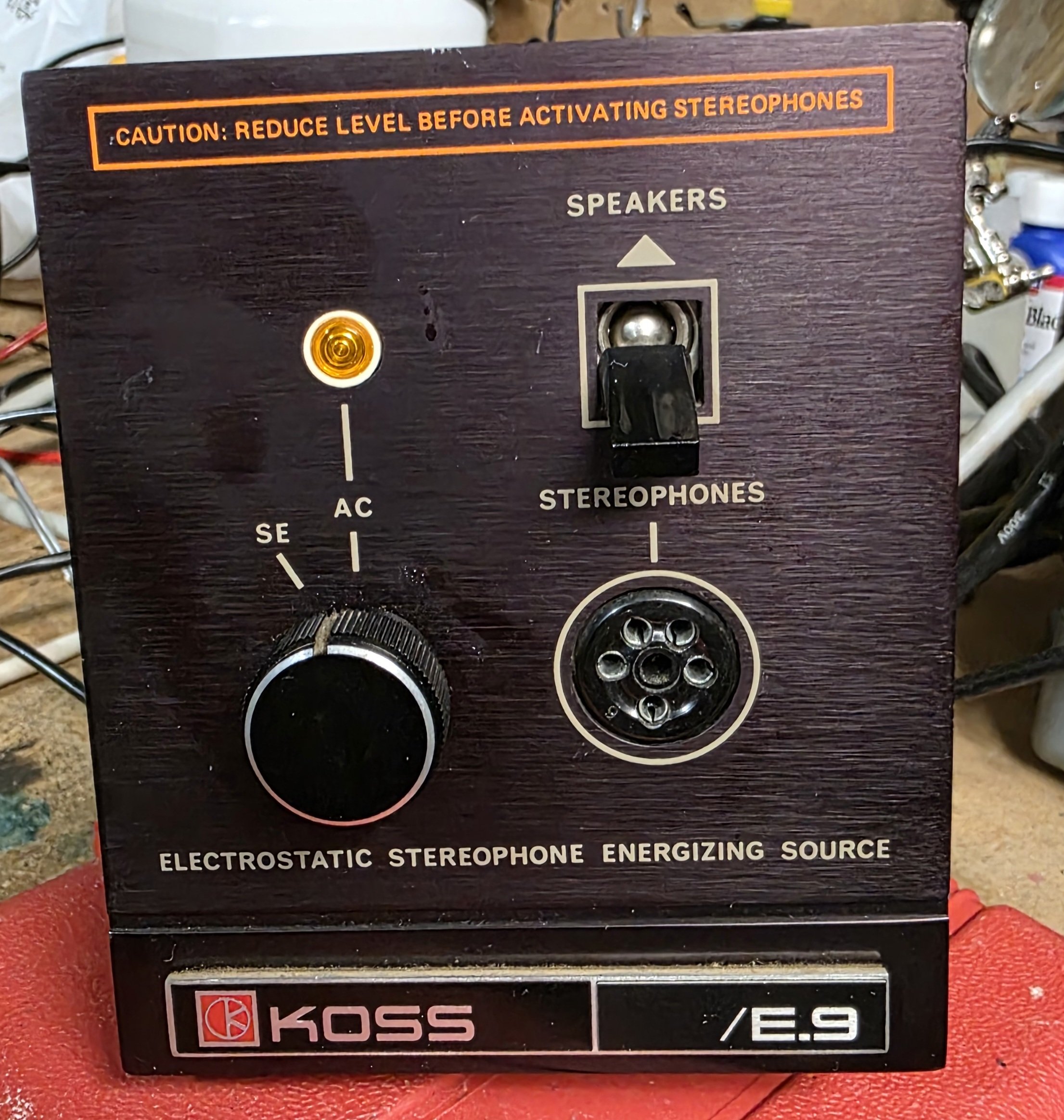

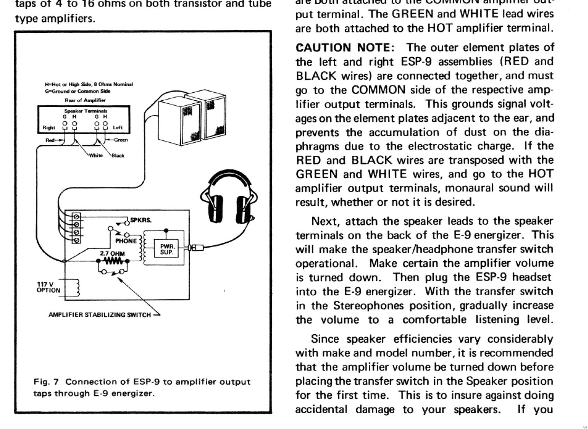

The energizer connects direct to amp. There are outputs for speakers. A switch on front panel selects output. Headphone output has SE and AC choices. SE is self-energizing for the bias supply, or AC energizing through the ac line.

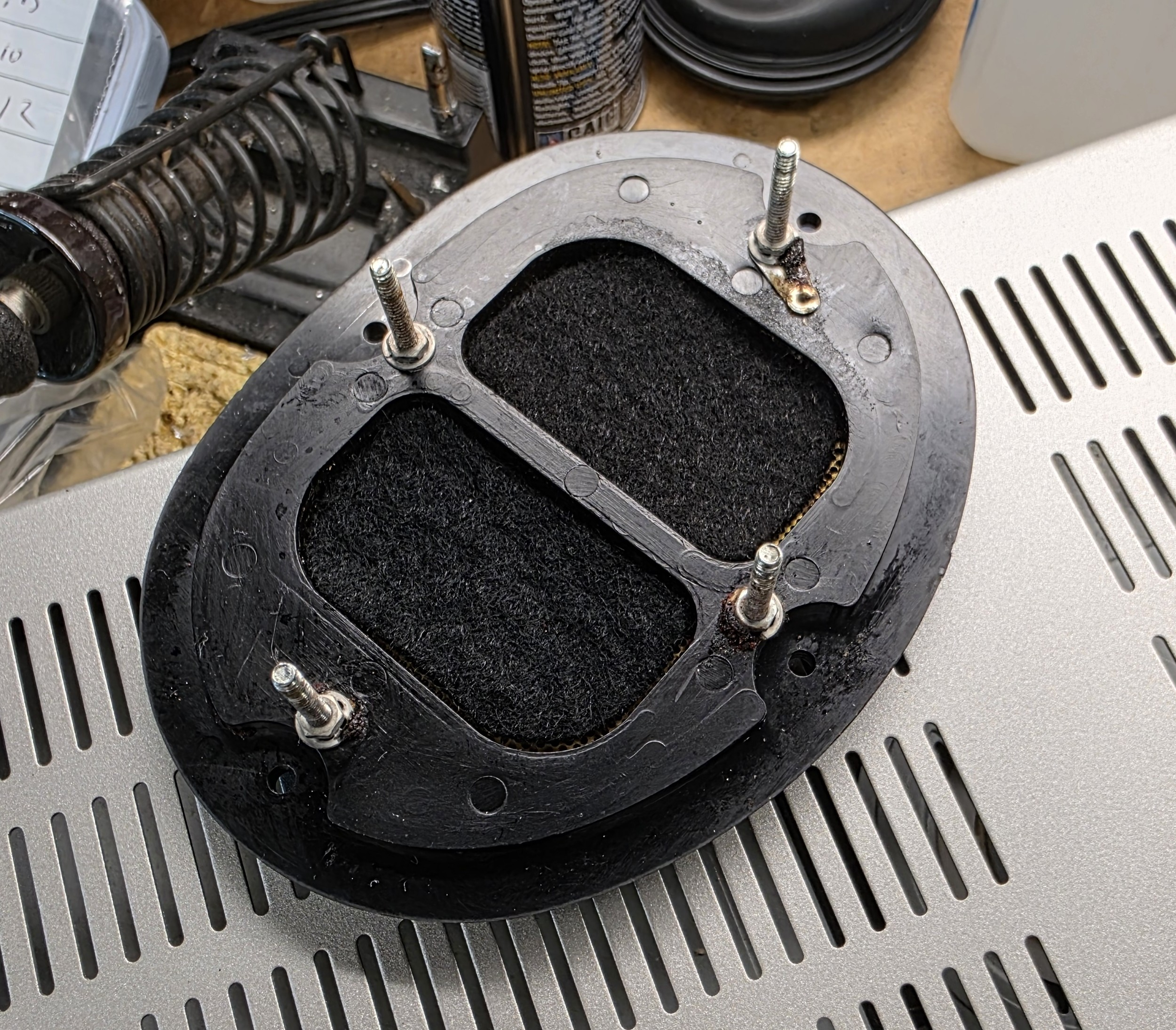

Foam was deteriorated. Fortunately, the traces were good after cleaning, they Ohm'd out OK.

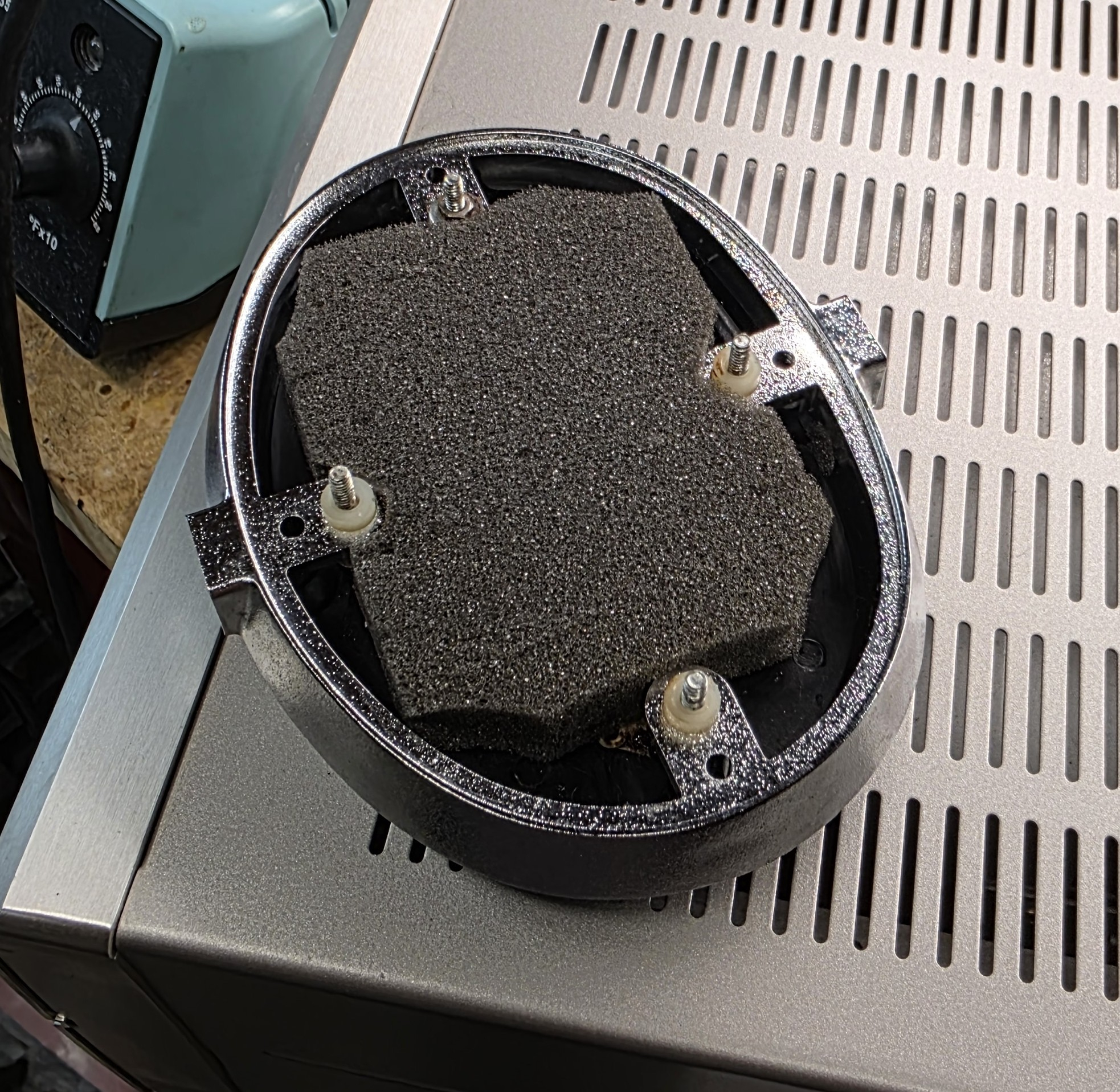

I had some foam here. Not as wide as original but enough to cover the back of the ESL panel. Cleaned up the felt and reinstalled. Still unsure if they will work. I can always go back in.

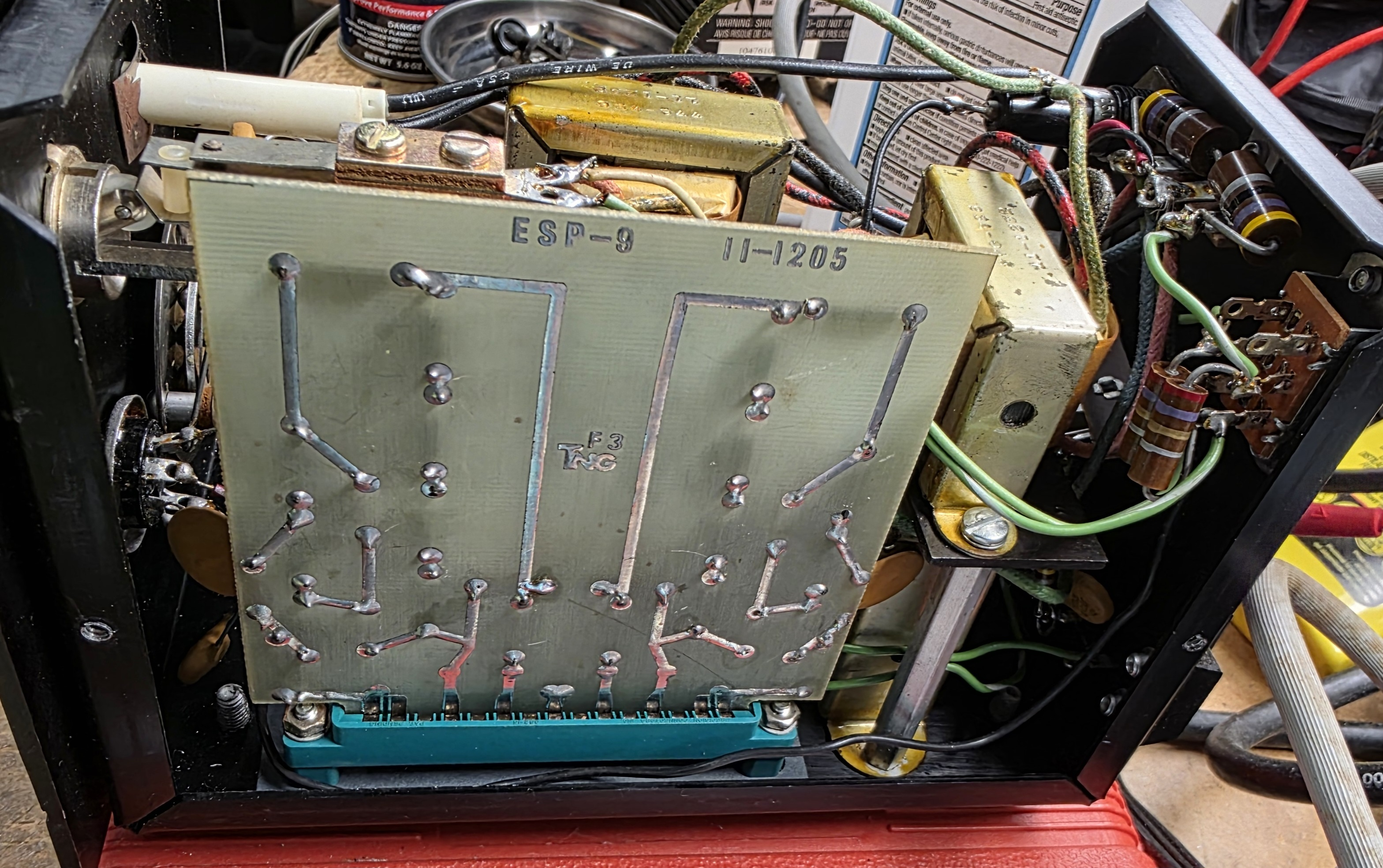

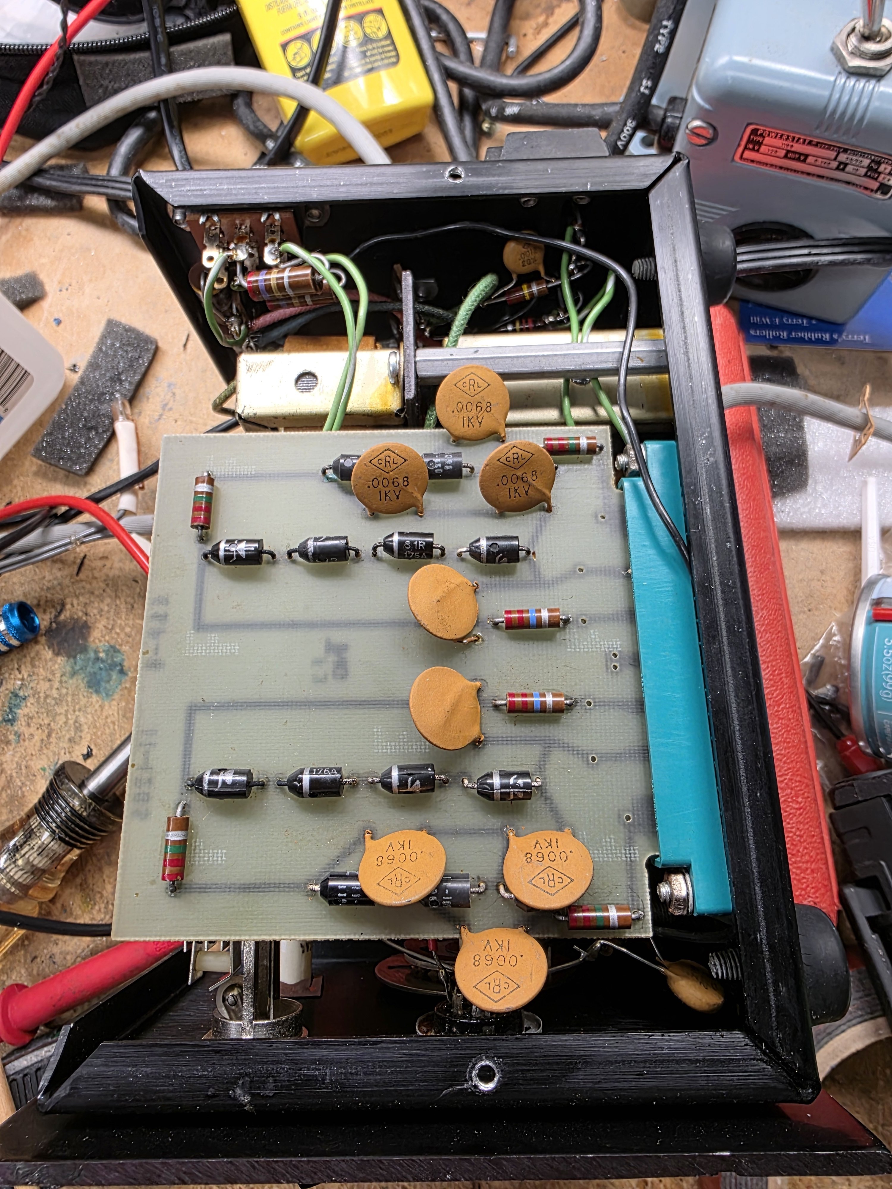

Next up was inspecting inside. Found a wire broken off and noticed a plug in board with some dirty looking connectors.

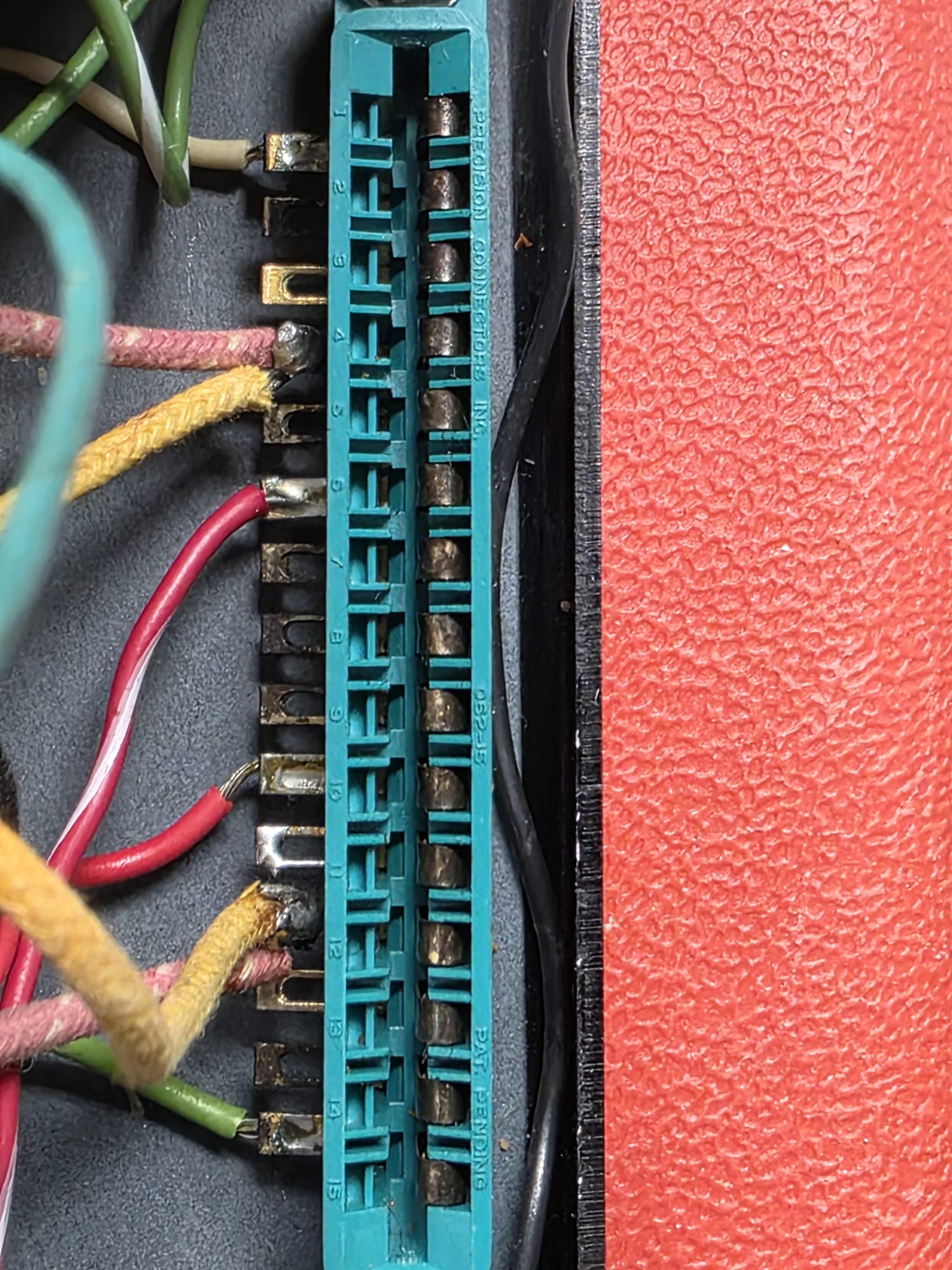

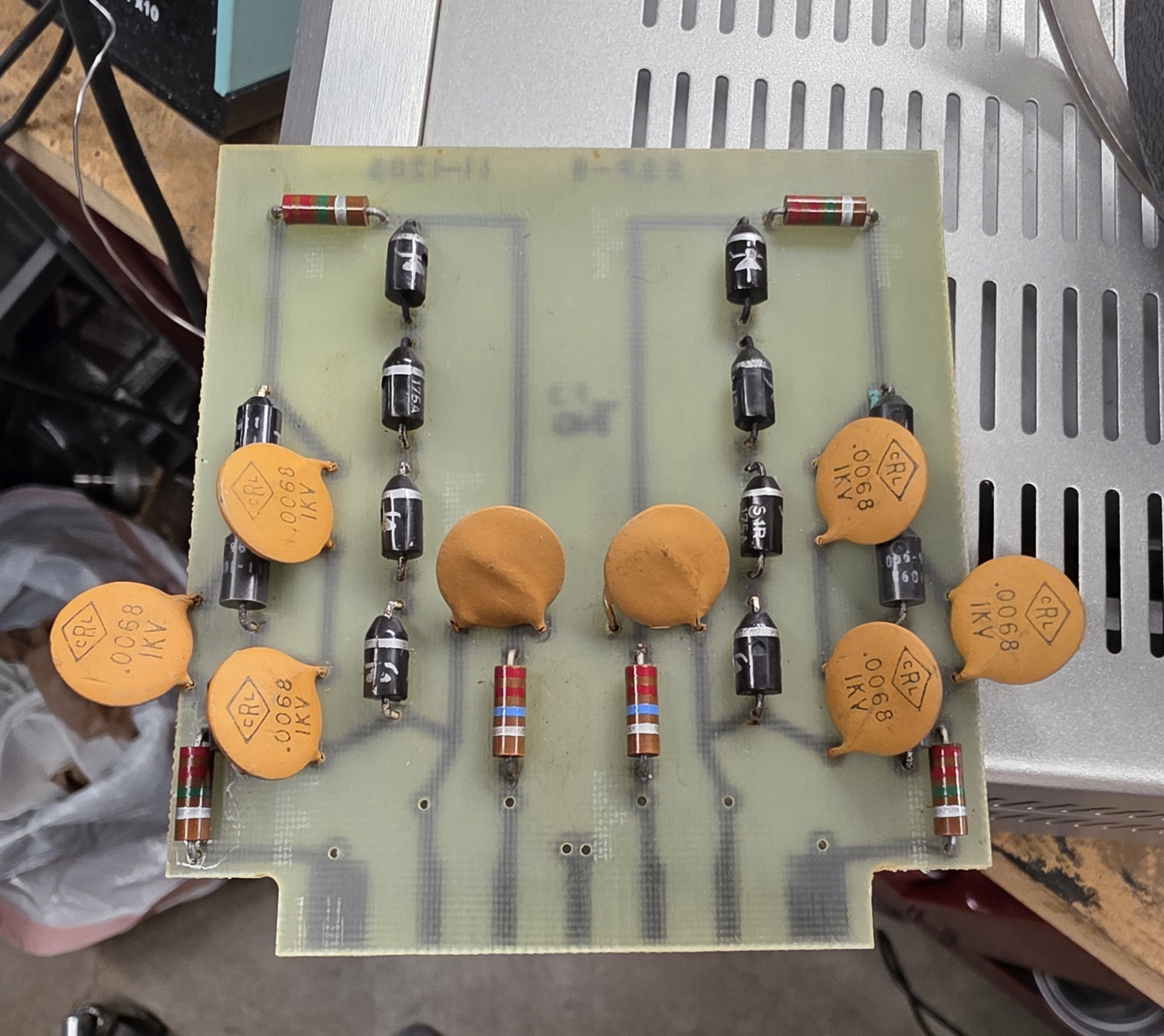

Better, the main thing the board contacts were clean. I need a tiny brass brush to get at the top of contacts. Notice how there are contacts on only the right of connector.

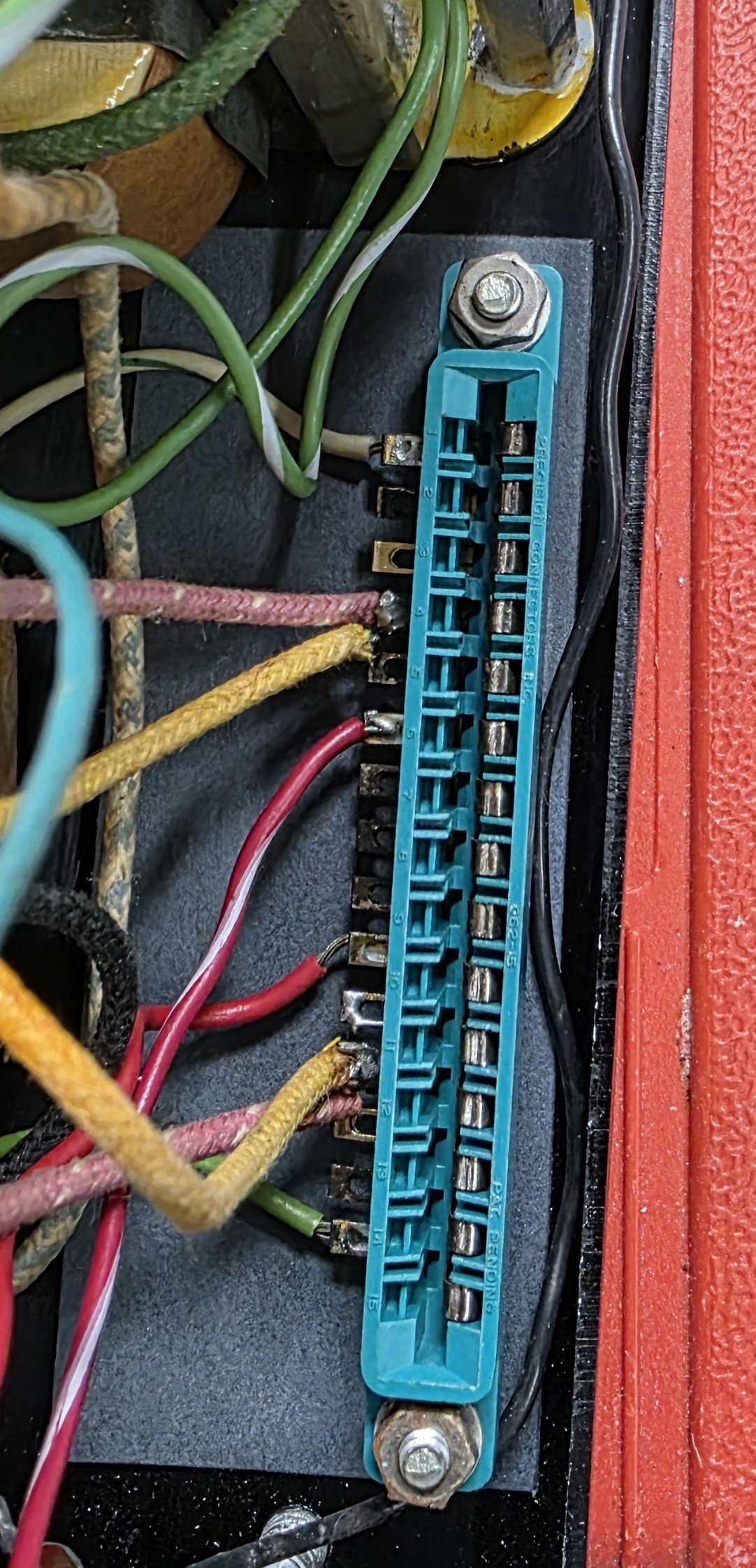

Cleaning the board contacts, I notice they are only on one side. The connector only has contacts on the outer edge.
Yes, the board was in backwards. Connected it up, powered it on and they work. Sounds pretty darn good too. Very surprising, some of the carbon resistors I tested are still in 10% spec.
