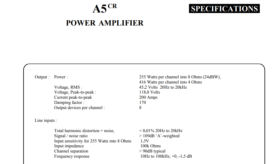

    Musical Fidelity Nu-Vista 800.2.
    Current - 120 amps peak to peak
    'Nuff said
    Musical Fidelity will deliver the current. Specs on my A5cr power amp--Sadly it's sick and needs medical attention. :(
    Jay
  • motorstereo
    ^^^^^^^Wow I guess that A5 will deliver the current! That's the same amount of current as my Mcintosh mc1201's.

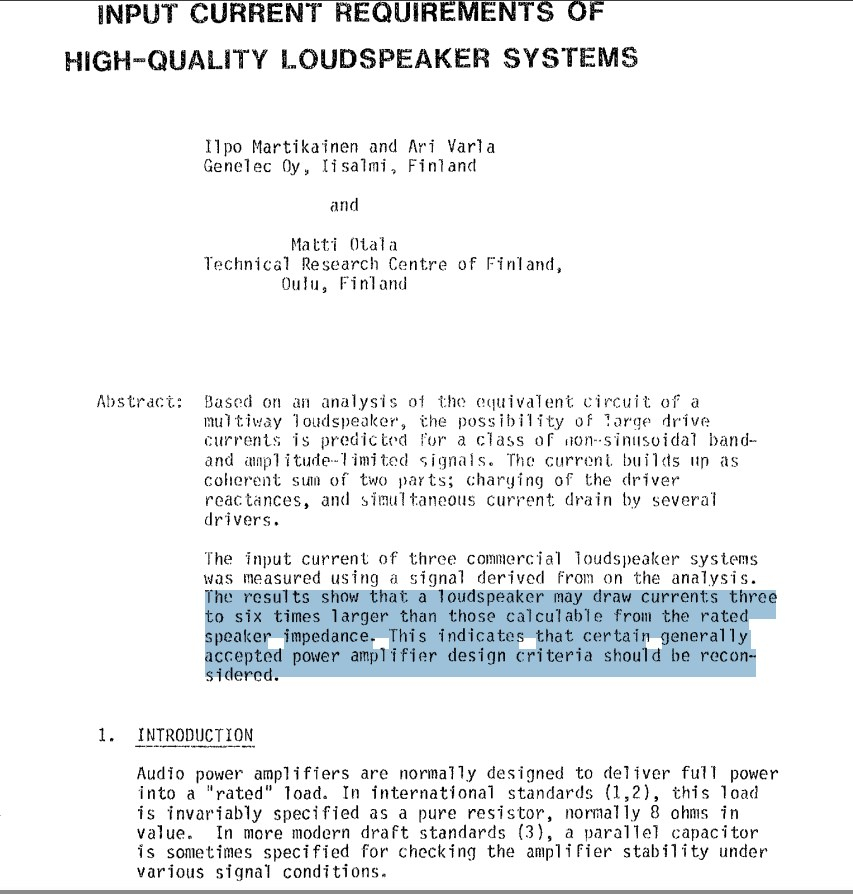

    I assume that peak current would be into the lowest rated impedance of 2 Ohms?
    If so that is about 4.3x the calculated current of 32.6 Amps for 3000W into 2 Ohms with 92 Volts.
    200 Amps / sqrt(2) = 141 Amps RMS. 3000 W / 92 Volts = 32.6 Amps. 141/32.6 = 4.3x.
    Calculated another way from Power = Current ^2 times Impedance, would give Current = sqrt(3000/2) = 38.7 amps. 141/38.7 = 3.6x. Which is right?
    Whichever is correct, that is inline with a paper I found that says that peak current with musical signals can require 3 to 6 times the calculated value from rated voltage and impedance.
    https://assets.ctfassets.net/4zjnzn055a4v/3IoTVSUR2LWt9wA9v5JfyF/ab19bb84e1cfe5c0b95c4b1b901b680b/Input_Current_Requirements_of_High-quality_Loudspeaker_Systems.pdf

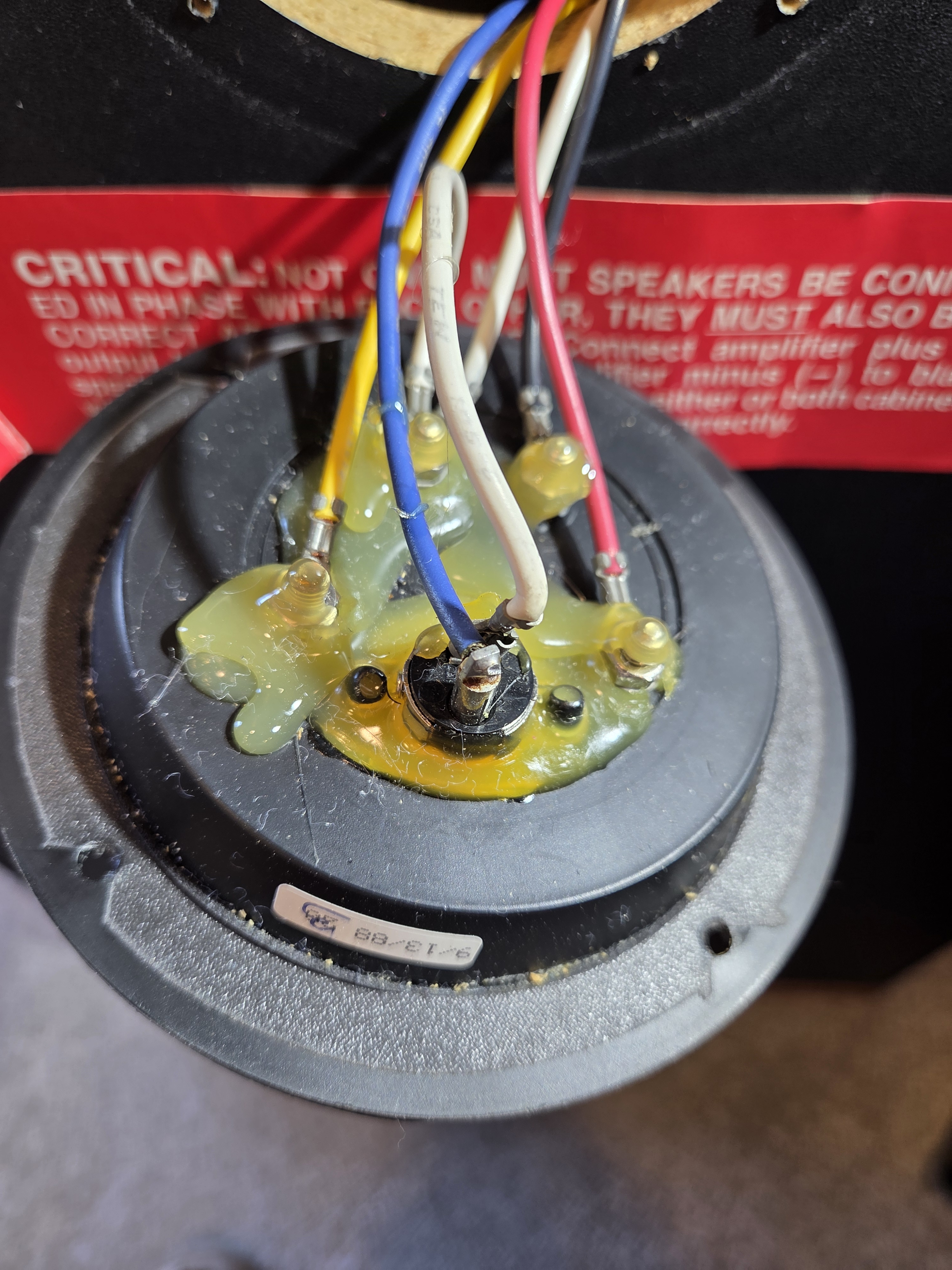

    As a matter of keeping my facts straight that I have shared here with you, with the help of F1nut, he has definitively identified my speakers as sda srs 1.2's. I had originally thought them to be sda srs's. You all have given me so many things to look at that I might never have known had I not come here, so thanks a lot for that.
    It looks like my previous estimated budget may get blown out of the water, although I am going to look at some pre-owned equipment and prices. If there are anymore suggestions regarding power amps or integrated amp that pair well with the sda srs's, I'd be grateful if you let me know. Thanks again for the help!

  • michaeljhsda2
    richdel wrote: »

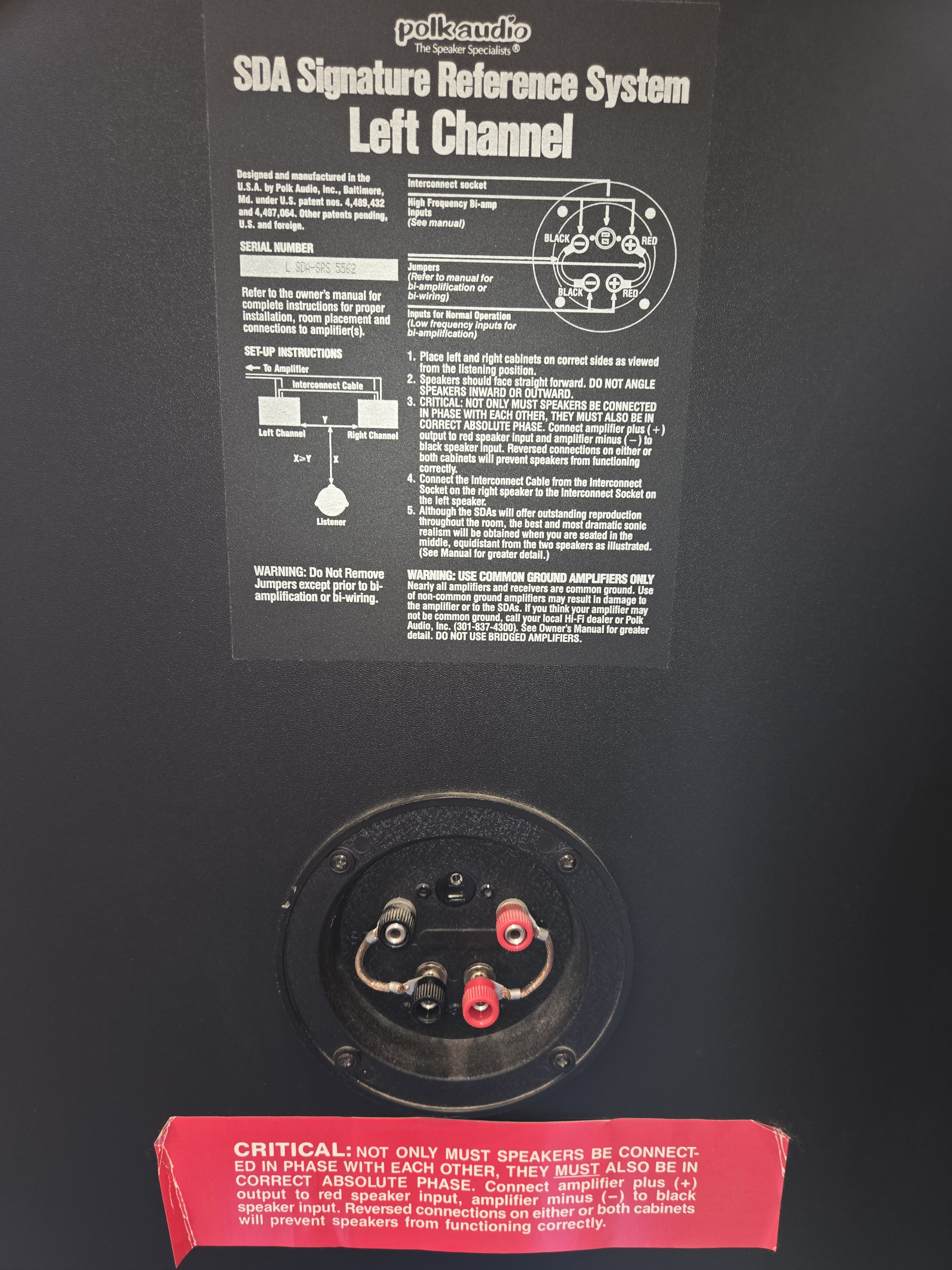

    Since they are confirmed 1.2's the positive (red nuts) should be on the left and negative (black nuts) should be on the right. Chances are the label on the back probably shows positive on the right as that label is a leftover from the 1st gen SRS where positive is on the right. From a previous post regarding this issue.....
    Polk was known to use up old stock during their production on a lot of their speakers, so that is a label that was left over from the 1st generation SRS which has the positive on the right! The SRS 1.2 and SRS 1.2TL models have the positive on the left! Why did Polk make that switch? Who knows but in every instance over the years that I've been on this forum, this issue has been brought up and every 1.2 owner has that wrong sticker on the back of their speakers. As a result, they have been unwittingly listening to their speakers out of phase! Not sure if Polk ever knew about this error, but if they did it would have been nice for Polk to notify the dealers and send out a sticker to put over the wrong one and switch the plastic positive and negative nuts to the correct location...
    Here's a link to the thread.
    https://forum.polkaudio.com/discussion/201029/sda-srs-1-2-reversed-polarity/p1
    SDA SRS 2.3TL's
    SDA 2B TL's
    F1nut Posts: 52,237
    Excellent point and I can confirm the OP has the red posts on the right.

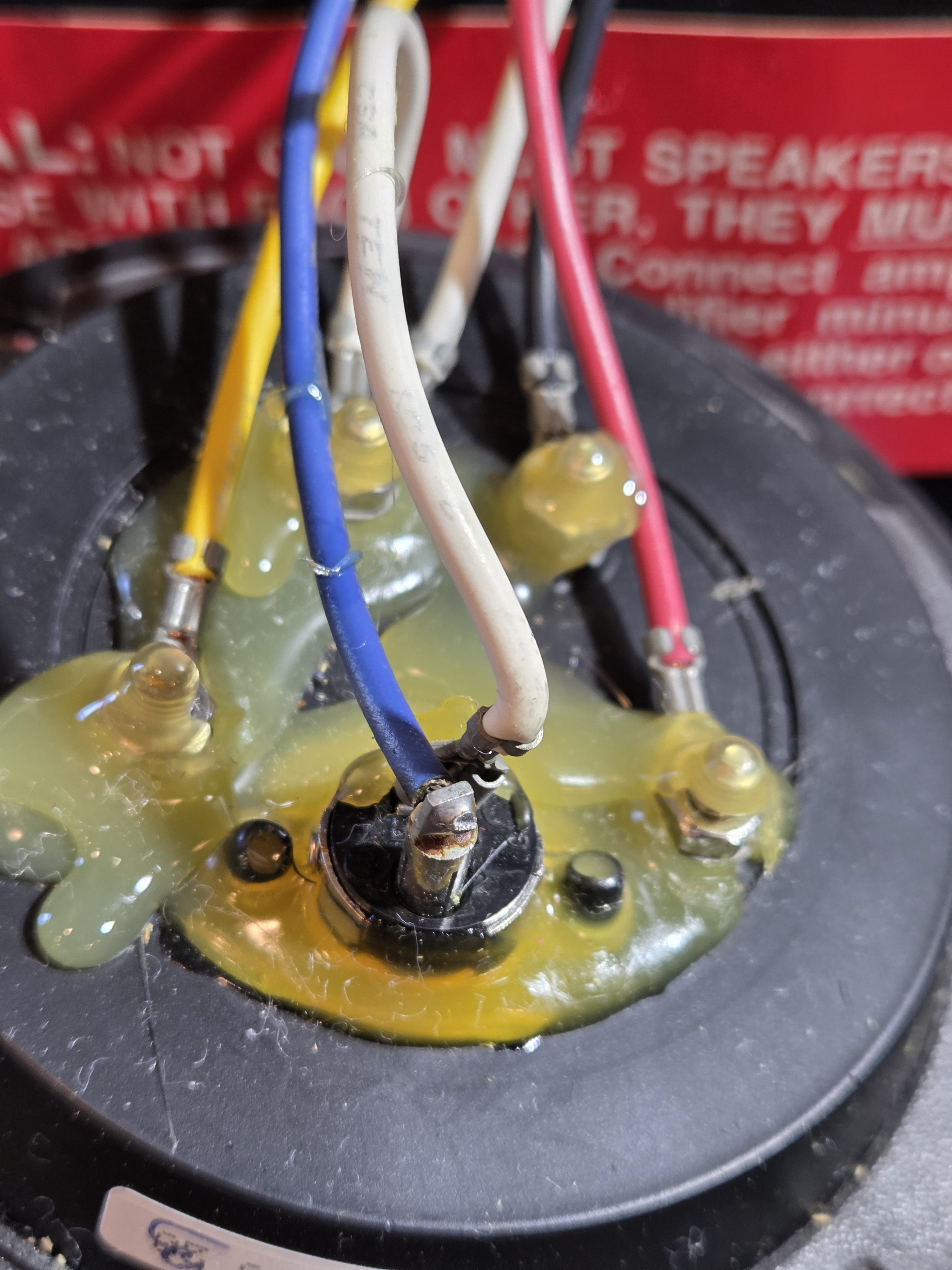

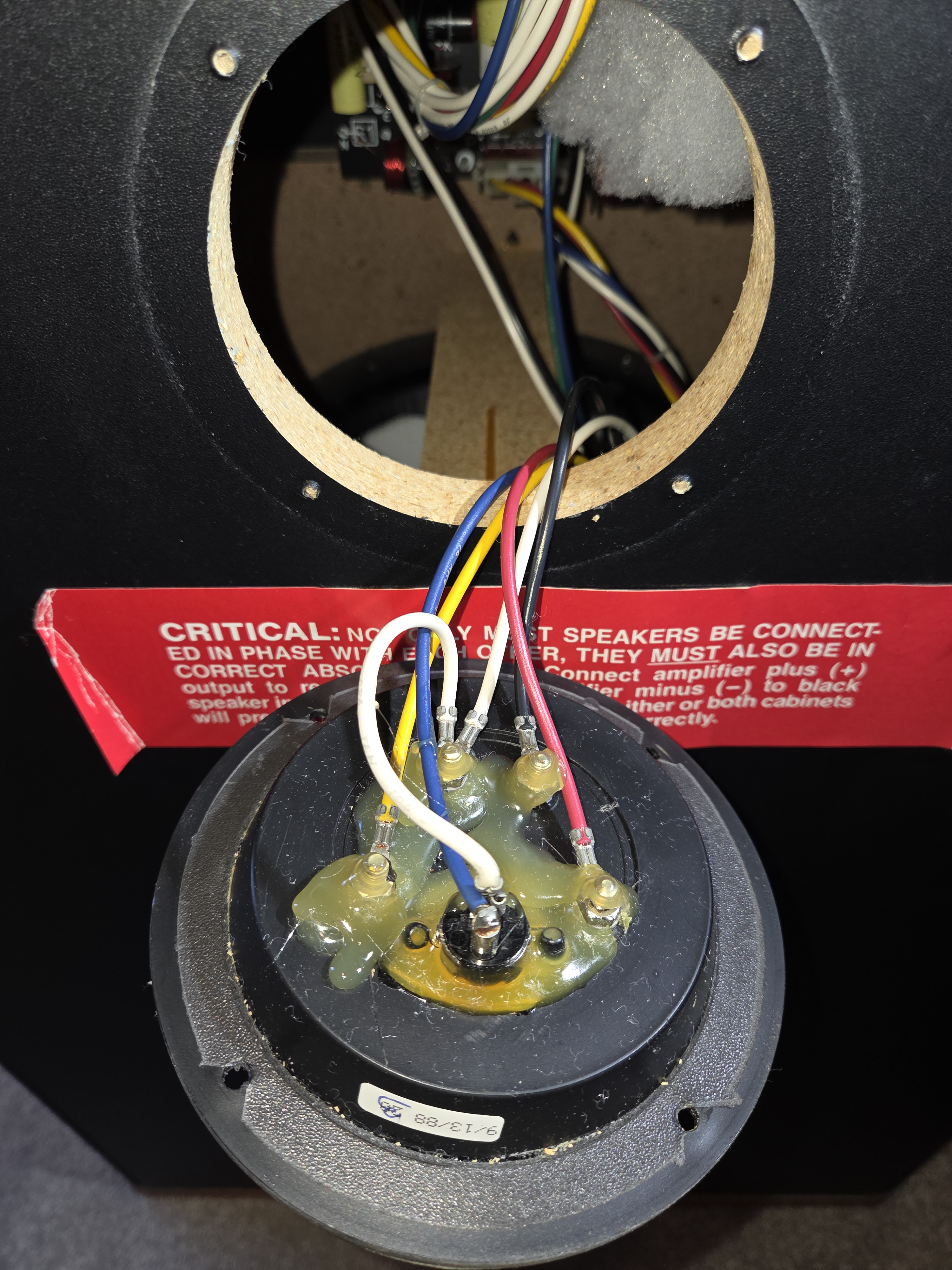

    Rich, remove the binding post plate (4 screws) to observe what color wires are connected to the red posts, report back please.
  • richdel
    Thanks again for all the insight. Like you stated red was on the right, and black was on the left. Here are the pictures I took after removing the bindings plate.
  • michaeljhsda2
    Everything is wired correctly so no need to change anything.

  • richdel
    Sorry, but I do need to test for my own understanding.
    Fact, my speakers are SDA SRS 1.2 and are NOT SDA SRS's, correct?
    Fact, the sticker on the back of my speaker misrepresents how the wiring should be done, but the wiring inside of the plate shows the wiring was changed to what it should have been, correct?
    Fact, as they are now SDA SRS 1.2 speakers that ae wired correctly, if I purchase a "dreadnought" or appropriate interconnect cable, I should be able to run monoblock amplifiers without damaging my speakers or amplifier, correct?
    Sorry if I seem thick, but the last few days I have been saddled with a bad cold that I have been trying to mitigate the symptons with cold medicine that has made my line of thinking cloudy and at times not logical.
    pitdogg2 Posts: 27,677
    edited September 2025
    Fact, as they are now SDA SRS 1.2 speakers that are wired correctly, if I purchase a "dreadnought" or appropriate interconnect cable, I should be able to run monoblock amplifiers without damaging my speakers or amplifier, correct?
    YES ! You should build a dreadnought whether or not you decide to use a non-common ground or monobloc. The dreadnought works on common ground stuff too, mo'better.
    Polk was very well known to use old stickers on speakers when they moved on to new models, they were "thrifty" in that way.

    ^^^this^^^ and get well soon. No doubt about it you have 1.2's because Polk never made a first generation SRS with a pin blade interconnect socket. You have the only pair that I have seen where Polk wired them correctly from the factory even though the label is a blade blade sticker for the first generation SRS.
