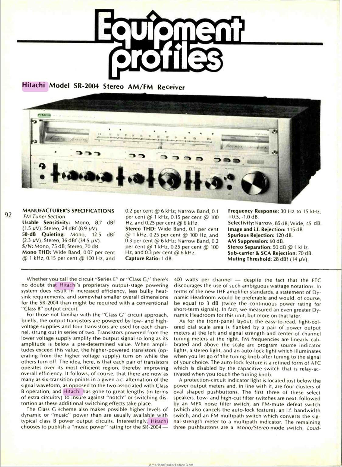

    mhardy6647 Posts: 35,373
    edited August 2025
    Class G uses a dual rail topology. It's been around since at least the mid 1970s.
    It is pretty simple and comparatively low-tech. Not really any more efficient than Class AB, other than the ability to transiently double output power by switching to the higher DC rail voltage(s).
    EDIT: OK, Audio magazine said it's quite efficient!
    Finally, there is a Class G amplifier
    from Hitachi which is designed to op-
    erate more efficiently over more of
    the operating range. It boasts an effi-
    ciency of 90 per cent or better. In-
    stead of using two transistors, as is the
    case with Class B and D amplifiers, the
    Class G uses four. The smaller pair has
    relatively low power dissipation and
    output, but whenever a higher ampli-
    tude signal comes along, a sensing
    diode switches on the larger pair of
    transistors. Consequently, each pair of
    transistors operates in close to its most
    efficient operating area, and the over-
    all circuit can be smaller and lighter.
    source: https://www.worldradiohistory.com/Archive-All-Audio/Archive-Audio/70s/Audio-1977-09.pdf#search="class g"
    Viking64 Posts: 7,701
    We had a dual rail Hitachi back in the 70s. B)
