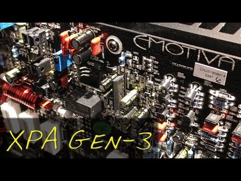

    Check out this video starting around the 10 minute mark to see the innards of the Emotiva XPA Gen 3 amp. Class H switching to class A/B. Big case with not much to look at inside. Fits well for home theater but it is what it is.
    https://www.youtube.com/watch?v=4TMgAW5yt_8
