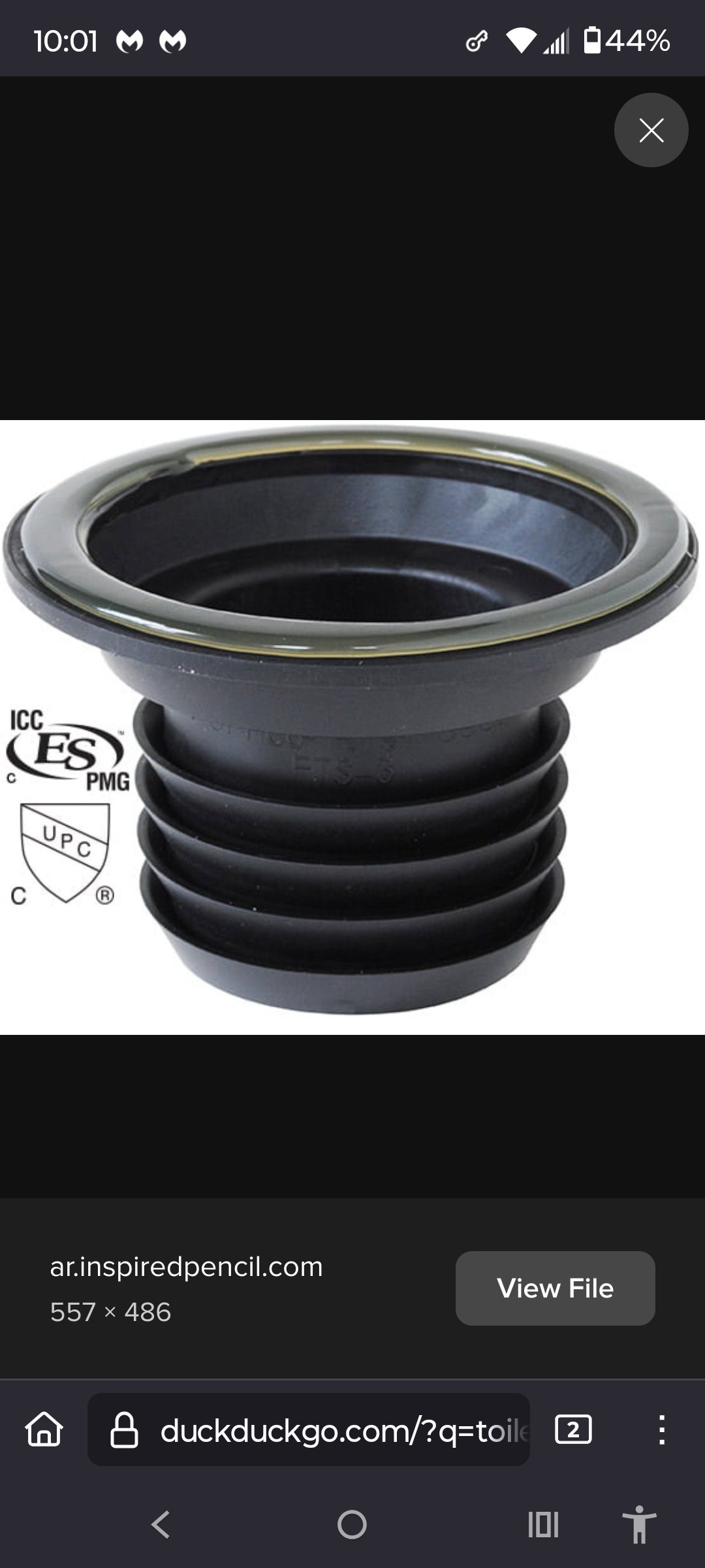

    Buy a kohler toilet with one of the aquapistons. I've had two over 15 years and only had to mess with it once. It had a bit of mineral debris that I simple wiped off with a rag.
    Internet picture for reference, not my toilet, never paid that much.
    The newer design is yellow and a harder compound. The older design was red and a bit softer. They have never curled in my use. Bullet proof!

    I dealt with curled flappers and leaky flappers got sick of it. I understand your frustration. I heard of these did some research and I haven't looked back. I won't buy any other brand of toilet. I've also quit using wax rings.
    My high school buddy who has been a plumber for over 40yrs and owns his own business turned me on to the Kohler and this boot. If you've ever seen those mouse glue traps then you understand how sticky and practically impossible it is to get off. On a brand new toilet you put one of these boots on and you stick this down into the toilet flange you can pull it a couple of times if you need to it's never going to come off the toilet. It's also never going to wear out and leak that you won't find out until after it's rotted your wood subfloor.
    I've actually put one on an older toilet that used to wax ring but you really got to clean the China off really well and I think I used something really harsh to remove all wax residue. It may have been acetone. They come in 3" and 4" so you need to know sewer pipe diameter. I've always sprayed a lite coating of WD40 on the outside of the boot so it slides right in easily or you could spray the inside of the pipe/PVC.

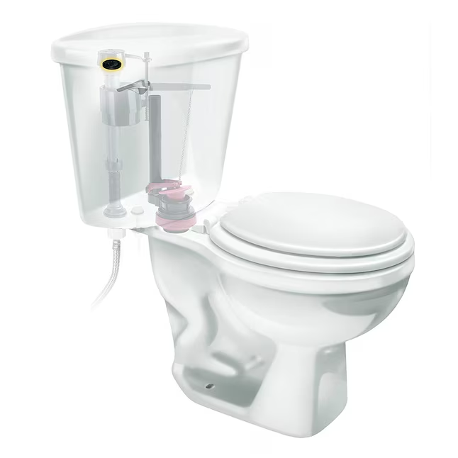

    Do you have a float ball at the end of a rod or a fluidmaster style filler/float?
    I worked for a plumber for 7 years. Fluidmaster replacement fill valves was a MAJOR money-maker for his business. He kept 5+ spares in every truck. They're the BEST!!! He also kept those black washer/seals by the ton. He'd just replace the seal if the toilet if it already had a Fluidmaster fill valve.
    You know the FluidMasters are adjustable, right?
    You should be able to adjust the float to make it shut the "fill flow" off sooner.
    Or is it the needle pin crusting up?
    Fluid master valves also have replaceable seals/washers in them. They're very inexpensive when you buy a contractor's pack of 12, I think it is. Or...just buy one. :D

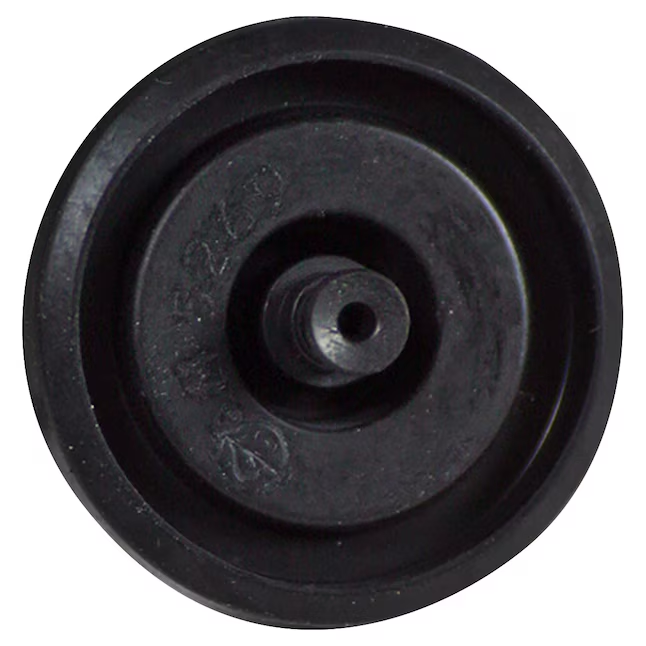

    Sounds like that rubber washer seat thingy needs replacing.
    Buy one, pop that blue or black cap off, replace the seal, then snap the cap back on.
    Hope that does it.
    2.00 repair. ;)
