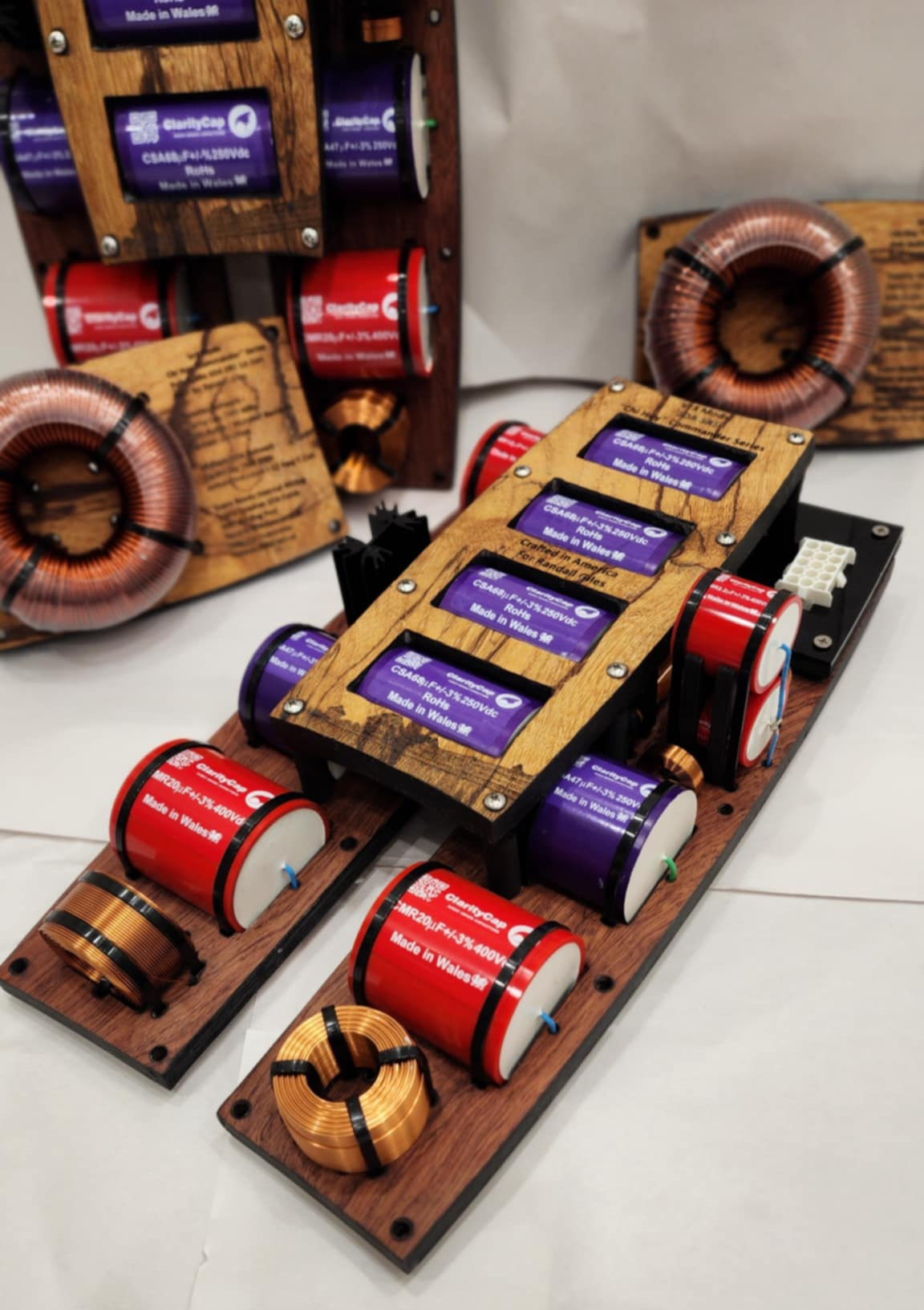

About to unleash the next sda srs beast
VR3
VR3 Posts: 29,731
I tease you with this cheesy AI image
    VR3 Posts: 29,731

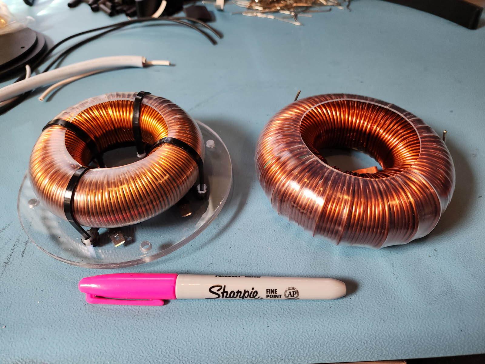

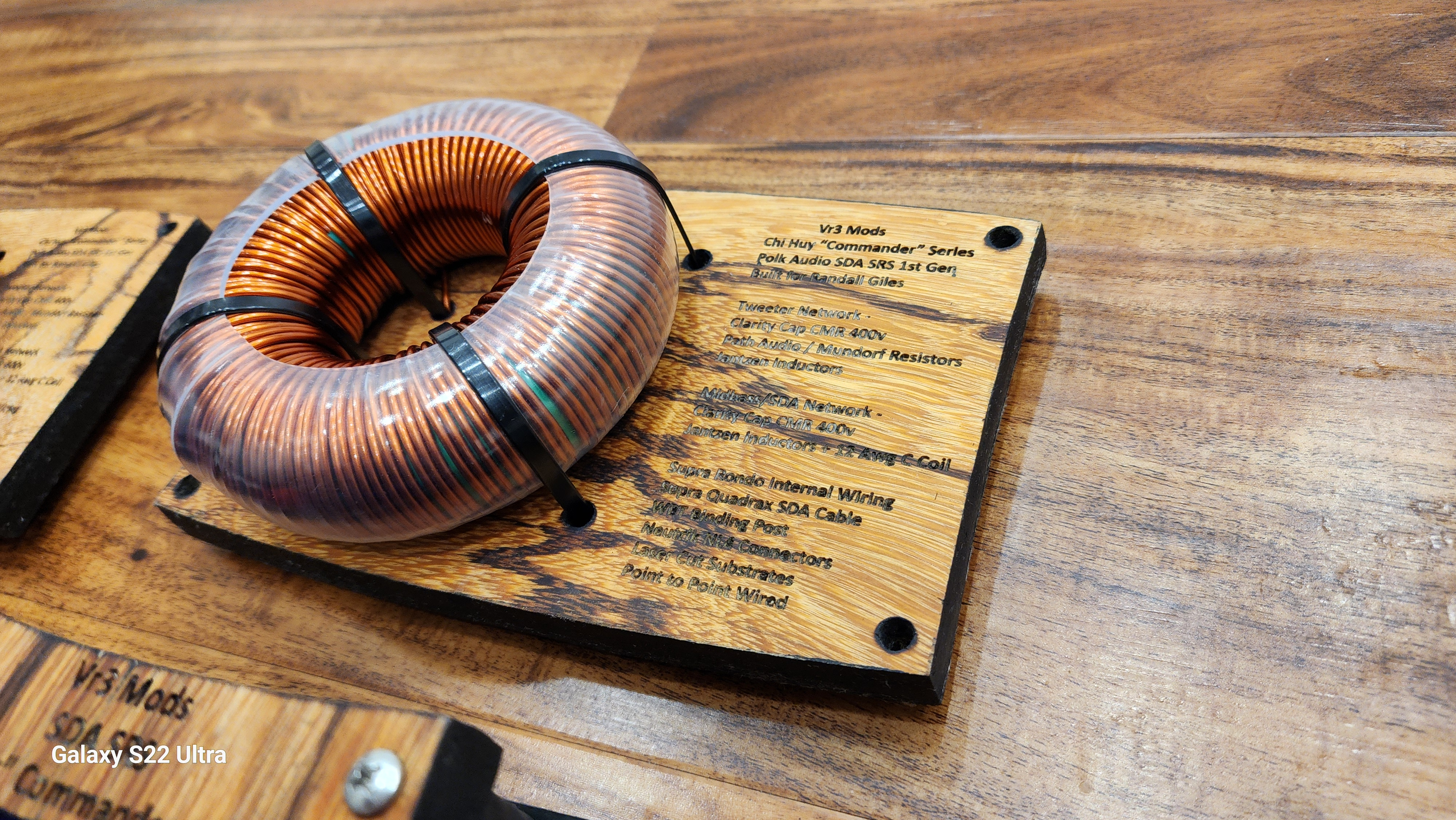

    The standard c coil versus the biggest they can fit in the machine
    pitdogg2 Posts: 27,881
    You using the big one on SDA's?
    VR3 Posts: 29,731
    Yes, I've actually used it a couple other times but it's quite a bit more than the standard.
    I used it on the big duelund build a while back, worked very very well
    VR3 wrote: »
    It meets all the parameters? What does it drop the ohms to?
    VR3 Posts: 29,731
    edited June 2025
    There's honestly not much difference, the dcr rating of the standard c coil is so low already, it's just a little bit lower.
    Similar, I can't recall what the set Sean's read at but I had no issues driving them with a tri Vista integrated to very high levels cleanly with insane bass.
    Polks directive on the sda inductor was the lower the dcr the better performance but harder to drive.
    My 2.3tl's run about 2.5ohm at the post, crazy good with the Aragon..
    VR3 Posts: 29,731
    Yeah the number 2.8 comes to mind

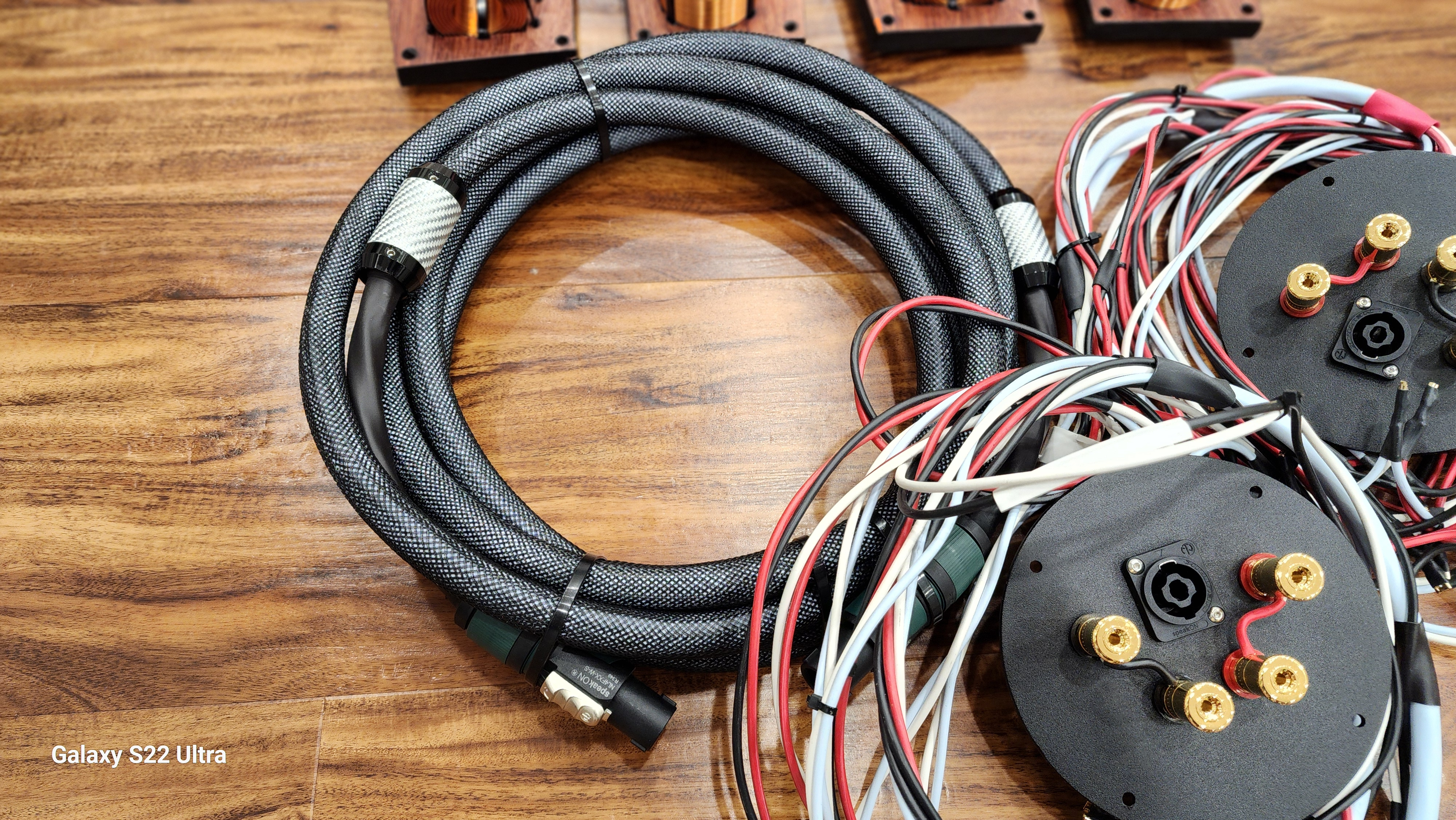

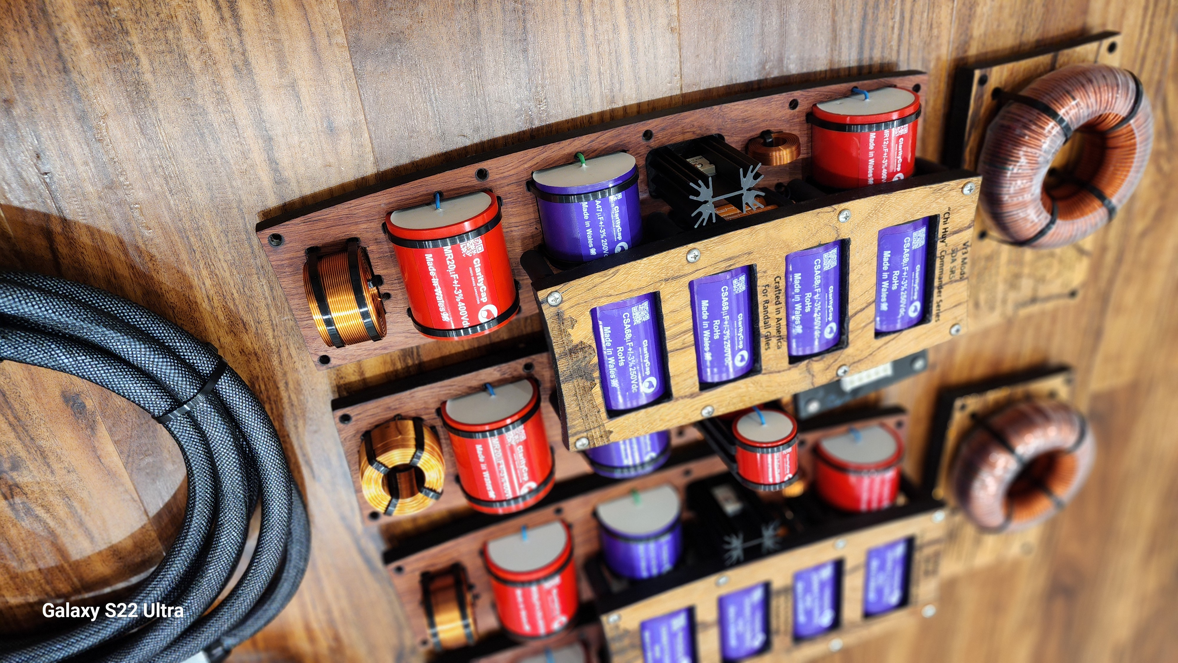

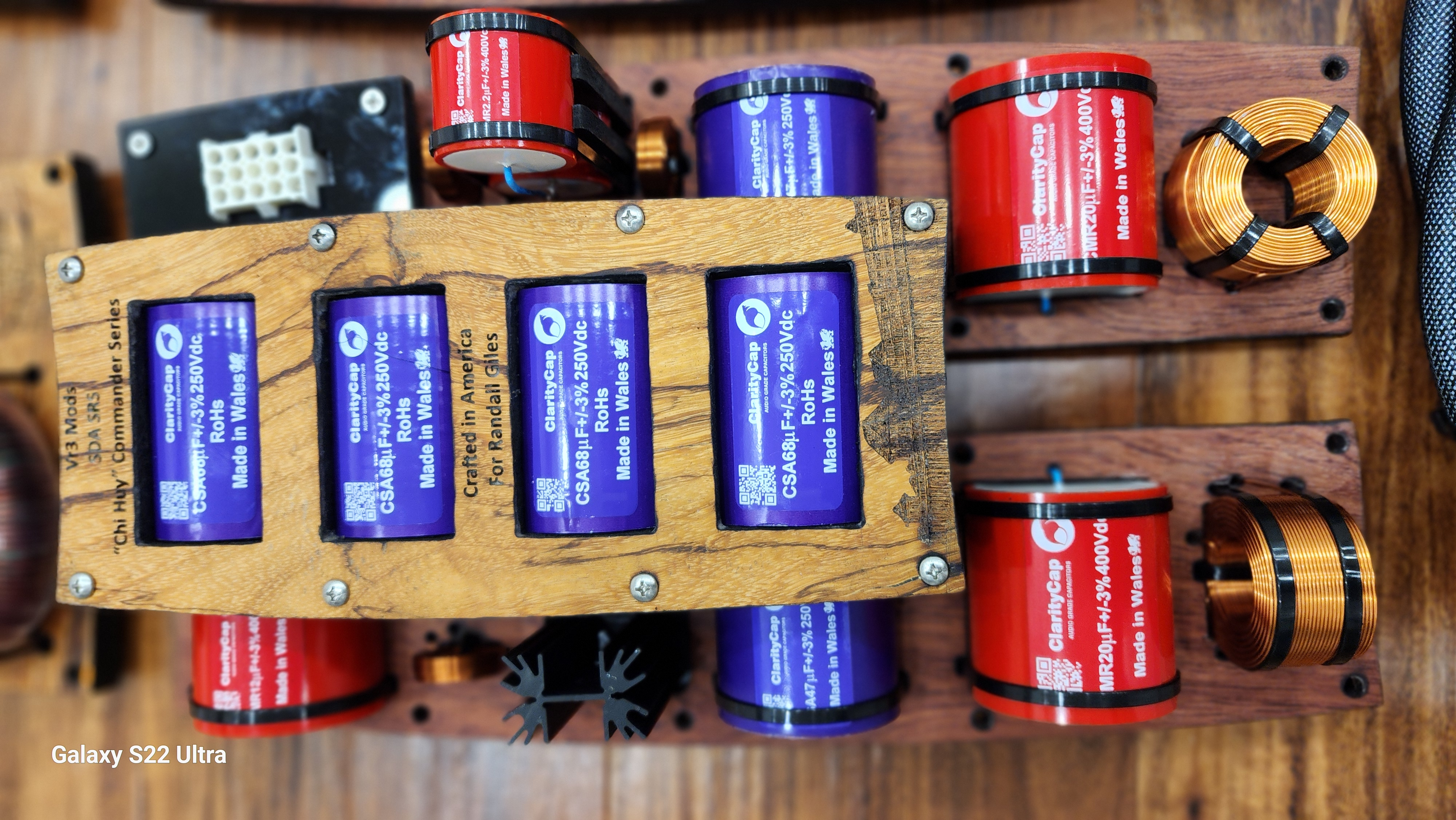

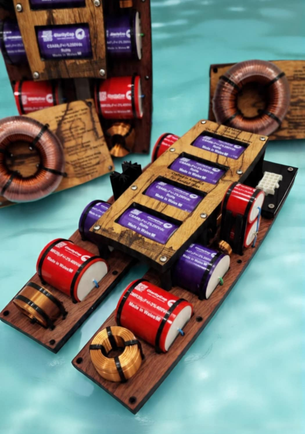

    VR3 Posts: 29,731

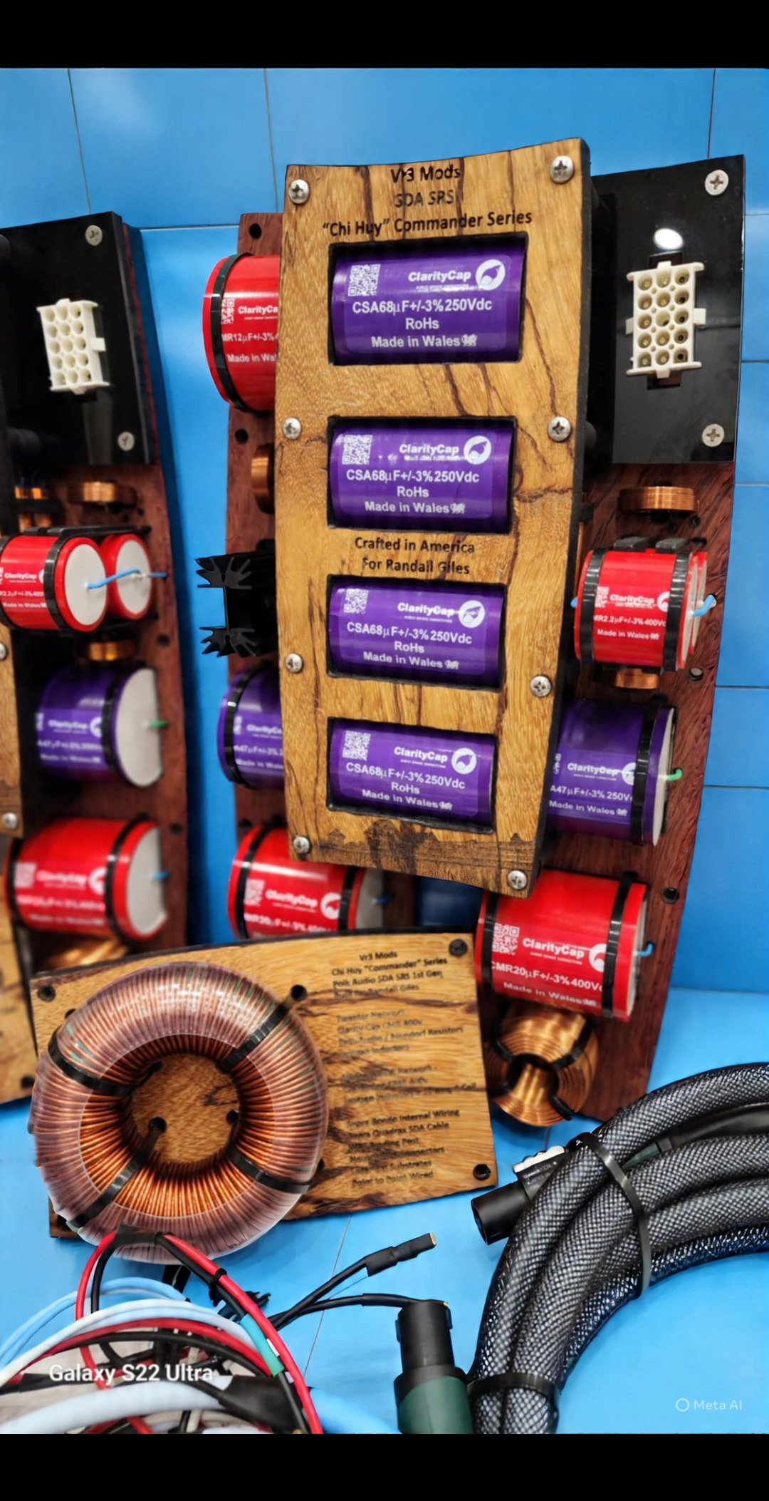

    Just finished wiring one up!
    Another teaser for fun 😍

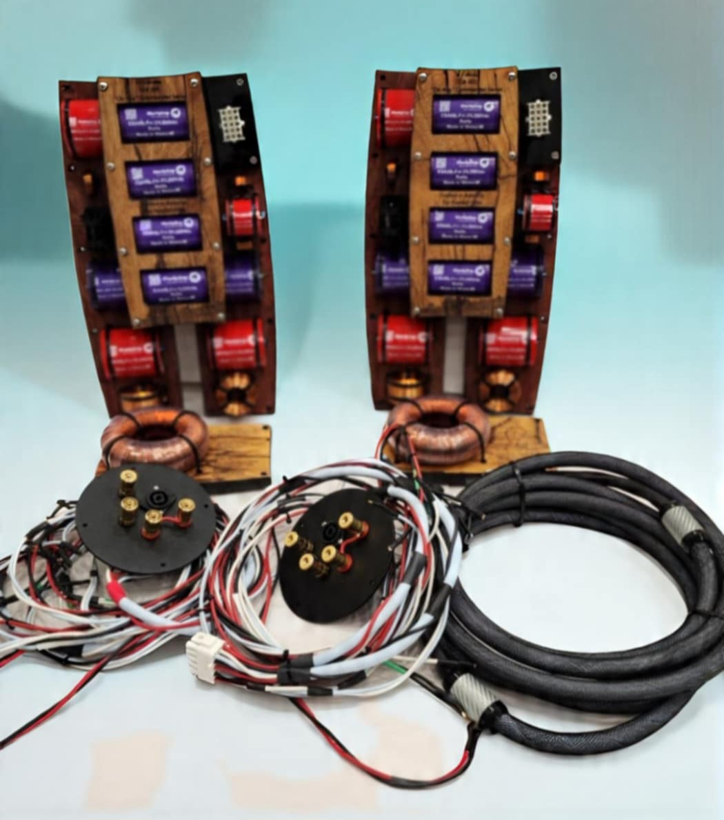

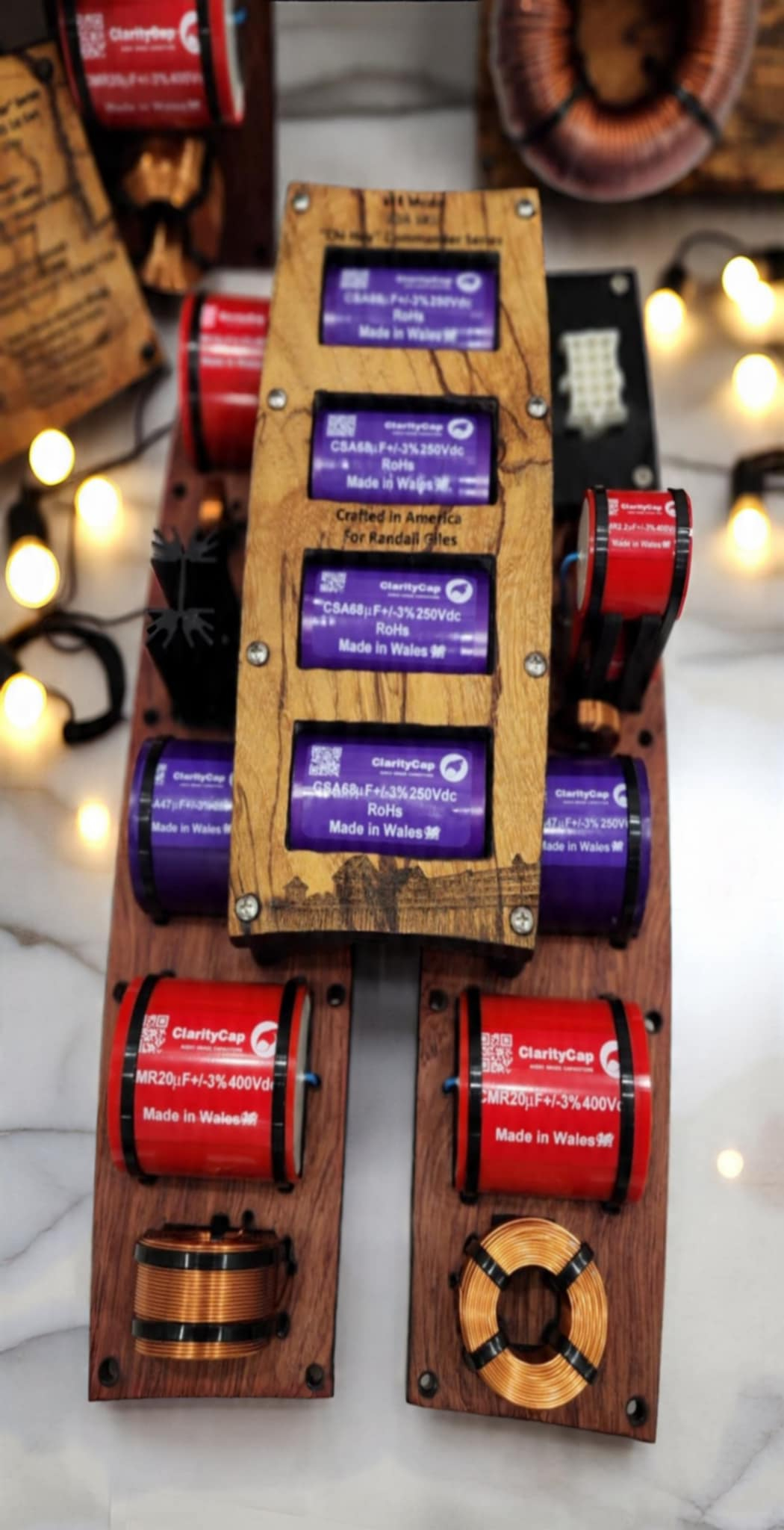

    VR3 Posts: 29,731
    Ok ok one more

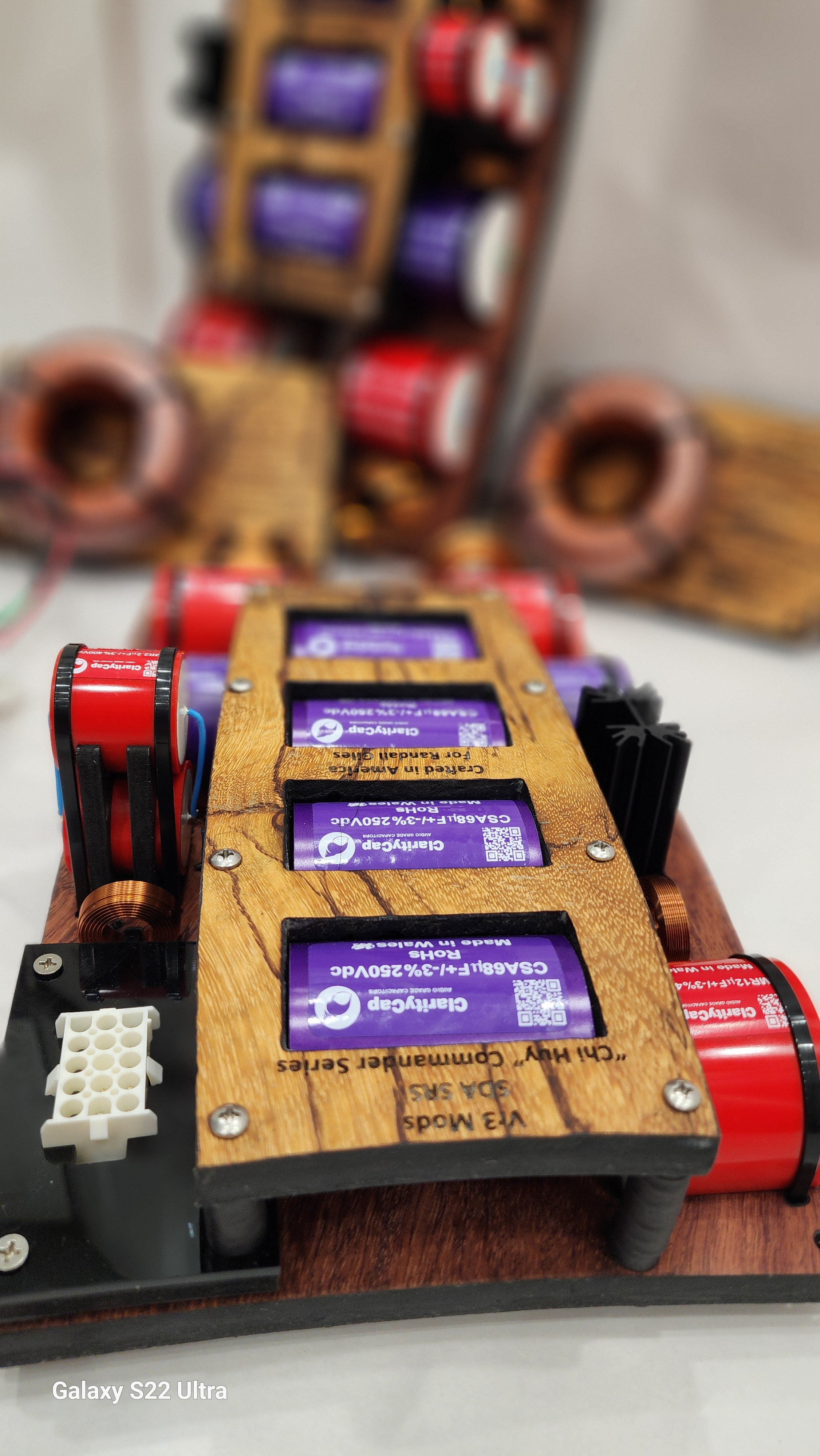

  • drop1
    drop1 Posts: 90
    Never seen a heatsink on an SDA XO. Cool B)

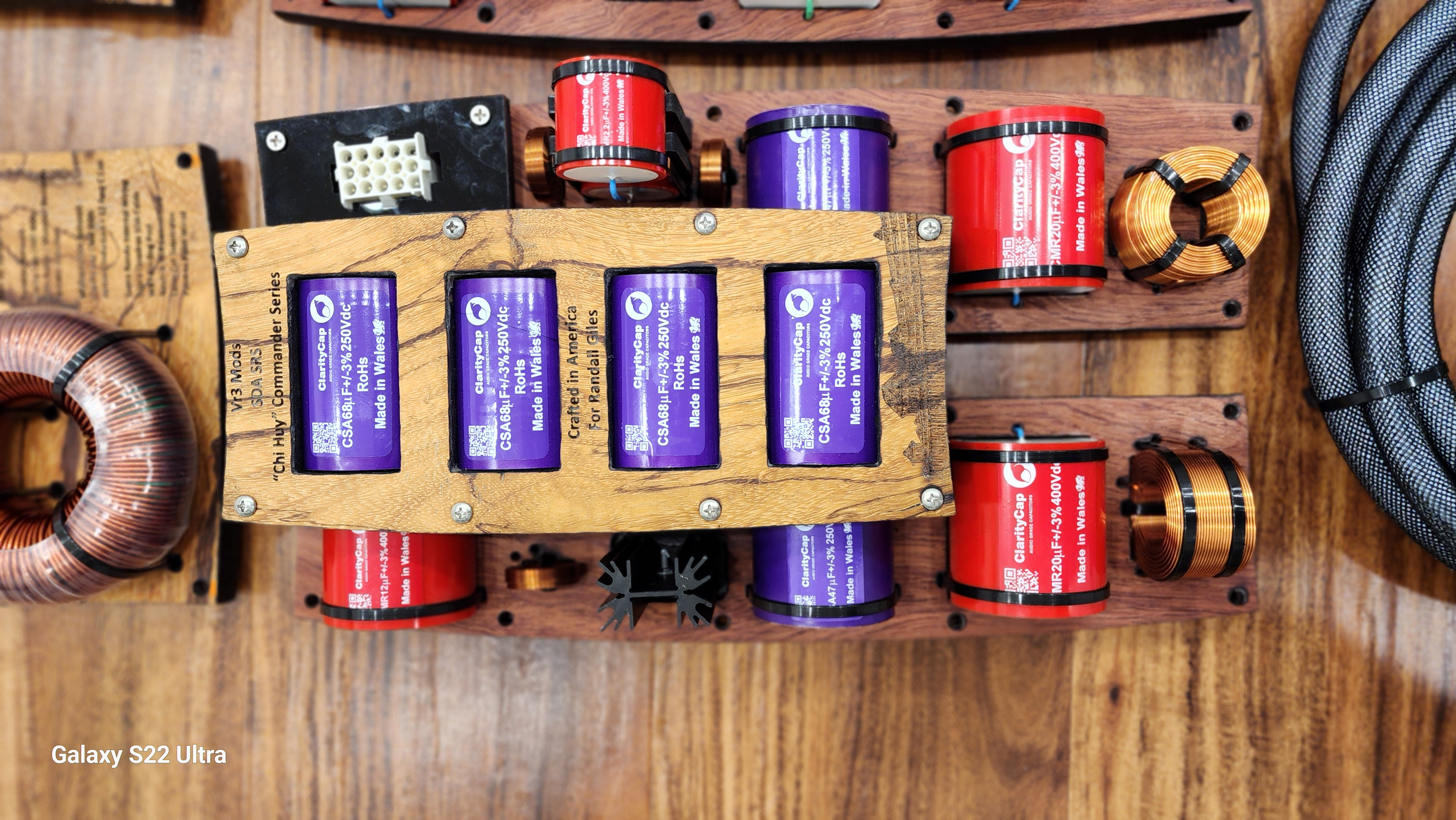

    Mundorf resister needs a heat sink.

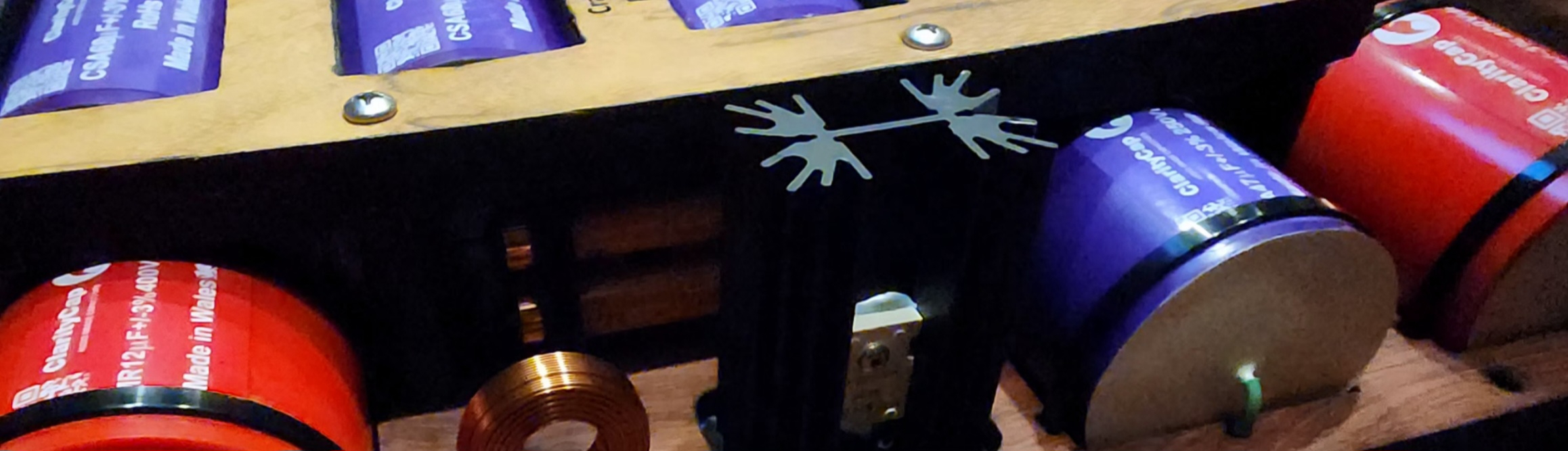

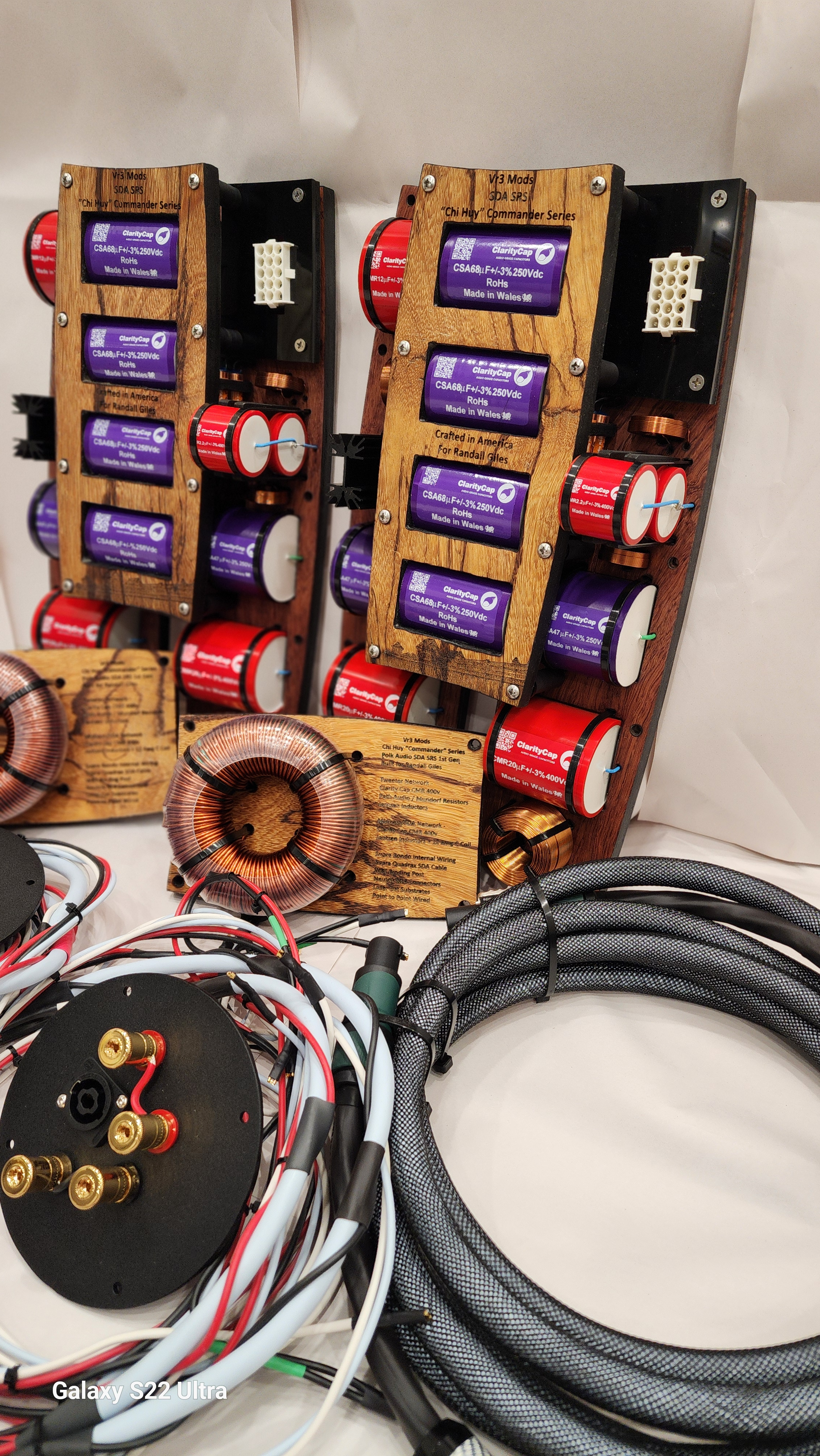

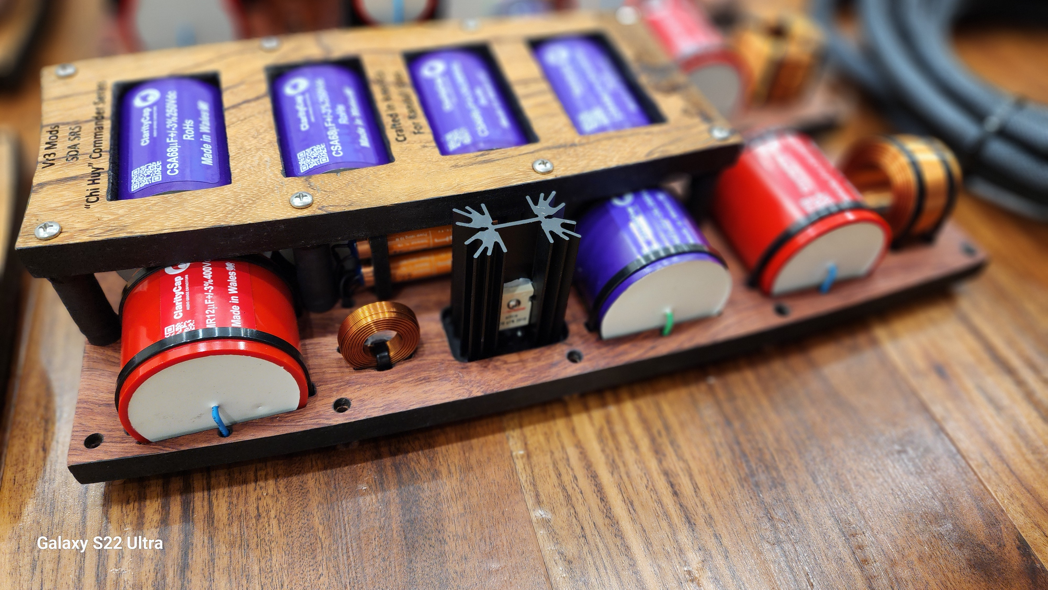

    VR3 Posts: 29,731
    edited July 2025
    I've installed path audio resistors to a heat sink and there are definitely performance gains, especially if you listen at louder volumes.
    I've found alot of benefits of using heat sink based resistors in parallel circuits as they tend to run alot hotter than series resistors.
    Most resistors will increase in value as they become hot. If you are ever listening and feel like your sound seems more dampened than the beginning that could be the cause

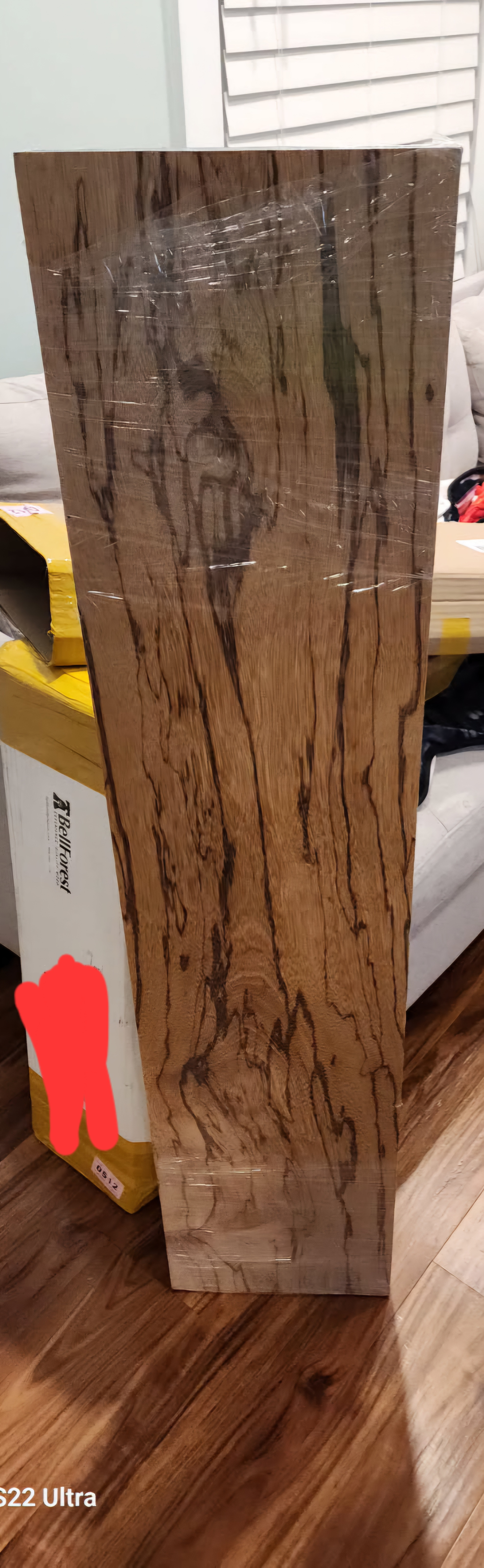

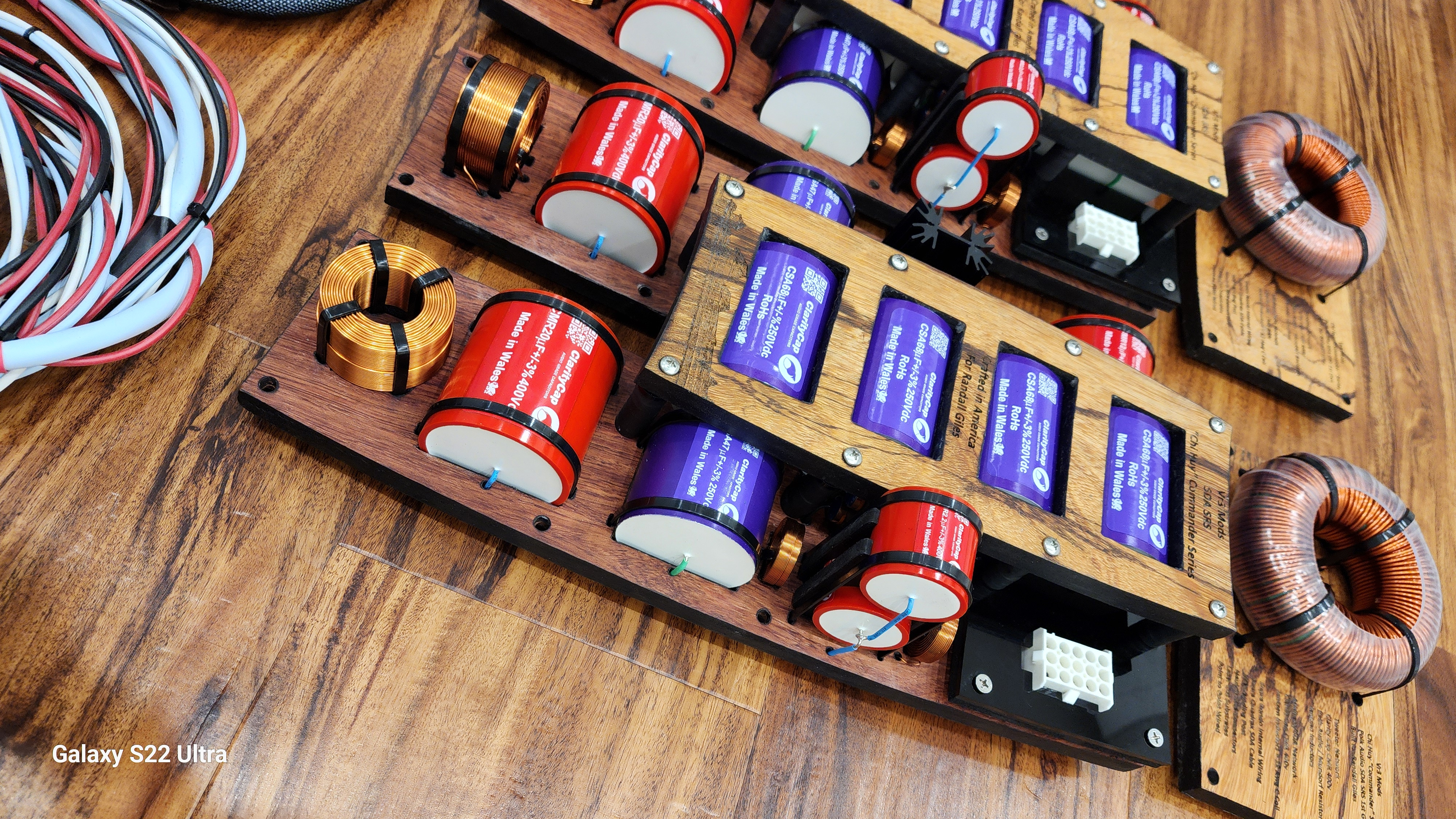

    Here's the slab of marble wood I cut up, planed and used for part of this build. I didn't snag a photo of the bubinga slab but both species is very difficult to work with.
  • skipshot12
    skipshot12 Posts: 2,141
    I will 100% verify the above comment regarding listening at high, I mean high, volume at sustained periods, from personal experience I speak.
    The music starts to take on a transistor radio type of sound. The first thing you'll notice is bass impact will start to decrease the louder/longer you crank.
    This has nothing to do with an amplifier running out of juice, it's exactly what VR is saying. It's the heat build-up of components in the crossover that's the cause.
    Most folks will never experience this as most don't listen to their system this way. Most don't punish their system's like some of us do.
    It's a weird thing that all of a sudden you wonder what's happening, hard to explain.
    You eliminate these things when you don't build to a price point.
    Carry on (Sir) building these masterpieces and raising the bar.
    Skip

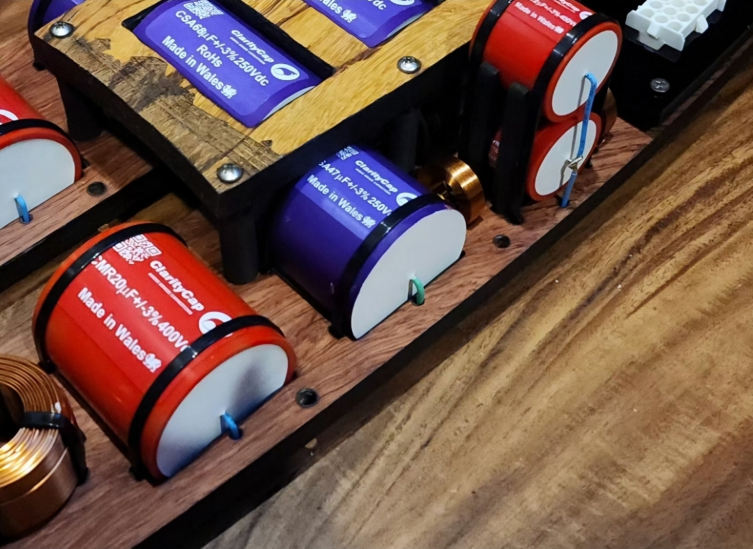

    VR3 Posts: 29,731
    Thank you
    Also this eventually will cause resistors to drift in value permanently so if you experience this on a regular basis you should highly consider introducing a heat sink to the build
  • drop1
    drop1 Posts: 90
    Thank you- that's really helpful to have awareness of.
    VR3 Posts: 29,731
    When I rebuilt my grandes, the difference in sound quality over say a 3 hour session at 85db nominal with a heat sink crossover versus normal was night and day.
    The composure of the sound stayed unchanged and using a temperature gun showed the resistors never went above room temperature even 3 hours in.

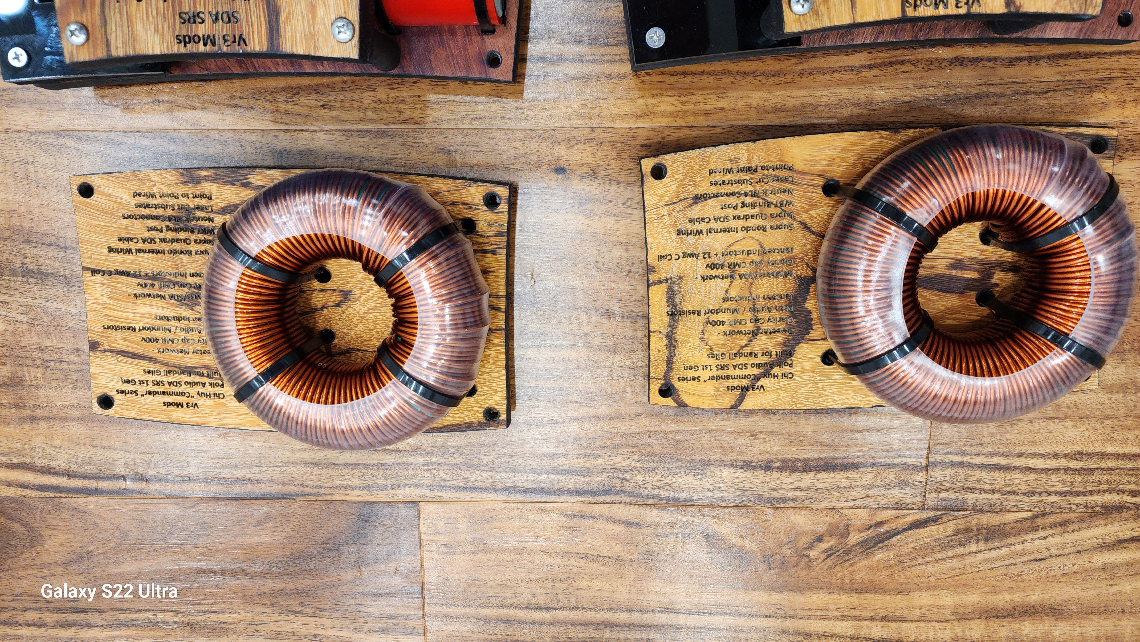

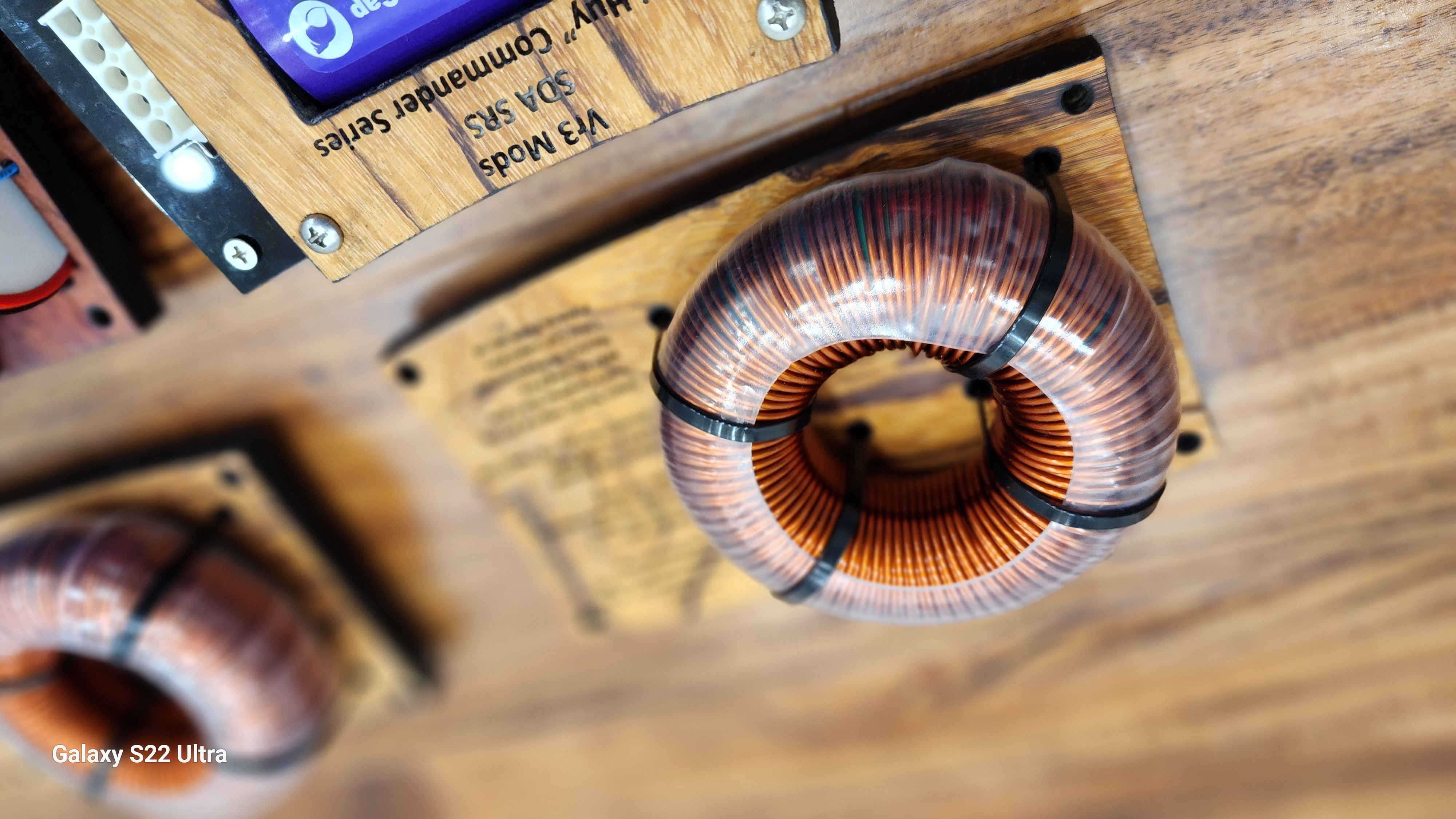

    On the opposite side of the spectrum, the parallel resistors for the midrange were burning the substrates of the oem crossover.

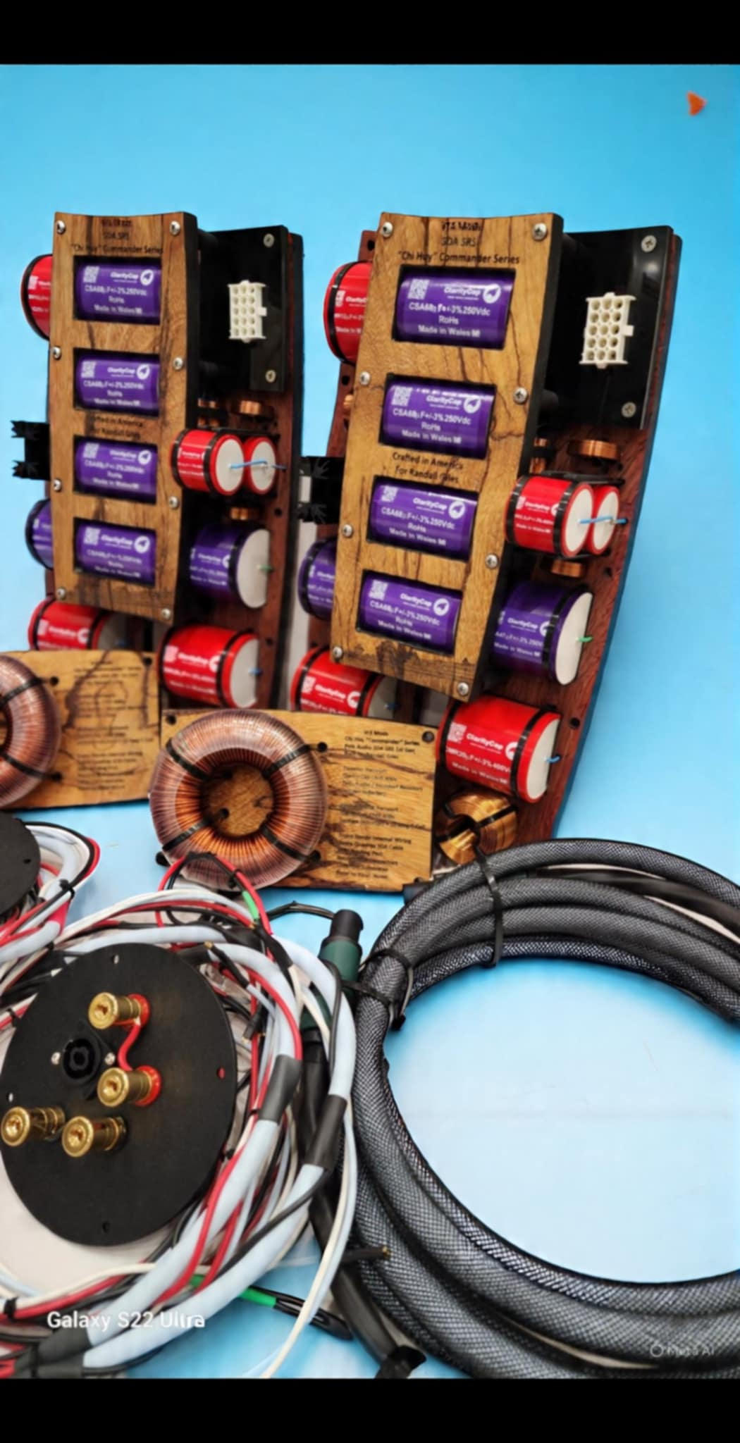

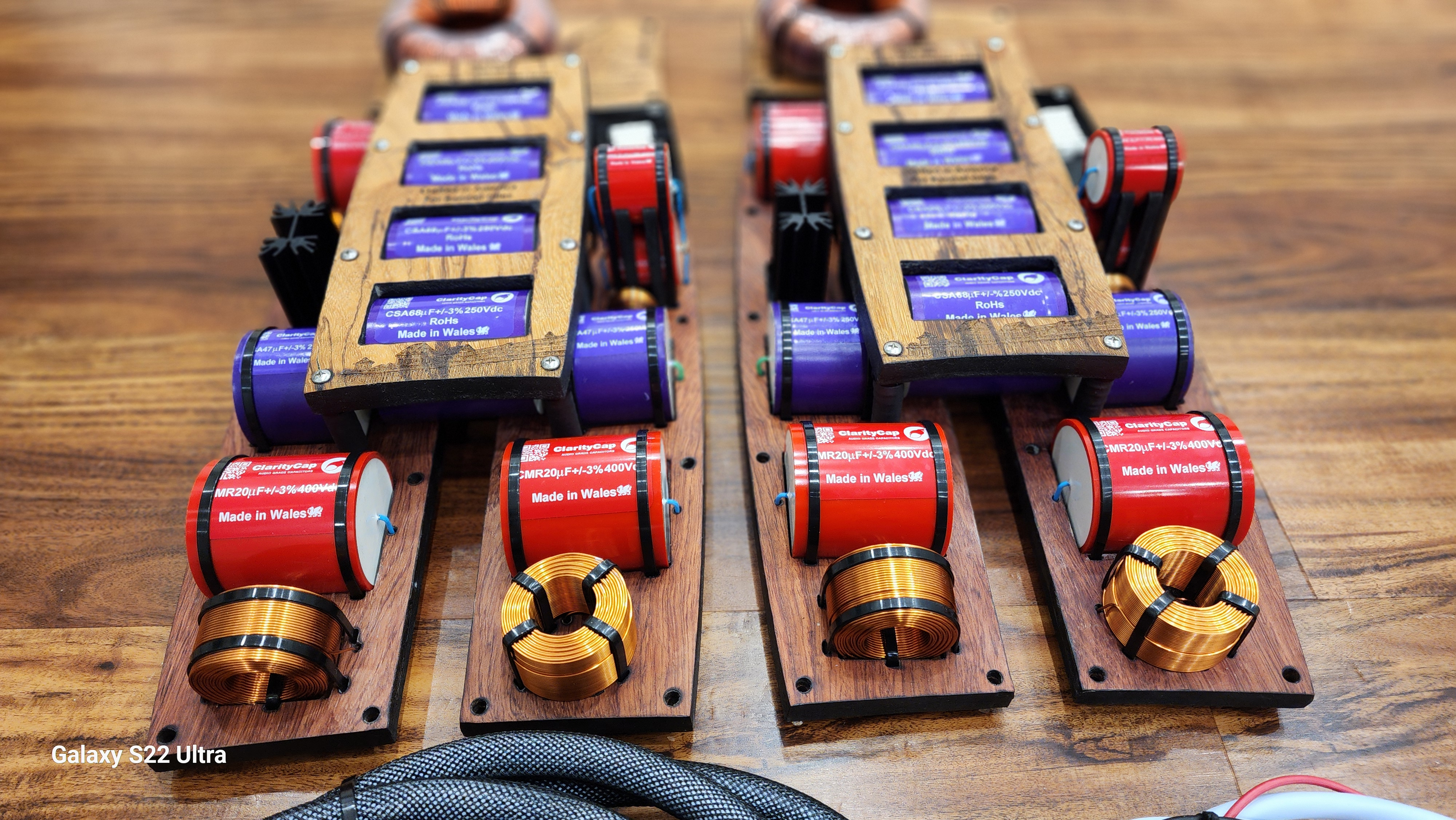

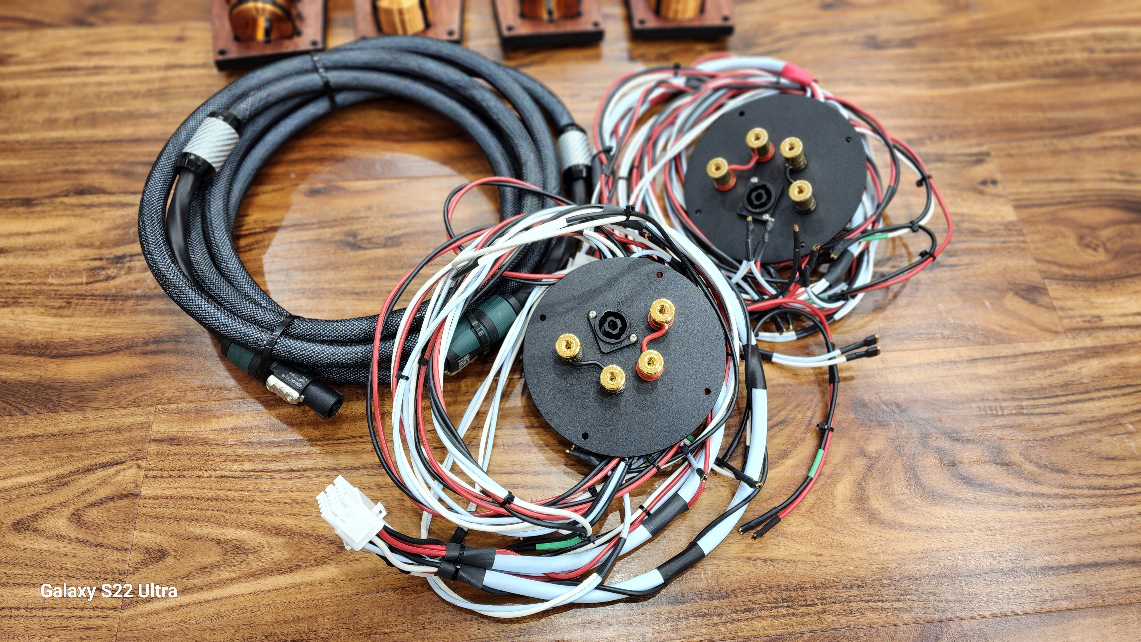

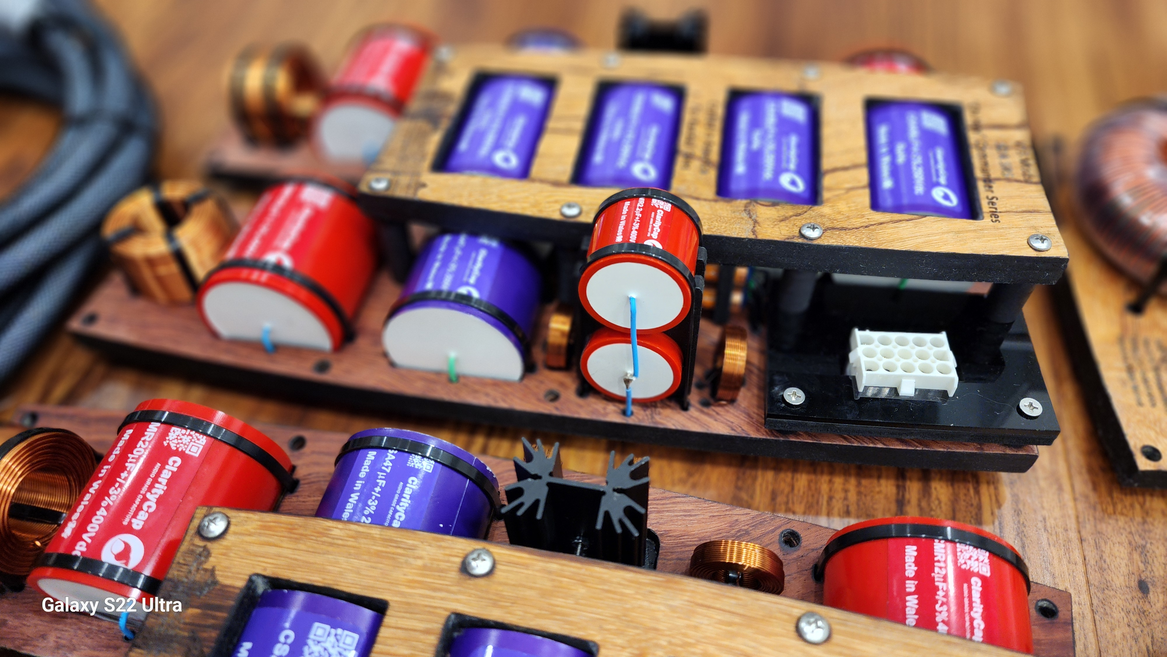

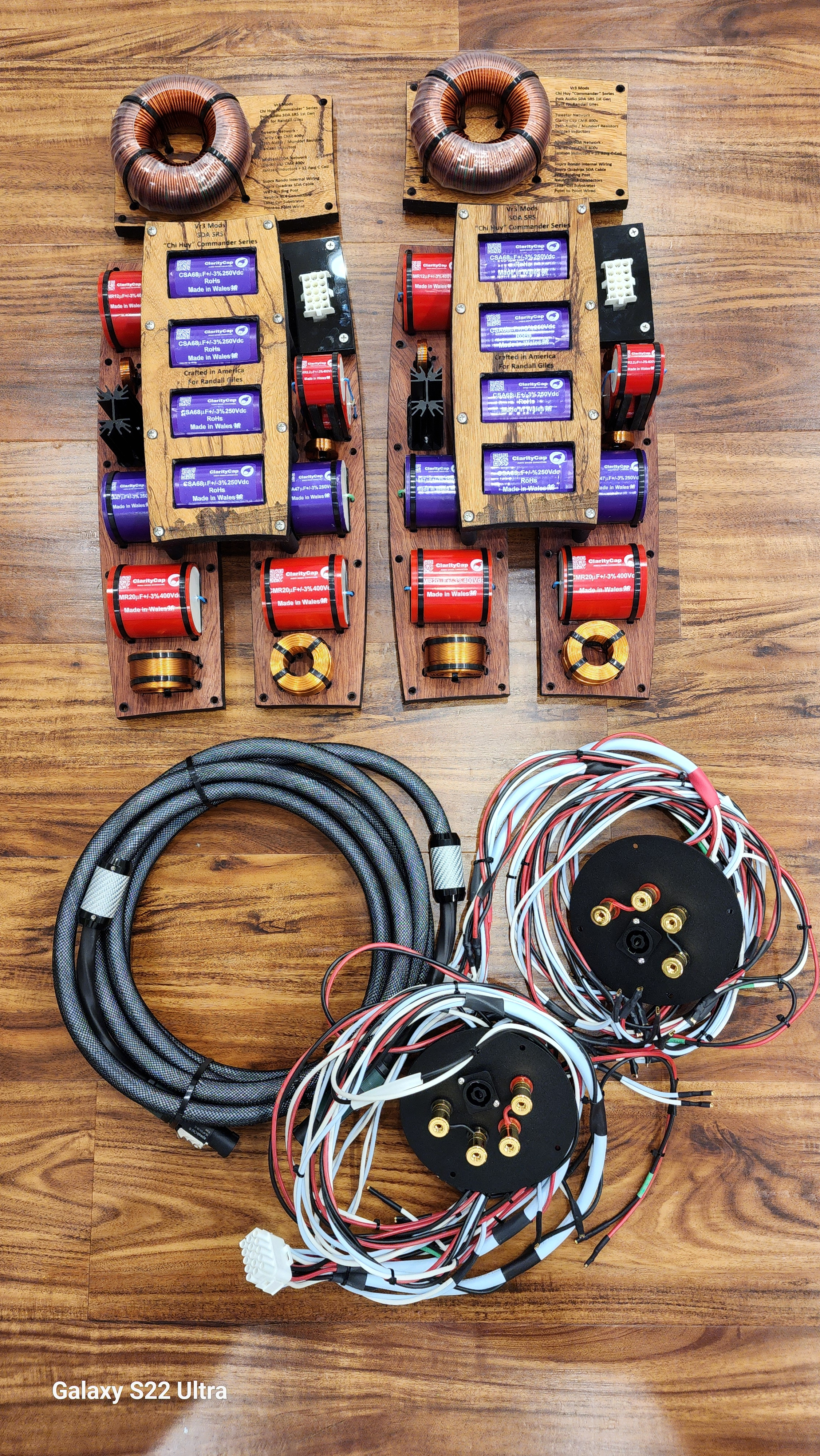

    VR3 Posts: 29,731
    edited July 2025
    Tweeter network
    Clarity cmr
    Clarity csa
    Path audio and mundorf resistors
    Jantzen inductors
    Supra rondo
    Mid /sda
    Clarity cmr
    Clarity csa
    Jantzen inductors and 12 awg c coil
    Supra rondo
    Point to point wired
    Marble wood and bubinga substrates, backed with mdf and laser cut

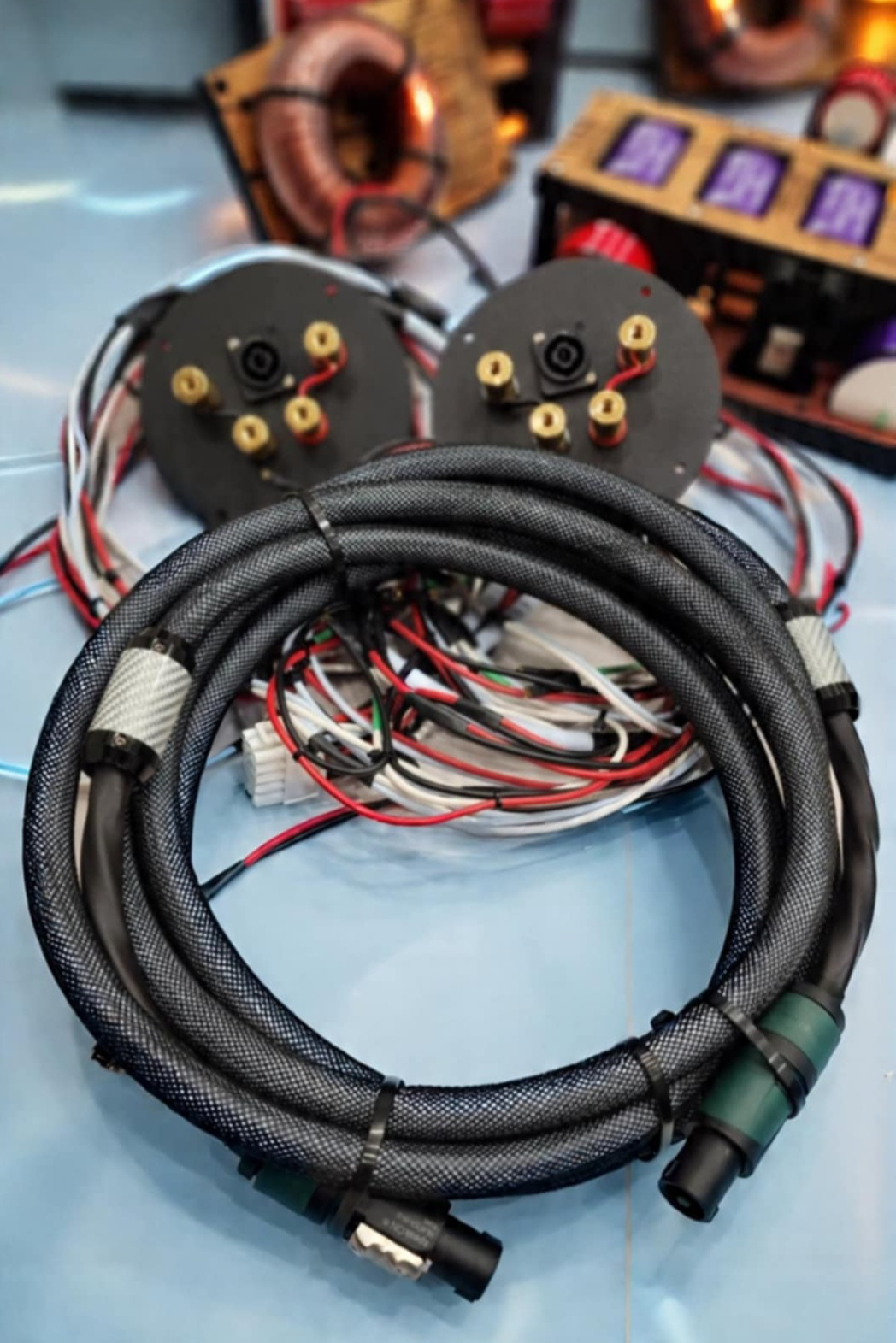

    Supra quadrax sda cable
    Wbt binding post

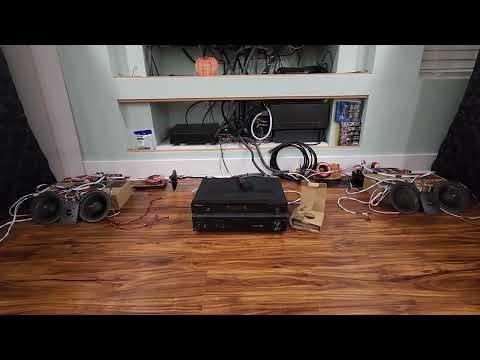

    VR3 Posts: 29,731
    Thanks everyone! I'll send a video of them playing this weekend 😁
    Viking64 Posts: 7,803
    edited July 2025
    Sign me up for the SDA SRS Beast® Road Test.
