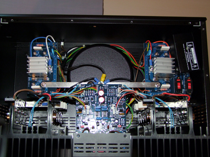

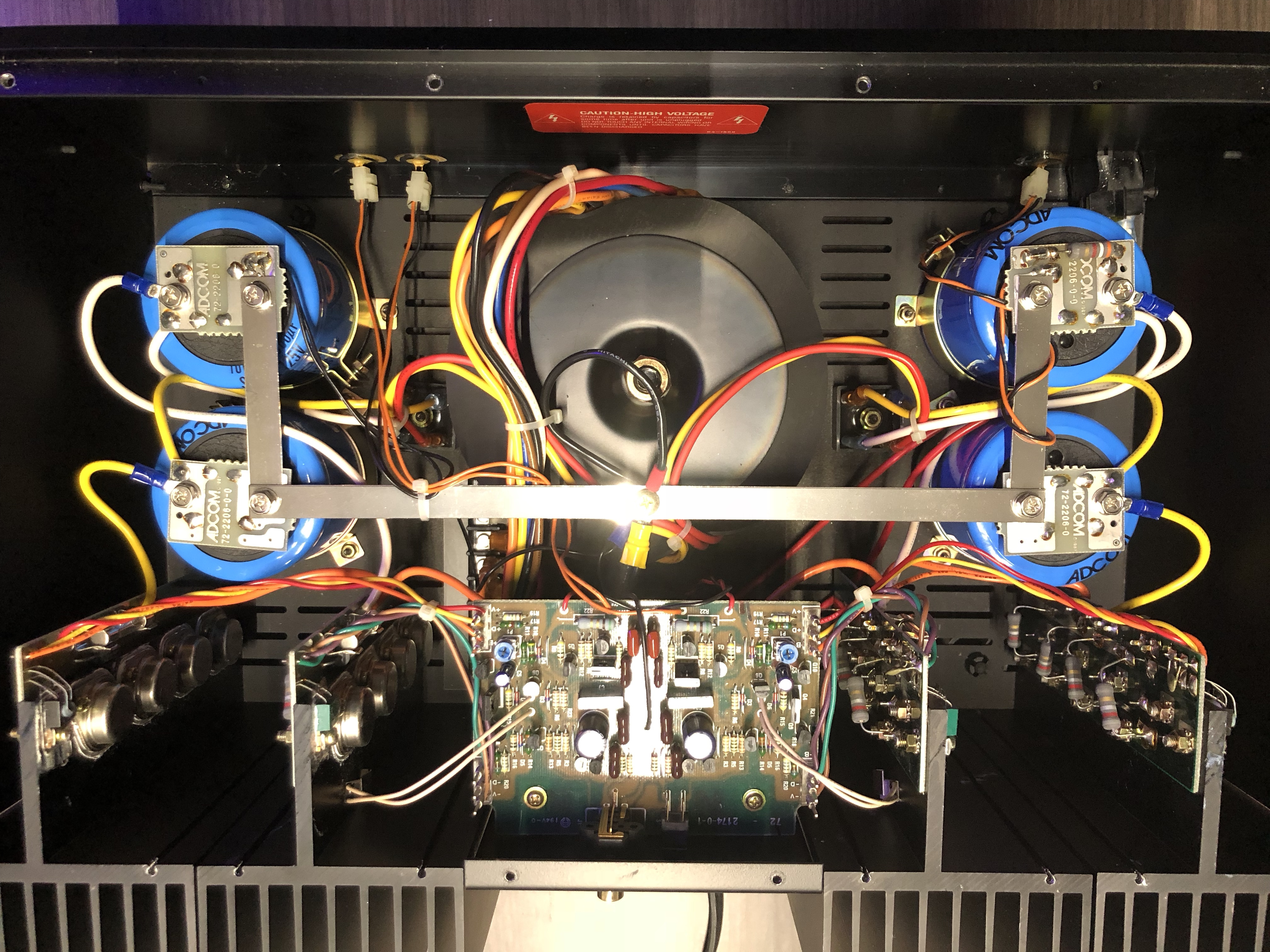

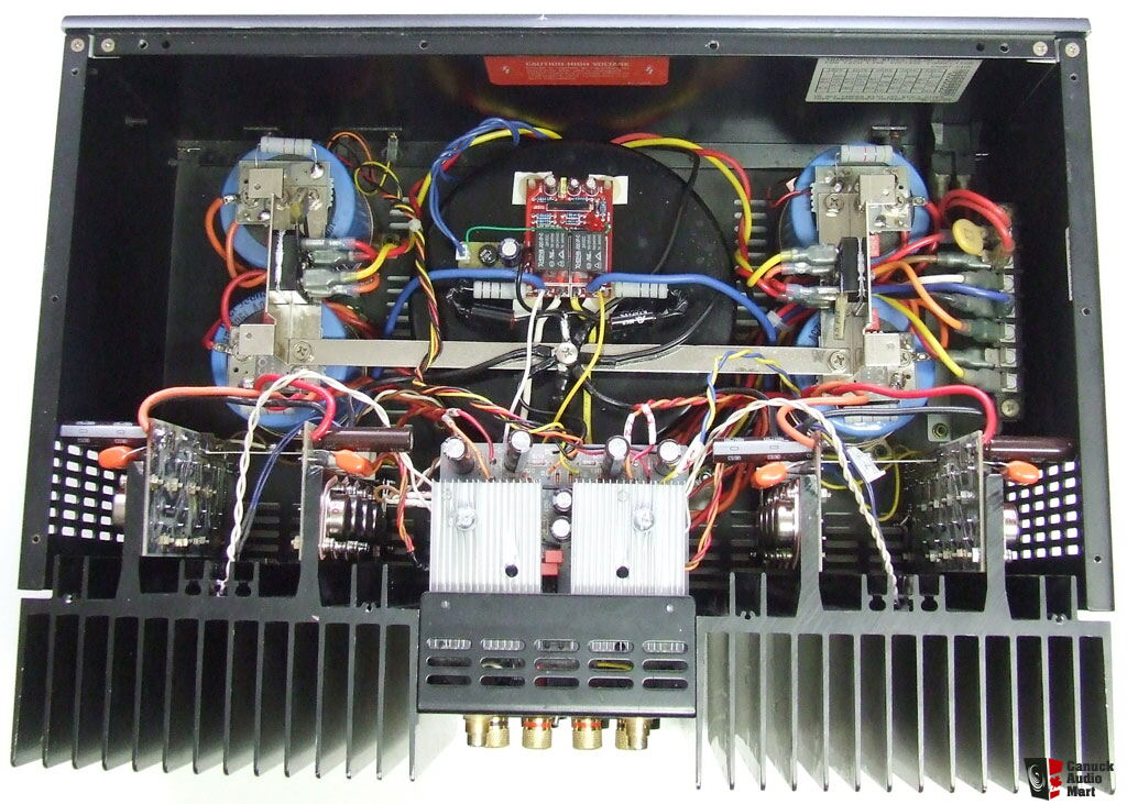

    VR3 Posts: 29,663
    Possibly could be similar...
    original series II
    new version
  • rhythm
    rhythm Posts: 60
    Definitely a more modernized implementation at the least...
    Main thing of course is: how does it sound and perform? Hopefully someone here has checked the new model(s) out (GFA-555se or GFA-555ms) and can report what they think.
    VR3 Posts: 29,663
    Just in my brief online searching, I noticed the new version goes for about the same as the old version used, fwiw

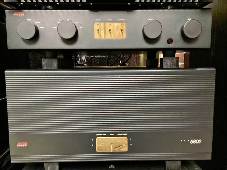

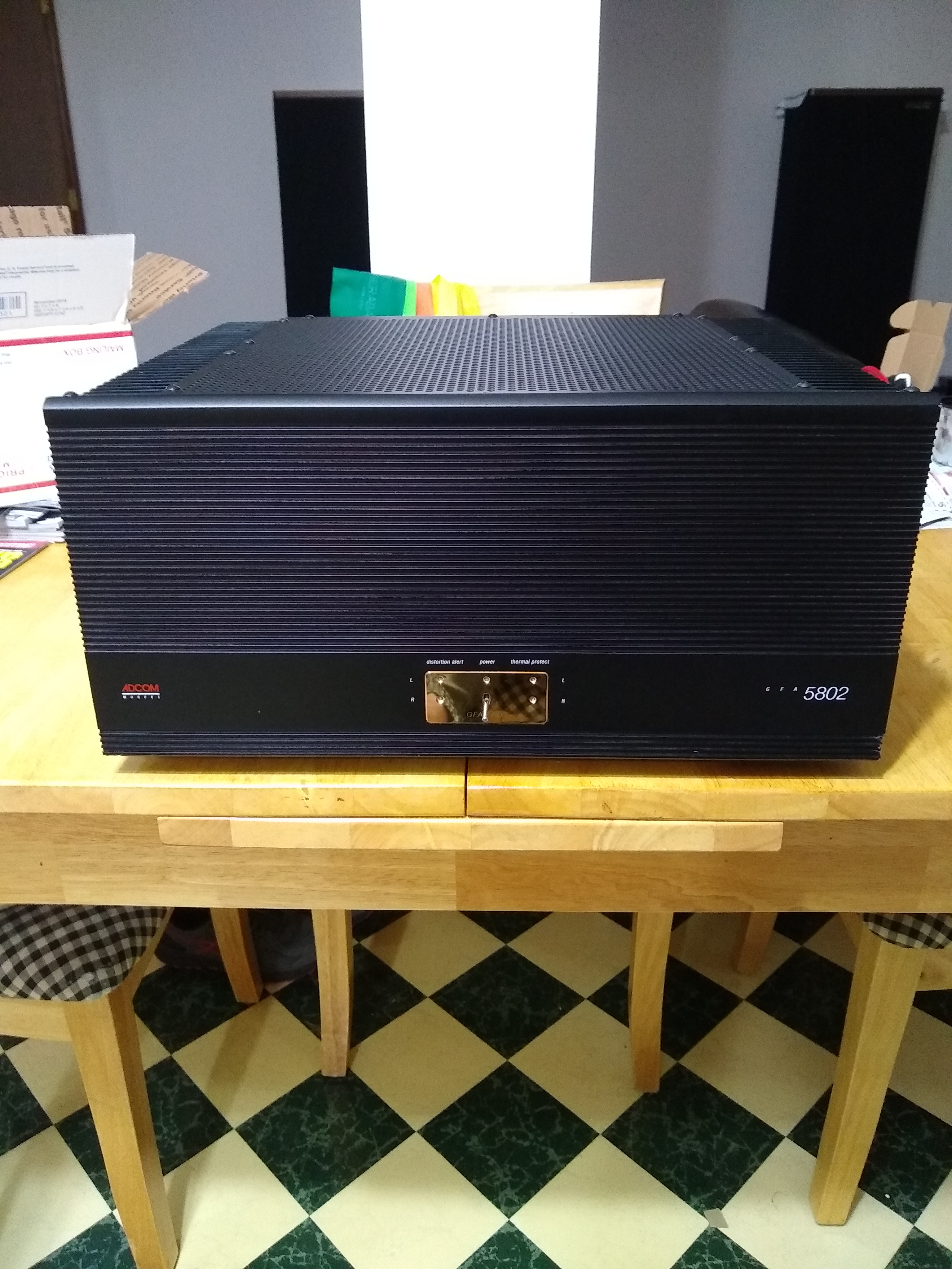

    Toolfan66 Posts: 18,335
    edited May 2025
    Only the original Adcom 555 was a Nelson Pass design IIRC. The 2 and later versions used a Darlington configuration, which strayed away from Nelson's design.
    5802
    pitdogg2 Posts: 27,691
    edited May 2025
    Yes but the 5802 and others in that 4 digit series were not common ground.
    Was the 555 Common Ground?

    michaeljhsda2 Posts: 2,207
    Where's the large capacitors in the new version?

    VR3 Posts: 29,663
    They went to not so large capacitors if I had to guess 😁

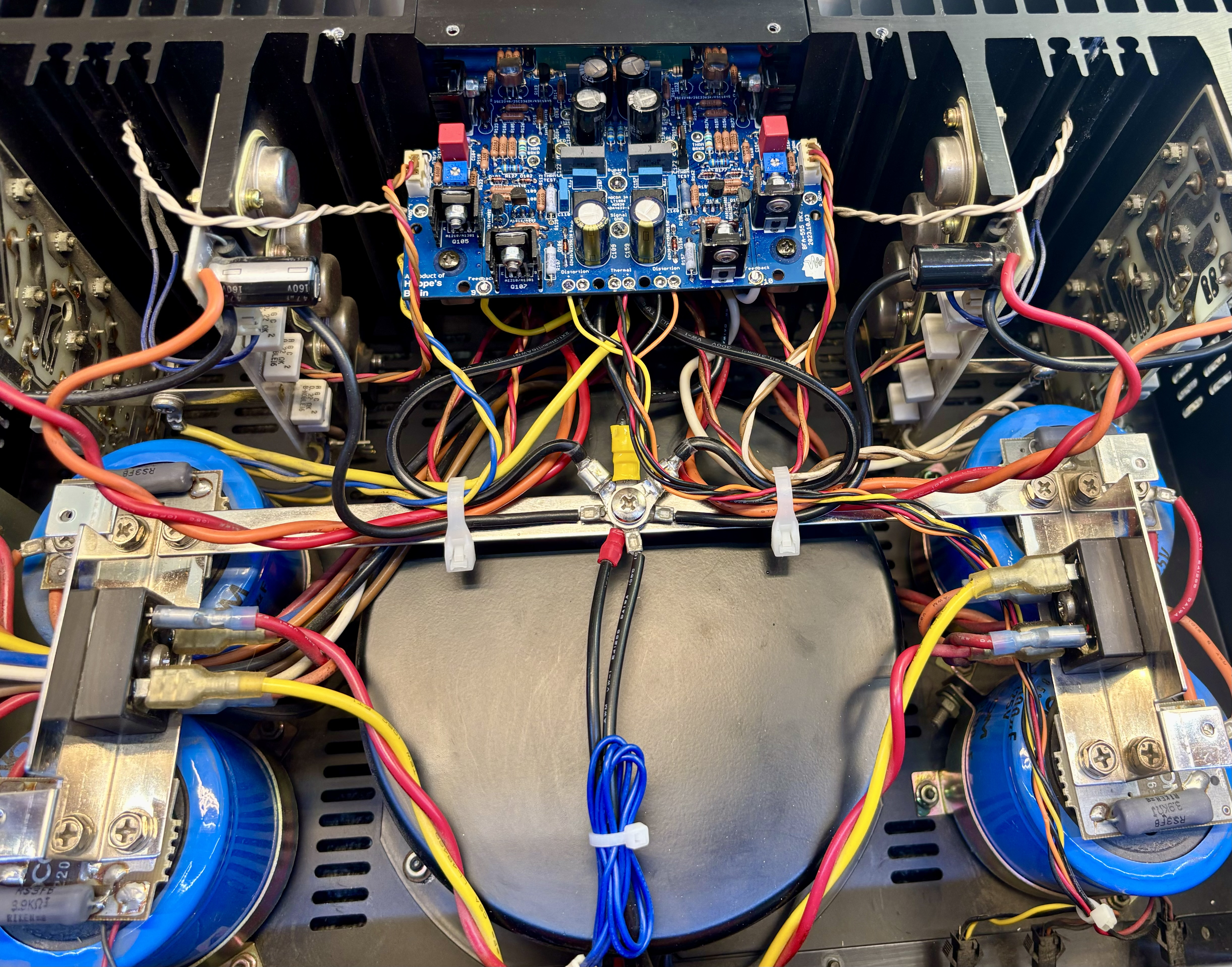

    I have reworked a 555se for a friend and have been into a few original 555’s and 555ii’s. Not familiar with the “ms” version. As I understand it, the original 555 is the only “true” Pass design. But the later versions still use the same (essentially) physical layout, transformer, rails, final stages and main caps. Rectifiers moved up on top the caps in ii and later. To answer the question above, the big caps are still there, the newer versions just have pcb’s that mount on top of them vs the “free air” configuration of the original 555. Worthy of note, up to se, there are no speaker protection relays. Chris Hoppe offers a really nice kit to add protection and a 12v trigger as well. I plan on building a couple of those this winter…
    The units I’ve had (and still have) are absolute tanks. The driver board is a completely different schematic when going from 555 to ii and se is the exact same schematic as the ii. The se has nicer heat sinks (less sharp edges, beefier) and felt a little more “mass market” than previous revisions. Original 555’s definitely have more of a homebrew feel when it comes to build quality, if that makes sense. Every one of them has had heat issues in the early stages. I’ve rebuilt several using Chris Hoppe’s replacement kits which beef up the board, all of the components and adds heat sinks to most of the semiconductors in the gain stages.
    I have found that I prefer the ii’s with Chris’s kit installed. The top end is better, imaging is better, and the background is quieter. I also like how robust the kit is. I sold my original pair of 555’s. I never disliked them, I just didn’t need six of them… 😎
    Chris offers a lot of good info and is quite responsive to questions. An odd, mad genius kind of individual, but super nice. Chris knows lots of lore about the 555. Definitely a guru. Here’s the website: https://hoppesbrain.com/
    And yes, the 555, ii, and se are all common ground.

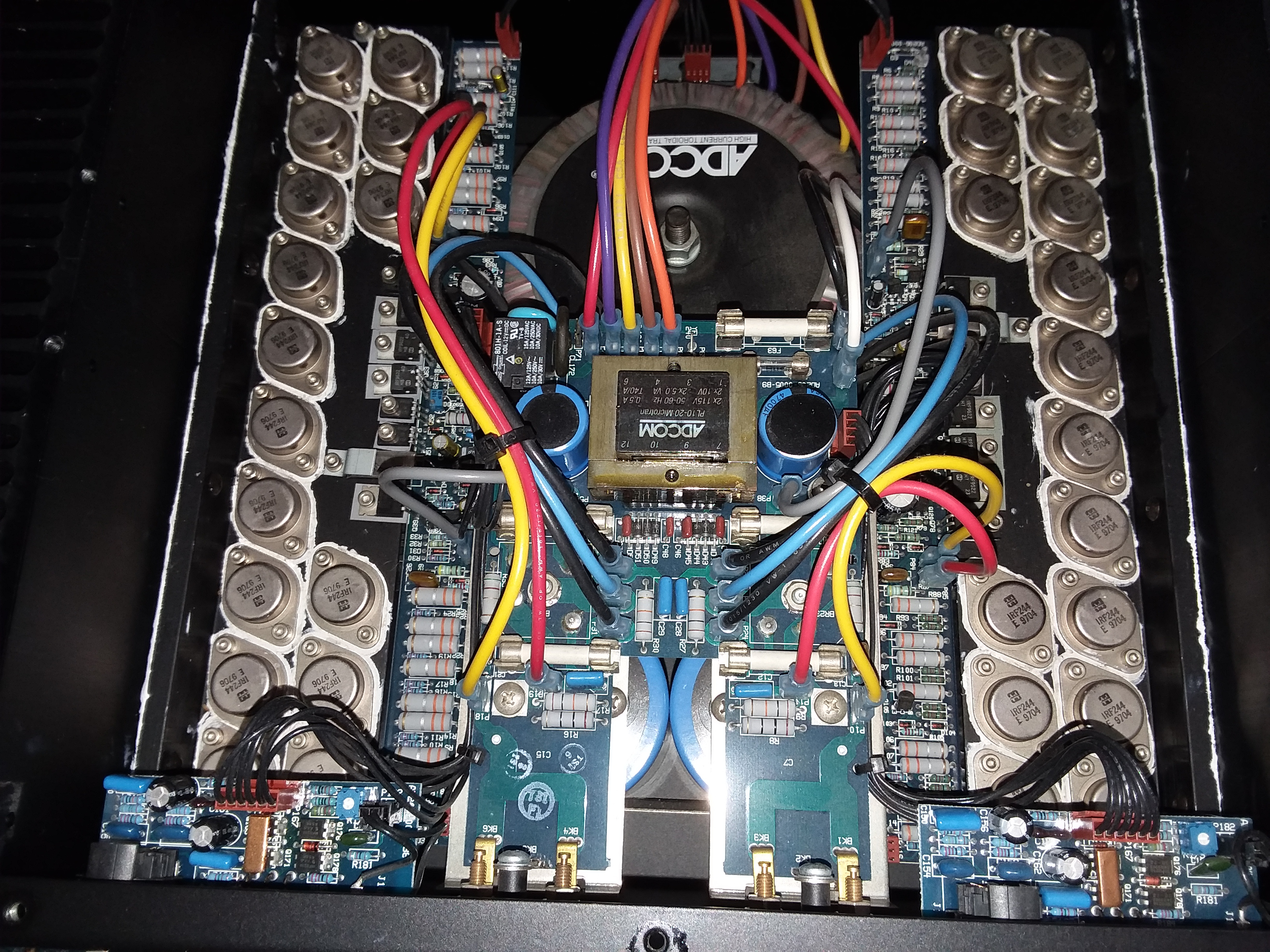

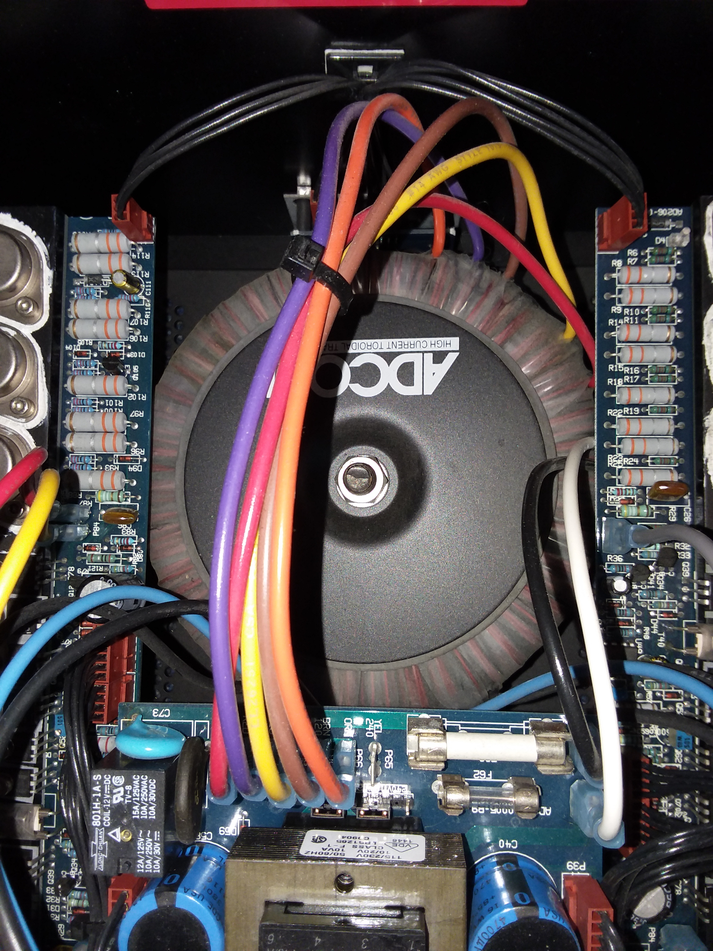

    edited May 2025
    SDA SRS 2.3TL's
    SDA 2B TL's

    Original 555:
    555ii with Hoppes board installed:

    You're correct Chris Hoppes is a very generous guy with information. I reached out to him to go through my 5802, he told me NO AMOUNT of money would get him to touch another, EVER!! I was so bummed after seeing what he had done to a couple.
    😂😂 Mad genius is correct.
    His basic statement was Adcom had a premium product but put zoo monkeys in charge of the build with hammers. The things he found and had to overcome to rebuild them was basically insanity for such a premium amplifier. He plainly stated "it's not if it will break down, it's WHEN will it, because it is going fail badly when it dies.
    It was the most powerful amp Adcom ever built.
    I never did find anyone worth their salt to touch it.

    Wow, I forgot all about that beast. I guess the 5802 was the second most powerful amp Adcom built.😜
    Adcom didn't make too many amps above 250wpc.

    IIRC the 5802 is not common ground

    No, not at all. Nice amp but at this stage in it's life a ticking time bomb.
