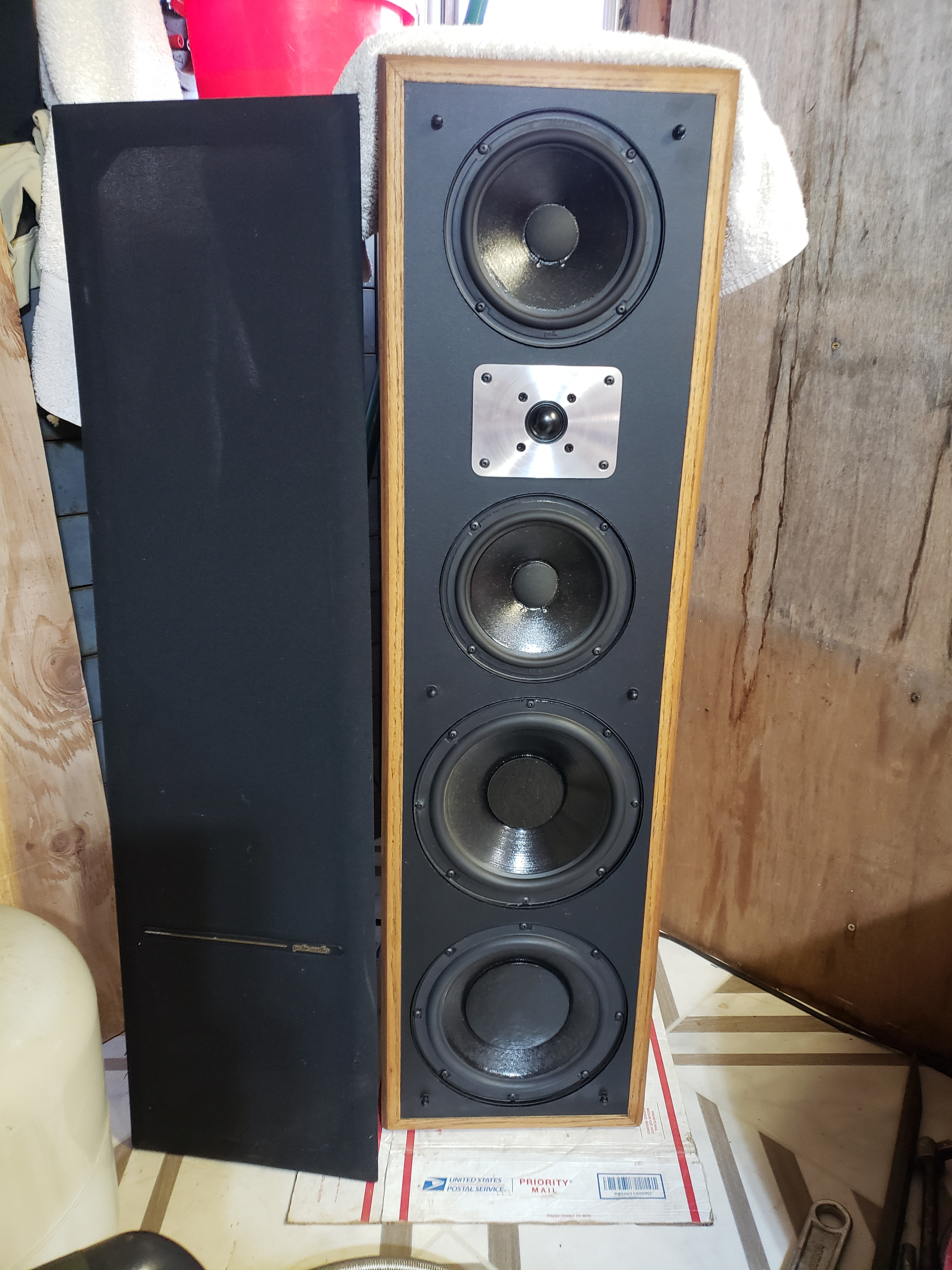

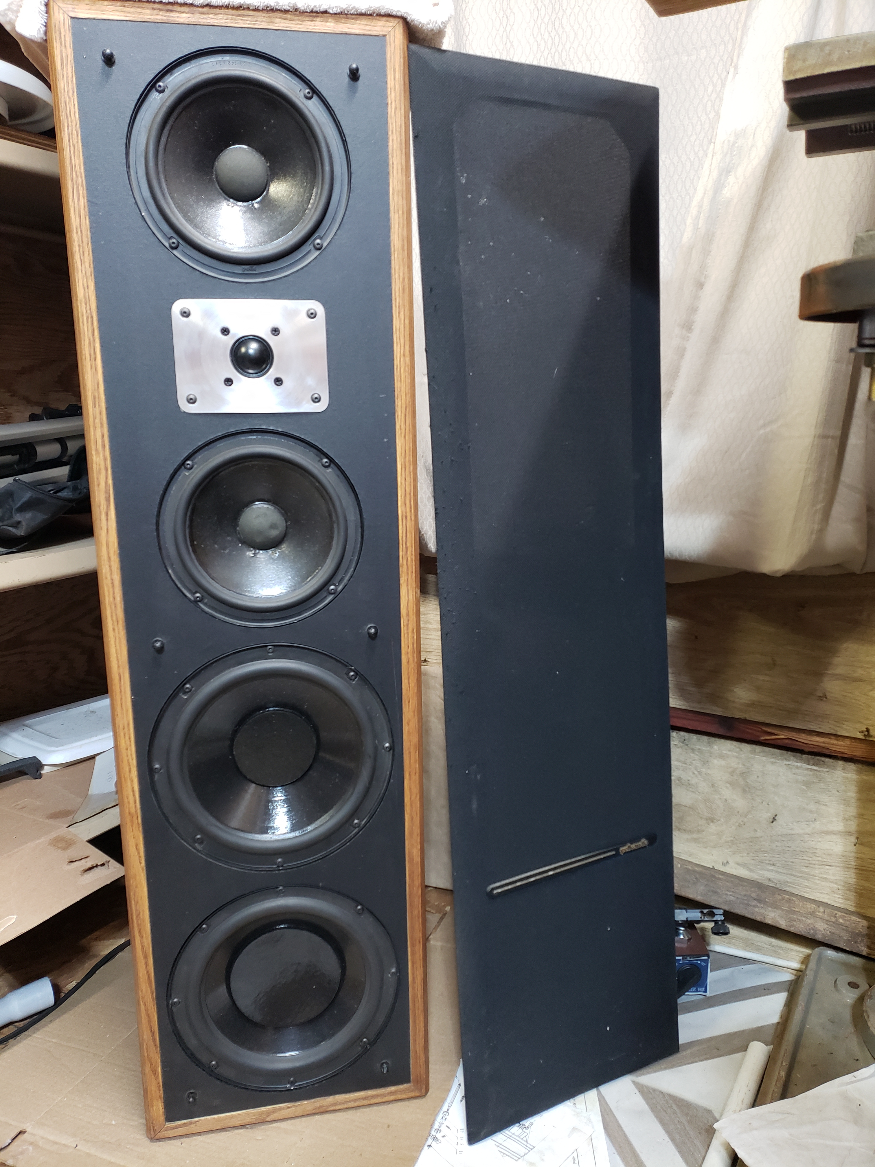

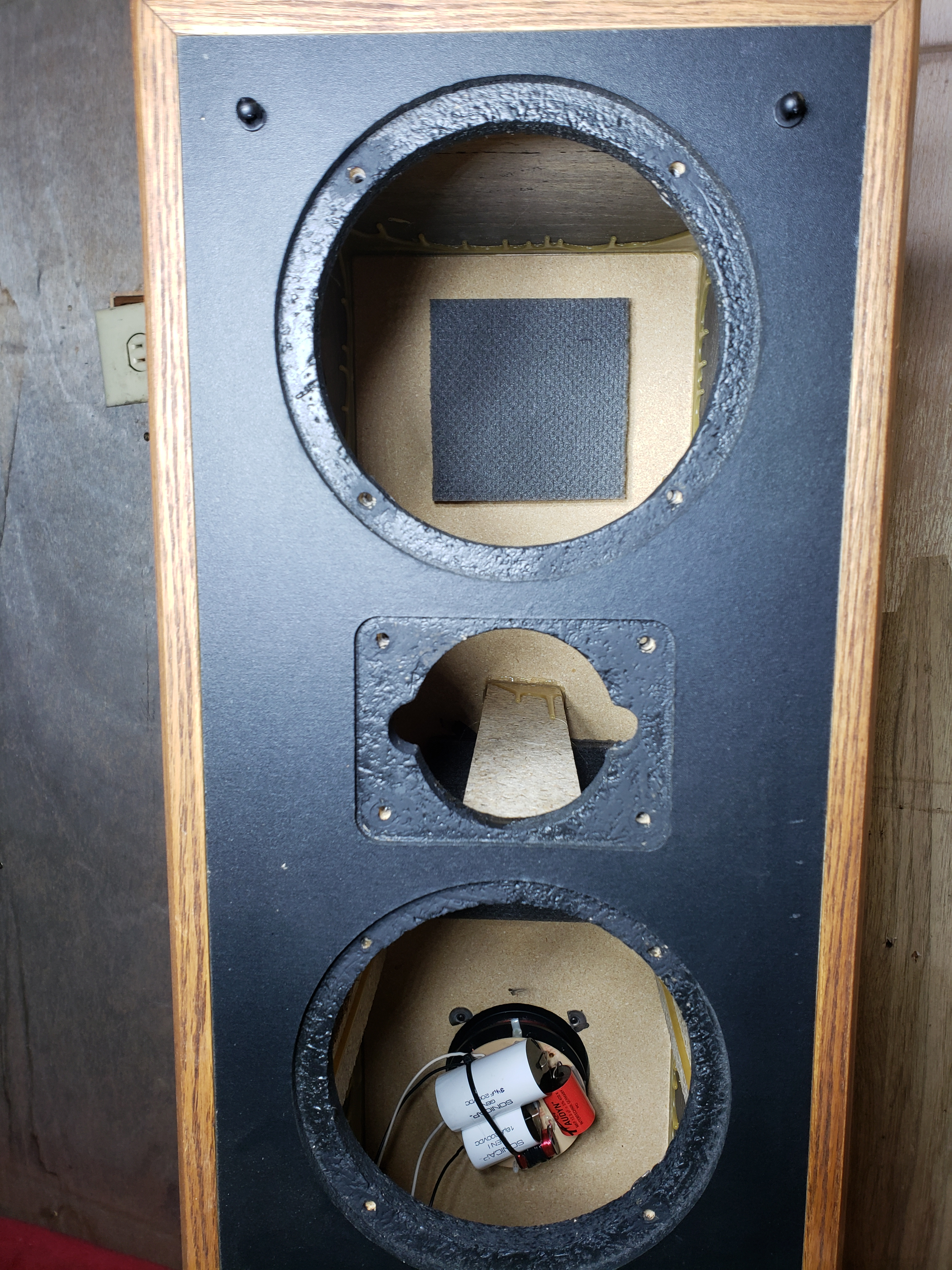

My friend had me go through his 11T's and do the TL mod last year. They turned out awesome. Forgot to post pics for everyone last year, so here they are.

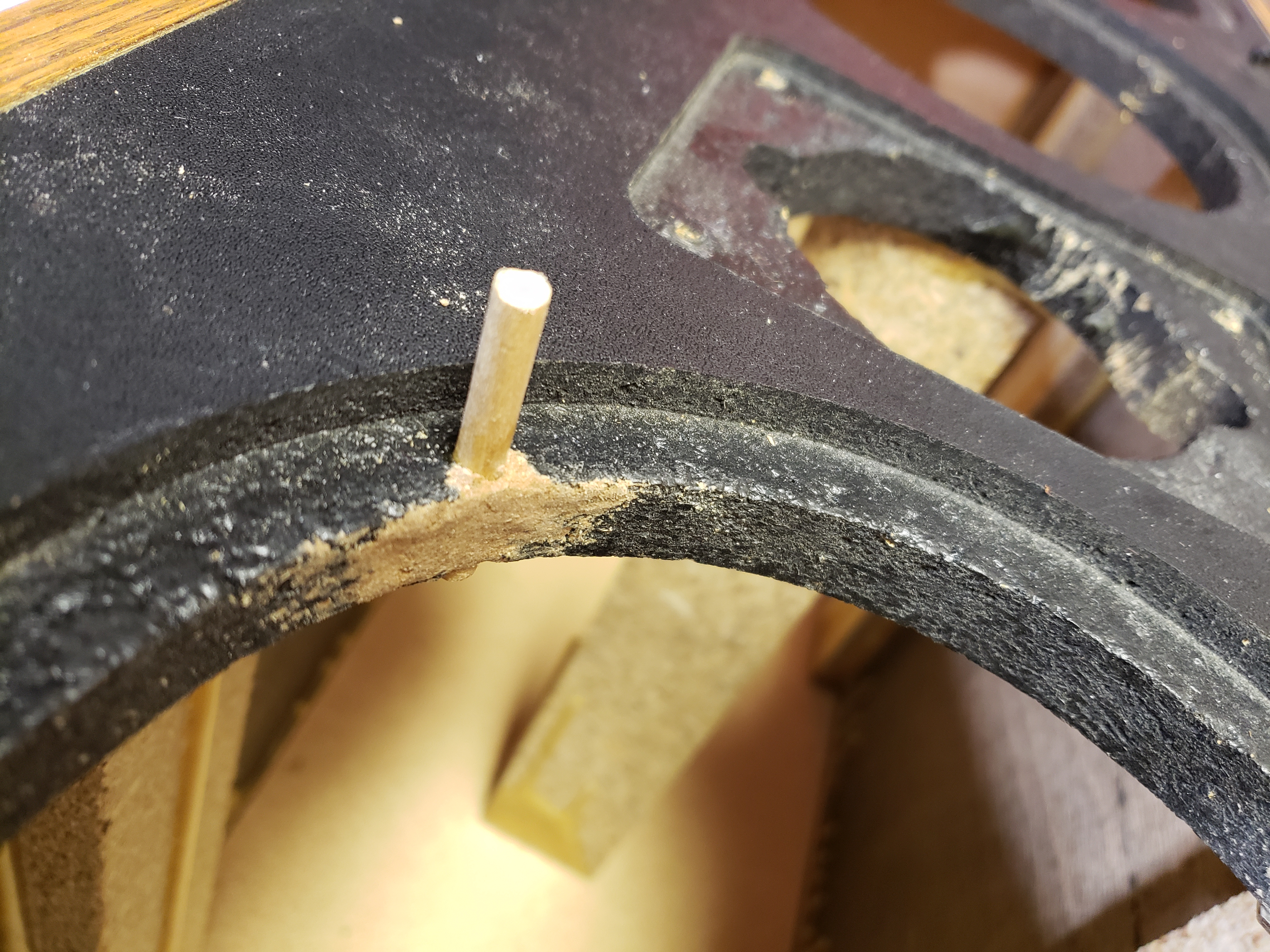

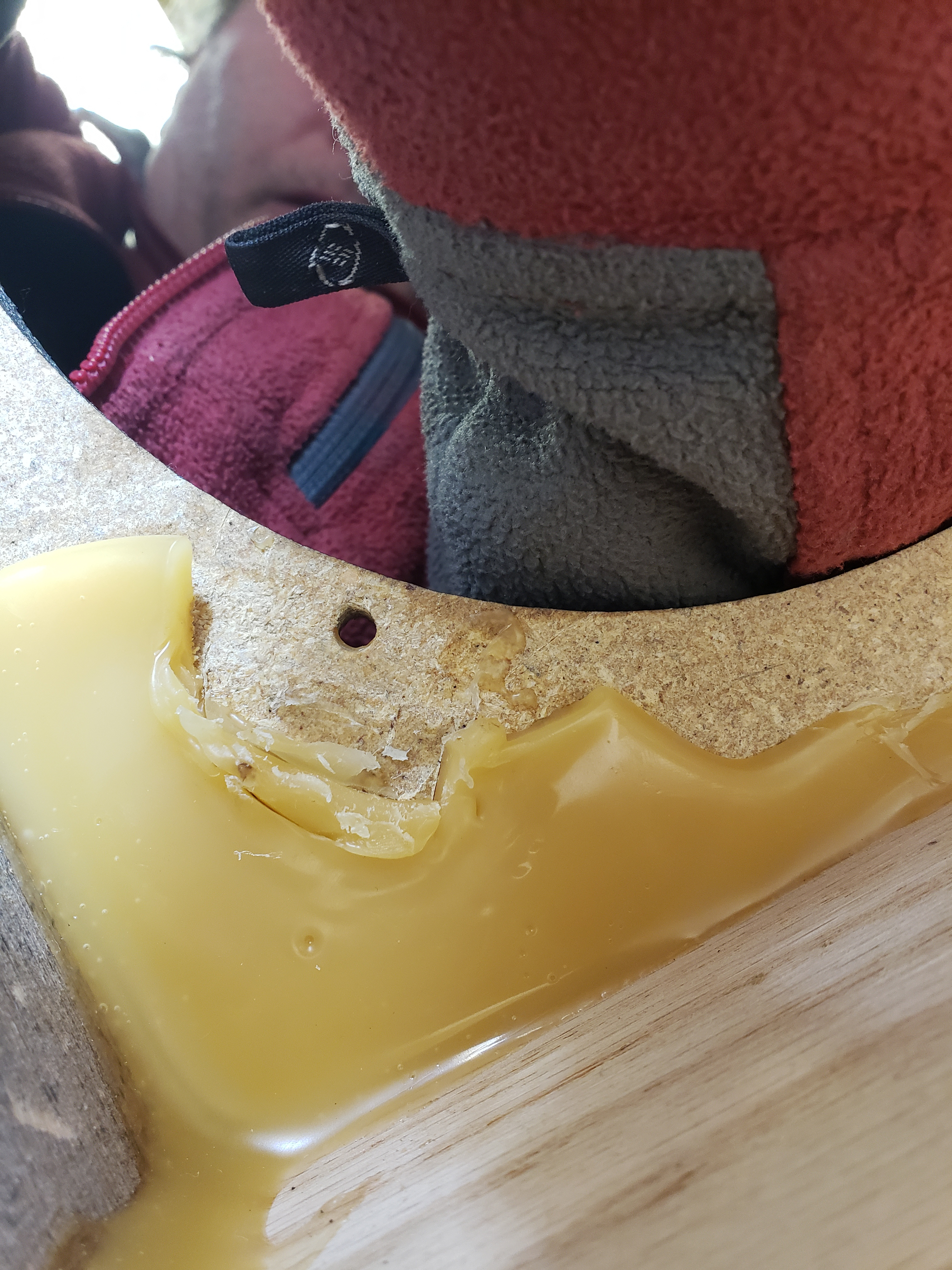

The original holes were not CNC'd and many had broken the baffle due to bad alignment, requiring some repairs.

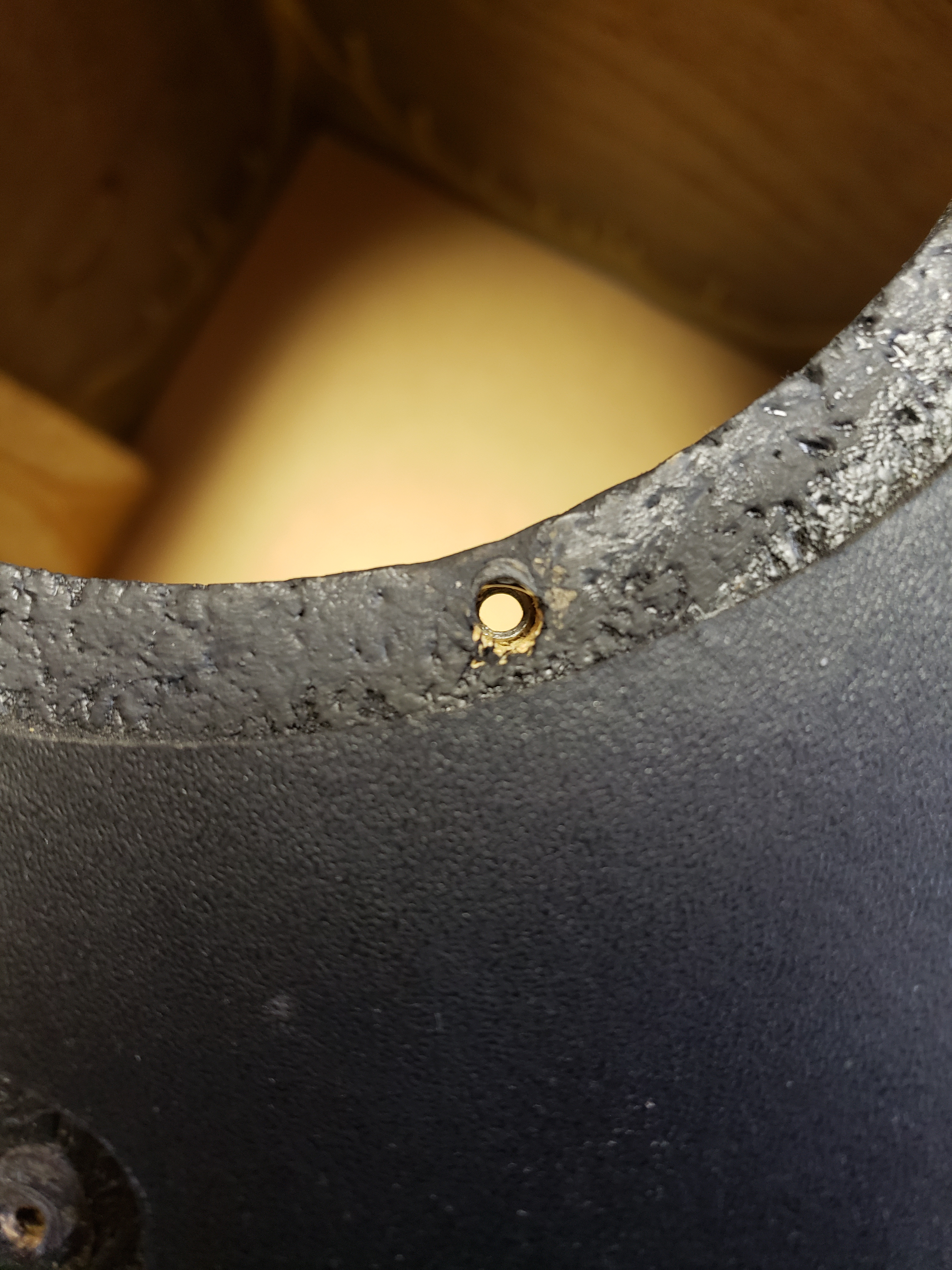

Be prepared to remove some factory over-glue to get all the hurricane nuts in properly.

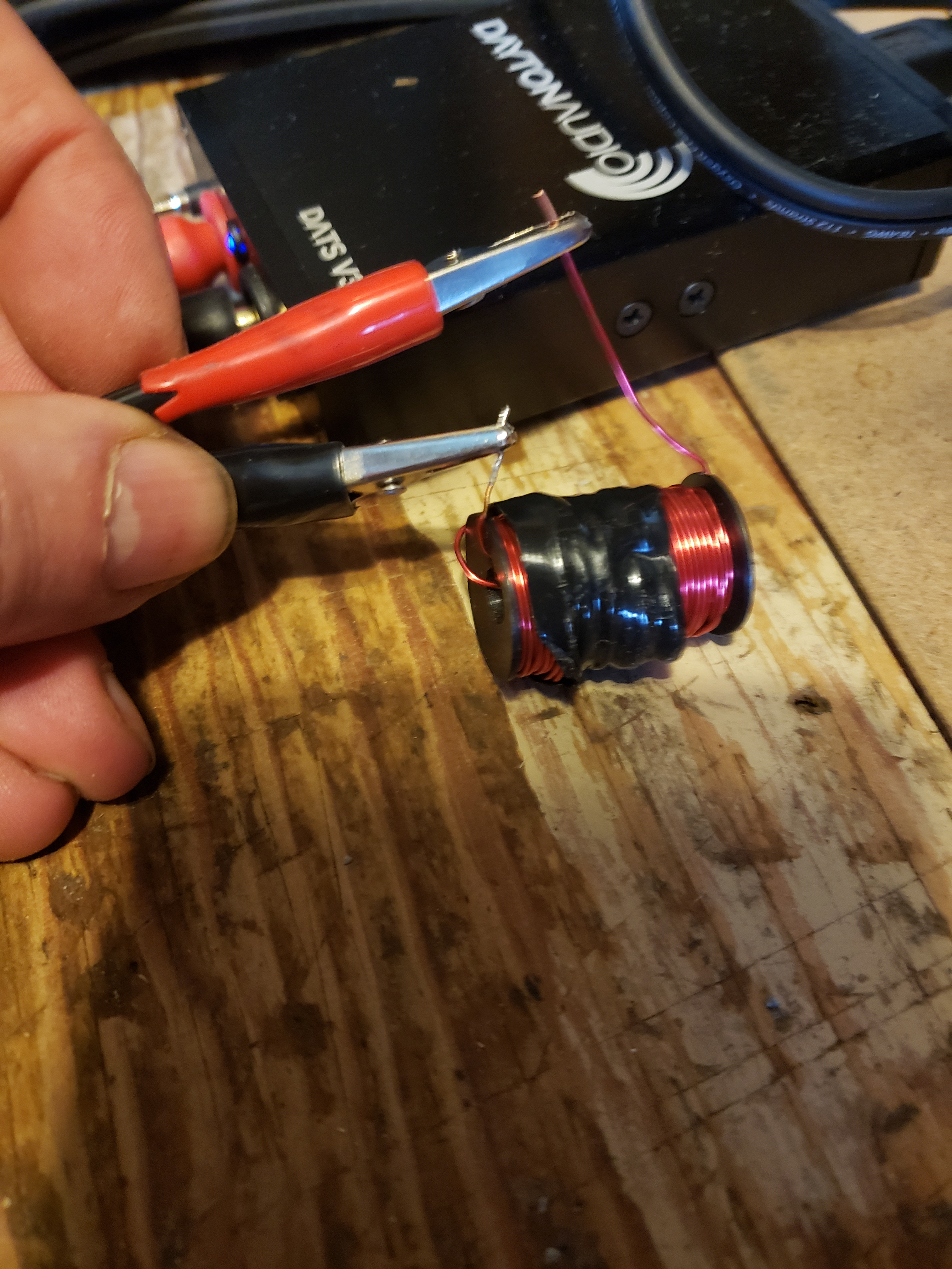

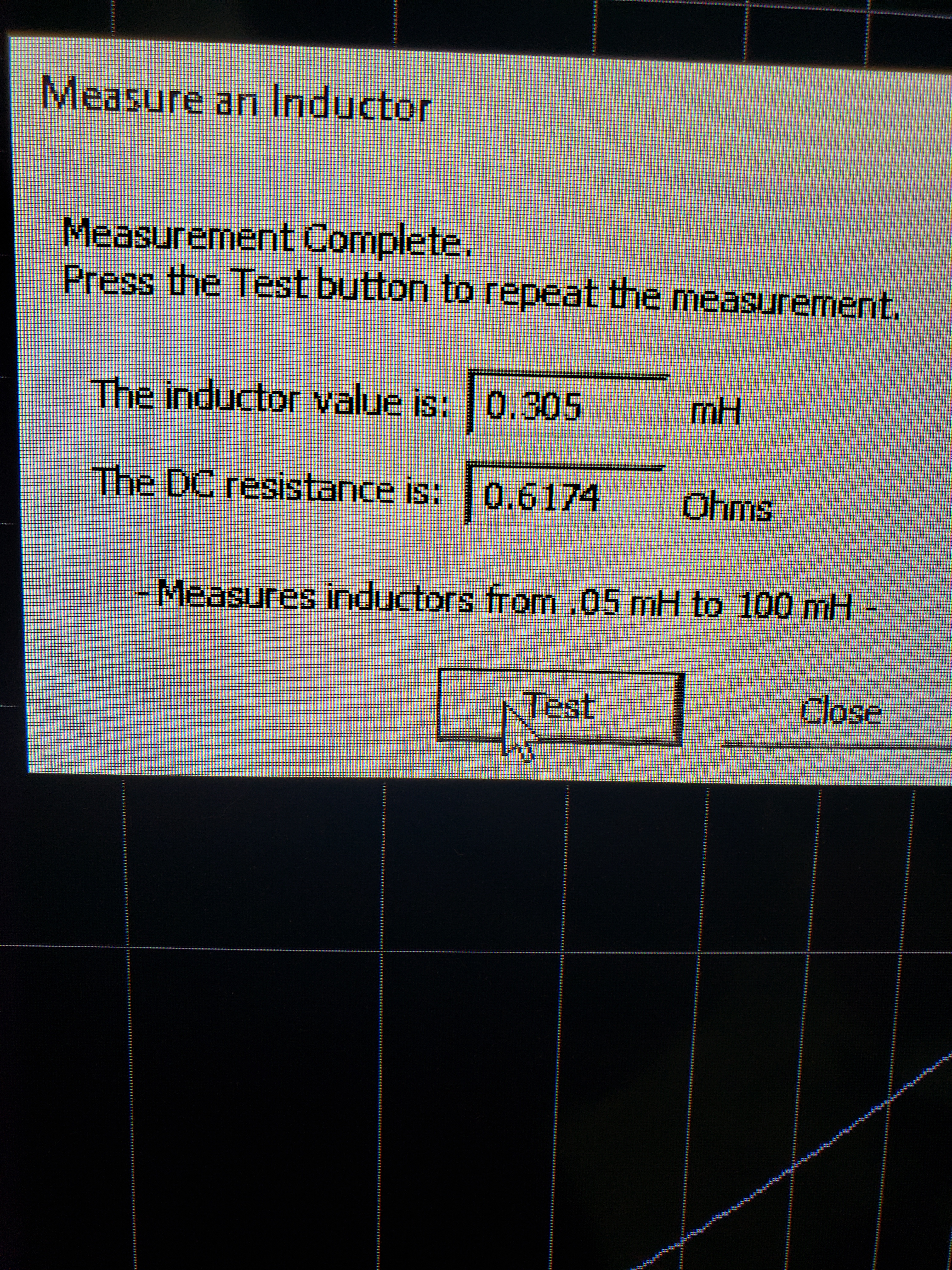

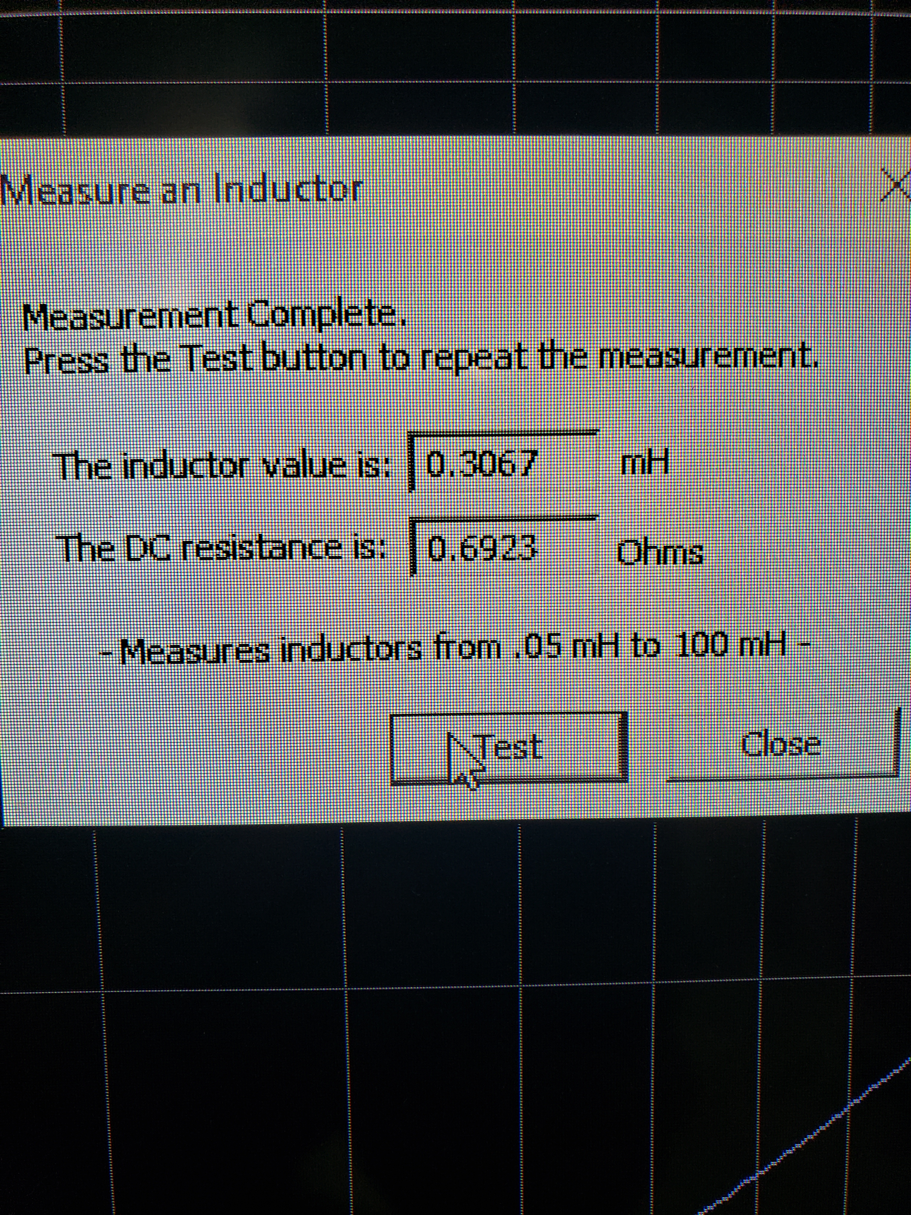

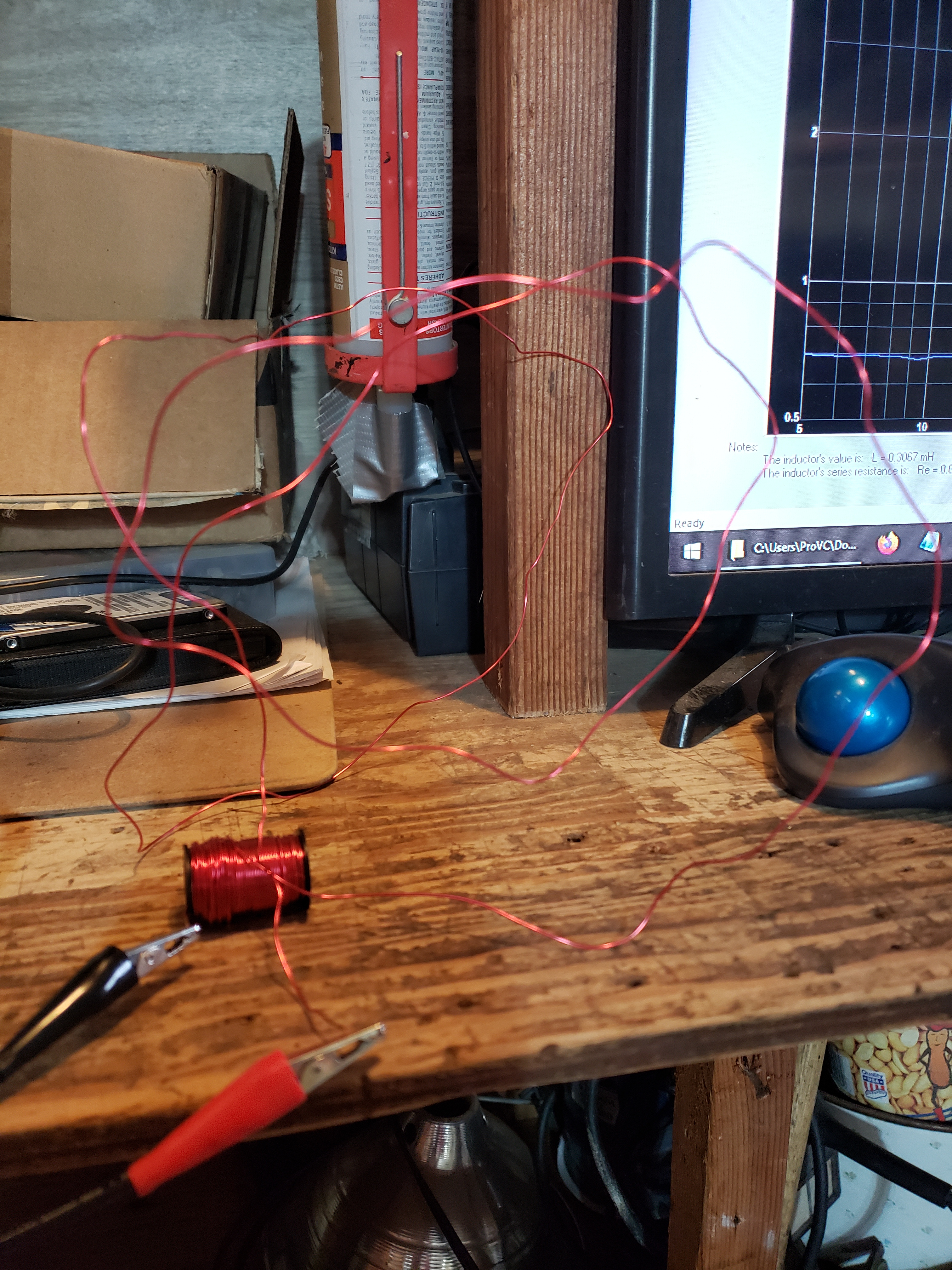

Unwinding the original 0.4mH inductor down to 0.3mH for the TL mod.

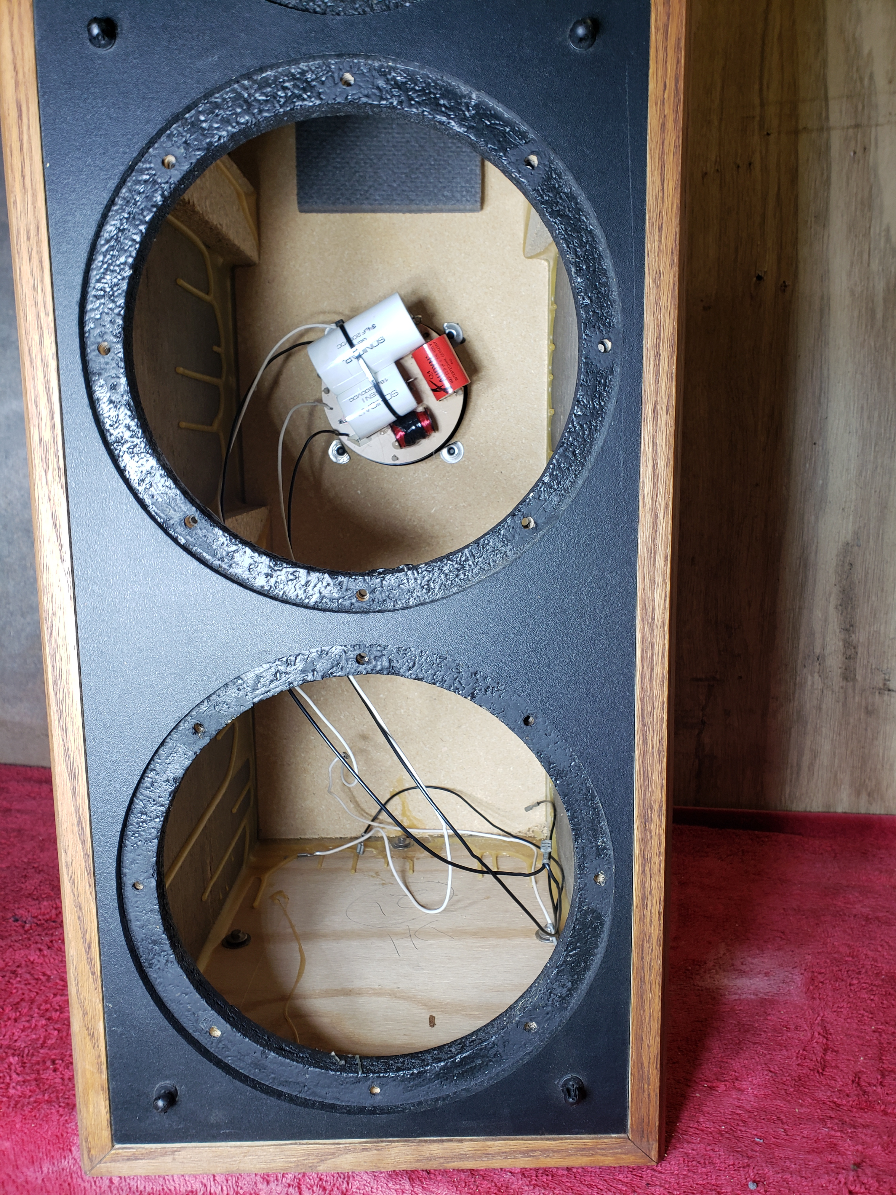

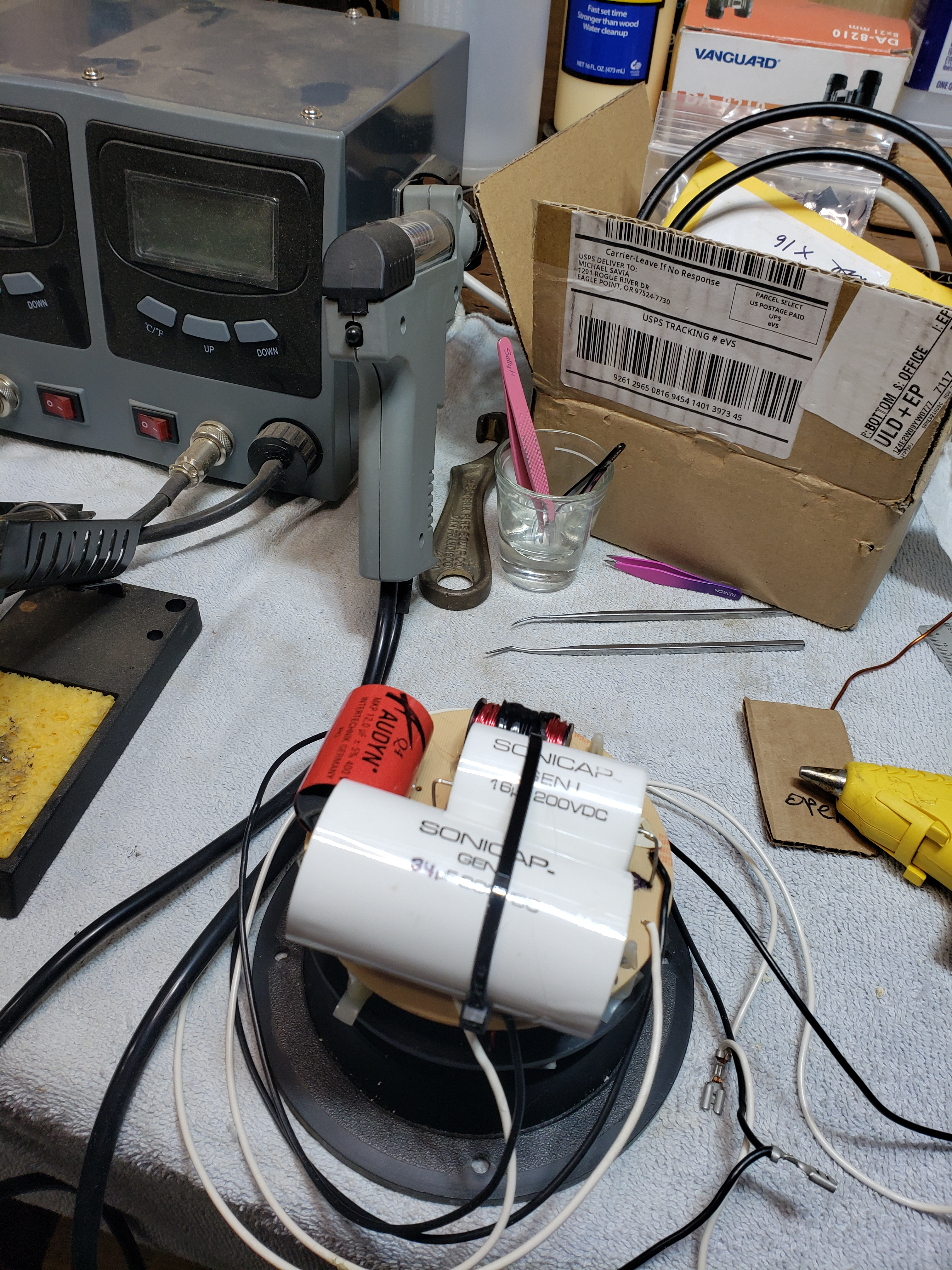

Crossovers (plan was to test different 12uF tweeter caps, however the owner likes these so they are staying put for now).
These turned out so awesome I went ahead and bought a pair of 11TL's for myself last week. Will post a thread on those sometime down the road.
