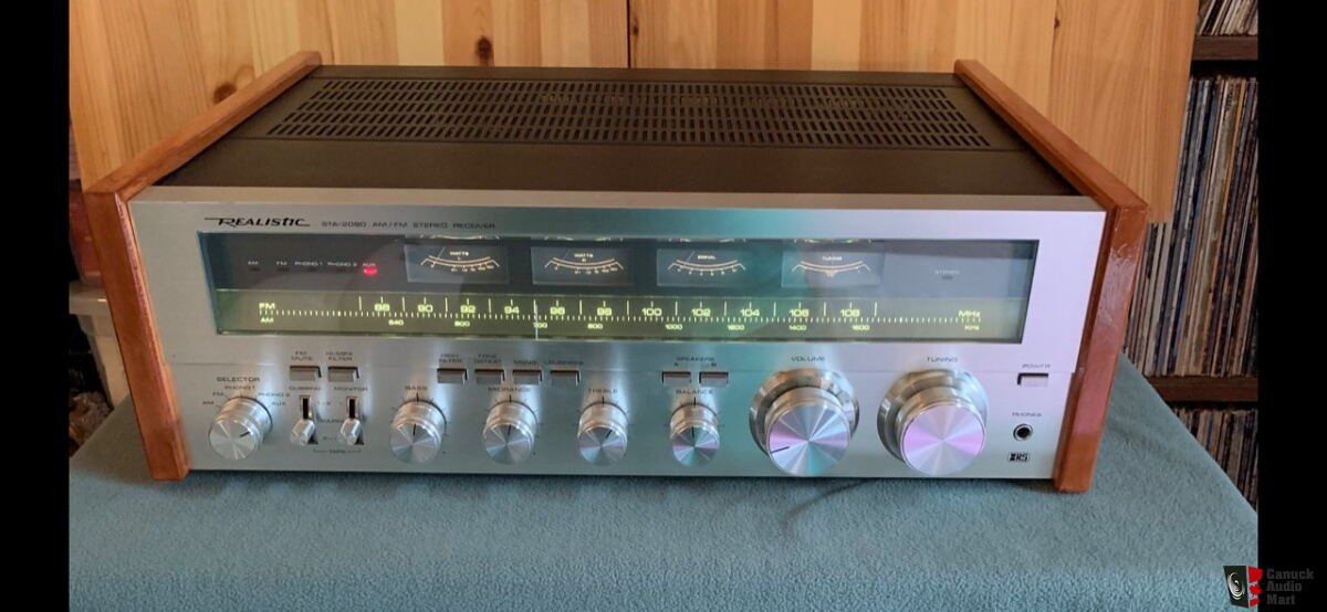

Bahahaaaaaa….
Thought you were gonna show a picture of a Realistic receiver.
skipshot12 wrote: »Bahahaaaaaa….
Nah, I grew up with this receiver and other than a clicky oversized volume knob, it wasn't very impressive. I'd still like to have one for nostalgia, but otherwise, I wouldn't recommend it.
