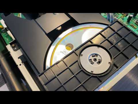

    The photo in this eBay listing is the belt that I’m seeing. I think all is well there.
    https://www.ebay.com/itm/185791887109
    This video is of my player once a disc is loaded. It should be spinning up and then showing the number of tracks on the display. The disc never spins but there is a noise as if it is trying to.
    I do not think there’s any belt going to the motor that spins the disc so it leads me to think the motor itself is probably toast.
    https://youtu.be/ueJ_34aBdU0?si=5Fombv5WWZ719vks
    Brian
    F1nut Posts: 52,382
    If the motor was toast you wouldn't hear that noise.
    F1nut Posts: 52,382
    edited January 2025
    Send the player to me or disconnect the transport and send the transport to me.
    billbillw Posts: 8,195
    edited January 2025
    Interesting sound. I once had a DVD player that had an issue with that magnetic clamp on top. That is actually an integral part to mechanically link the disc to the lower DC servo motor. Someone mentioned a bad capacitor possibly being an issue, but since they are computer controlled servo motors, that is probably not the first thing that I would look for. You really need to take the whole mechanism out and check everything up close. At this age, the grease on the slides could have hardened, the bearings dried out, etc.
    Check that floating piece on top to make sure it hasn't separated or whatnot. For the previously mentioned DVD player, I fixed it with a drop of superglue. IIRC, the magnet separated from the clamp or something. Most of the time, issues with CD players are from a bad laser pickup so I suspect this just needs cleaning/lubing on a micro scale.

    There's a cool thing about that Sony. The traverse rides back and forth on magnetic rails creating an air cushion for total isolation from the transport frame and therefore the entire enclosure.
  • skipshot12
    skipshot12 Posts: 2,142
    Wouldn't have a clue how in the world Jesse was able to diagnose that issue and make the needed repair.
    Damn nice job.
    I thought it had something to do with that magnetic puck. I've never seen a permanent magnet loose its magnetism though. That's odd. Glad Jesse was able to get it working for you.

    F1nut Posts: 52,382
    edited February 2025
    The answer.
    Despite their resilience, magnets can experience a gradual loss of strength known as demagnetisation. One common cause is exposure to elevated temperatures, which can disrupt the alignment of magnetic domains within the material.
    Physical shock or vibration may also affect the alignment, impacting the overall magnetism. Additionally, magnets can gradually lose their strength through a process called demagnetisation, where the magnetic domains revert to a more random orientation. This can occur through exposure to strong opposing magnetic fields or by repeated use in certain applications. In some materials, environmental factors such as humidity and corrosion can also contribute to a decline in magnet strength.
    While permanent magnets generally retain their properties well, external influences and environmental conditions can lead to a gradual loss of magnetic strength.
    I used a powerful magnet to realign the orientation of the small thin magnet.
