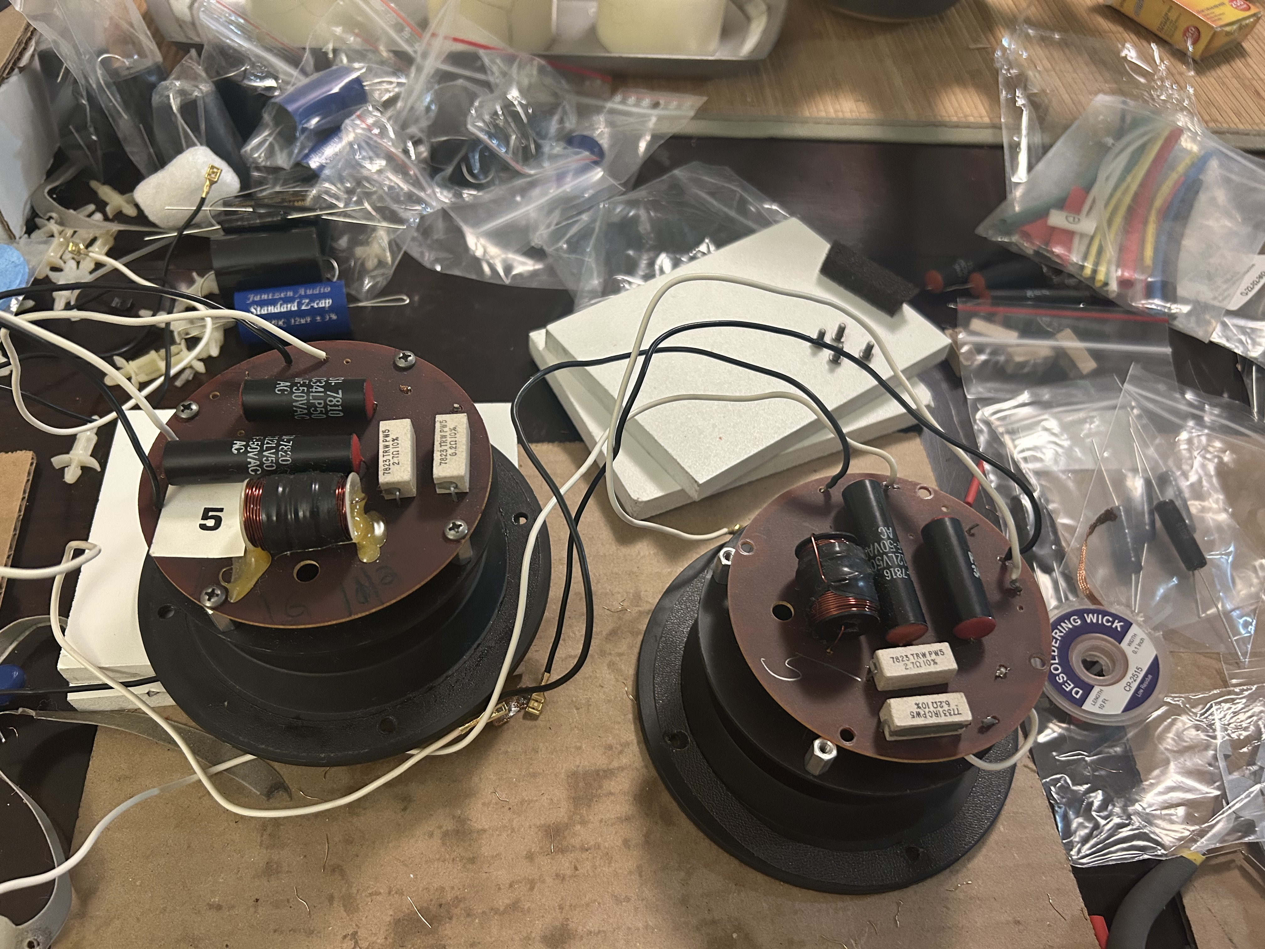

    Well I got so into into my 7s that I haven’t done anything with my 5s yet. This evening I decided to start looking into the 5s.
    First thing I noticed was the poly in this box was different from all my other Polks. It completely filled the box and was nicely cut out, not rolled up behind the tweeter and MW. It goes all the way to the bottom filling behind the PR.
    Also I noticed the crossover was slightly different with a 6.2 ohm resistor. I thought I had everything needed to refresh that crossover but that 6.2 was a curveball I didn’t expect.

    The crossovers on these also had metal standoffs not the plastic one they started using later. The inductor isn’t glued or zipped tied.

    It is interesting to me that it "appears" that the tweeter cap is another TSI electrolytic. But if so, it would be odd that it is larger than the 34uF 🤔 Is the tweeter cap 12uF like in later crossovers?
    The 6.2 Ohm tweeter resistor is of course interesting as well. Have you had a chance to check the DCR of those Peerless to see if Polk may have been correcting for ones that had a lower than the usual 7.8 Ohm?

    Yes 12 & 34uf just like all the others. Just wasn’t expecting the 6.2ohm resister. After digging around the the forum here I did see a couple of other folks had these same crossovers in their older 5s with that 6.2 as well.
    I didn’t notice any of the other model 5 crossovers with the metal standoffs like these though. The crossovers don’t have a date, but the back of the woofers from the same speakers are dated 11-1978.

    Comparing schematics for 5B vs 7C, both having the same MW6502 + SL2000 drivers, the schematics are the same except for the 5B not warranting the mylar tweeter capacitor and getting an electrolytic. So the question would be why are the schematics for 5A vs 7B different when they both have the same MW6500 + Peerless? I'm assuming the only difference is the tweeter resistors (6.2 Ohms vs 4.5 Ohms) but what if there are inductor differences, especially in DCR?
    Maybe you could check the DCR of the MW inductor.

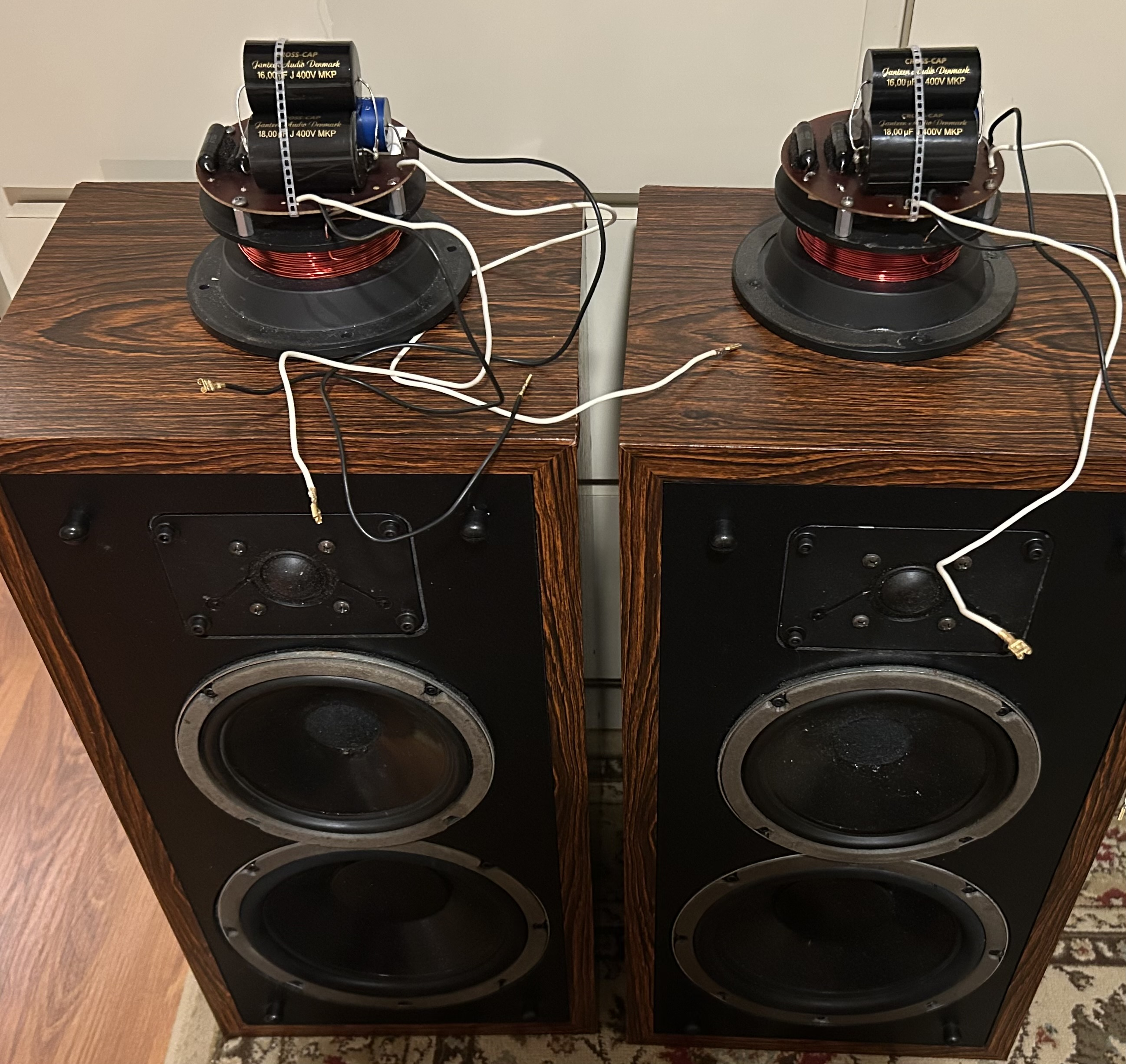

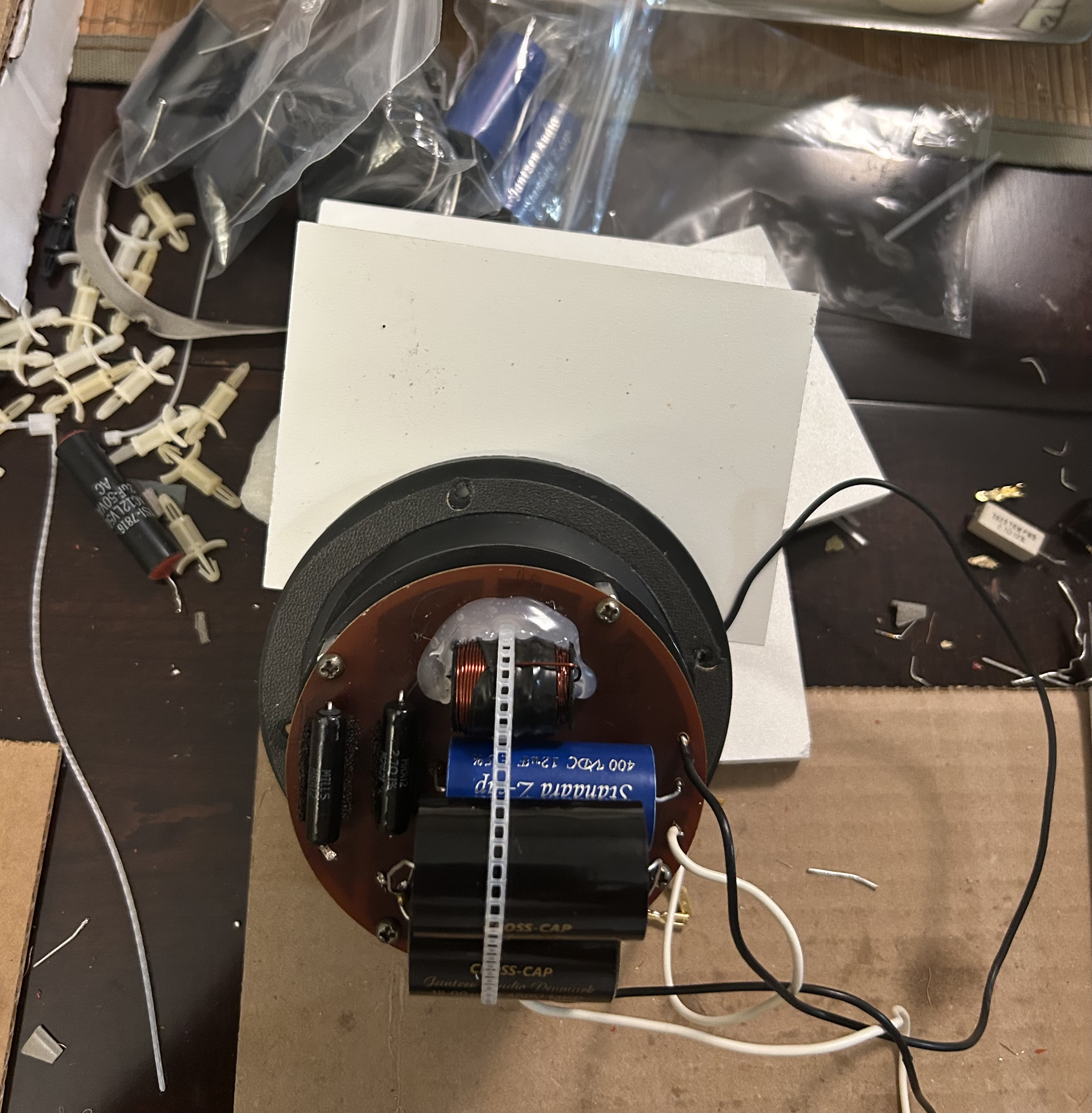

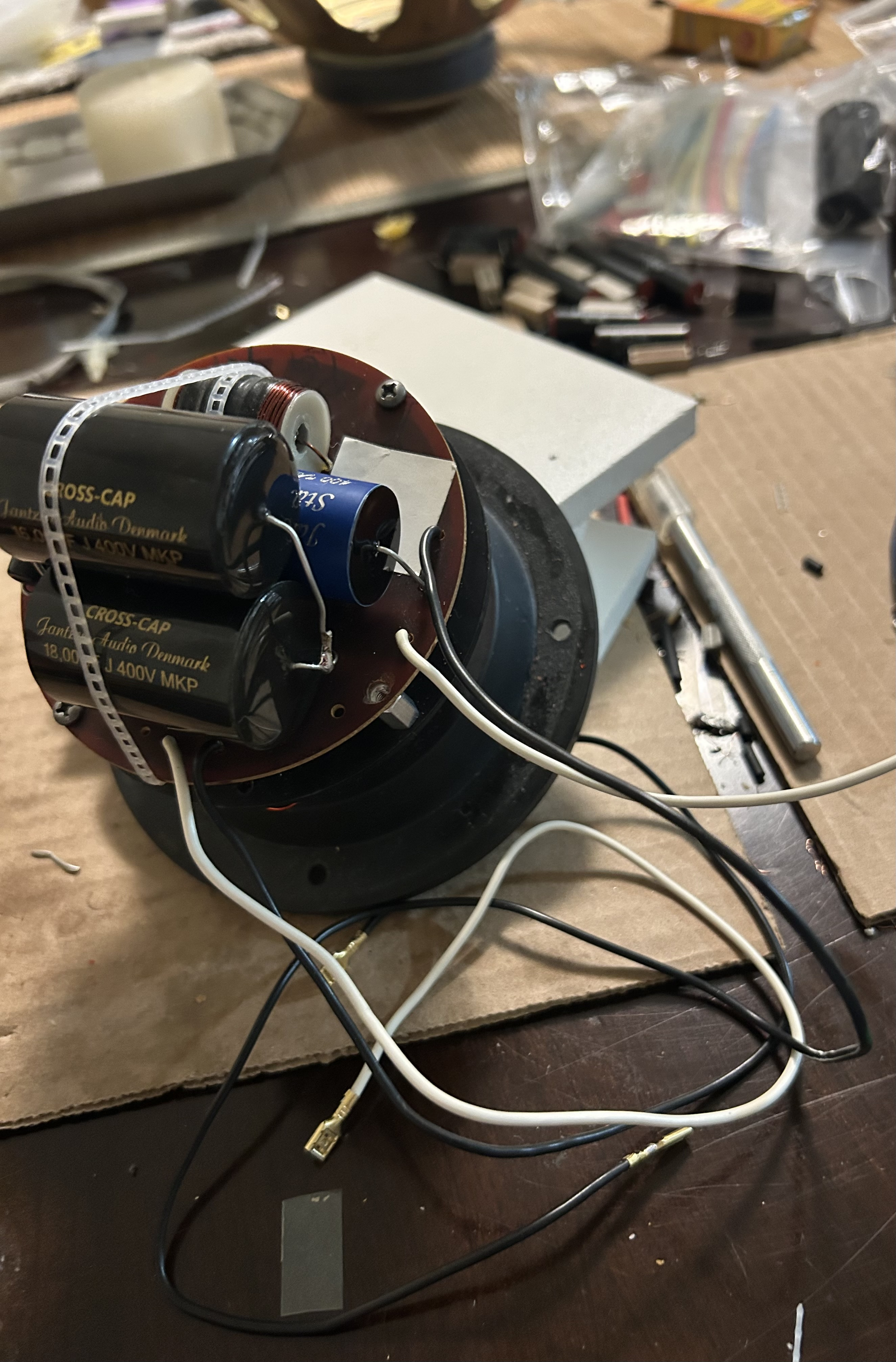

    I got the 5s crossovers recapped finally. I will work on the 7Bs next.
    I used Jantzen crosscaps 18uf + 16uf and a Jantzen Z-cap for the 12uf. Mills resistors.
    I’ll let you know how they sound after I give them a good listening to.
