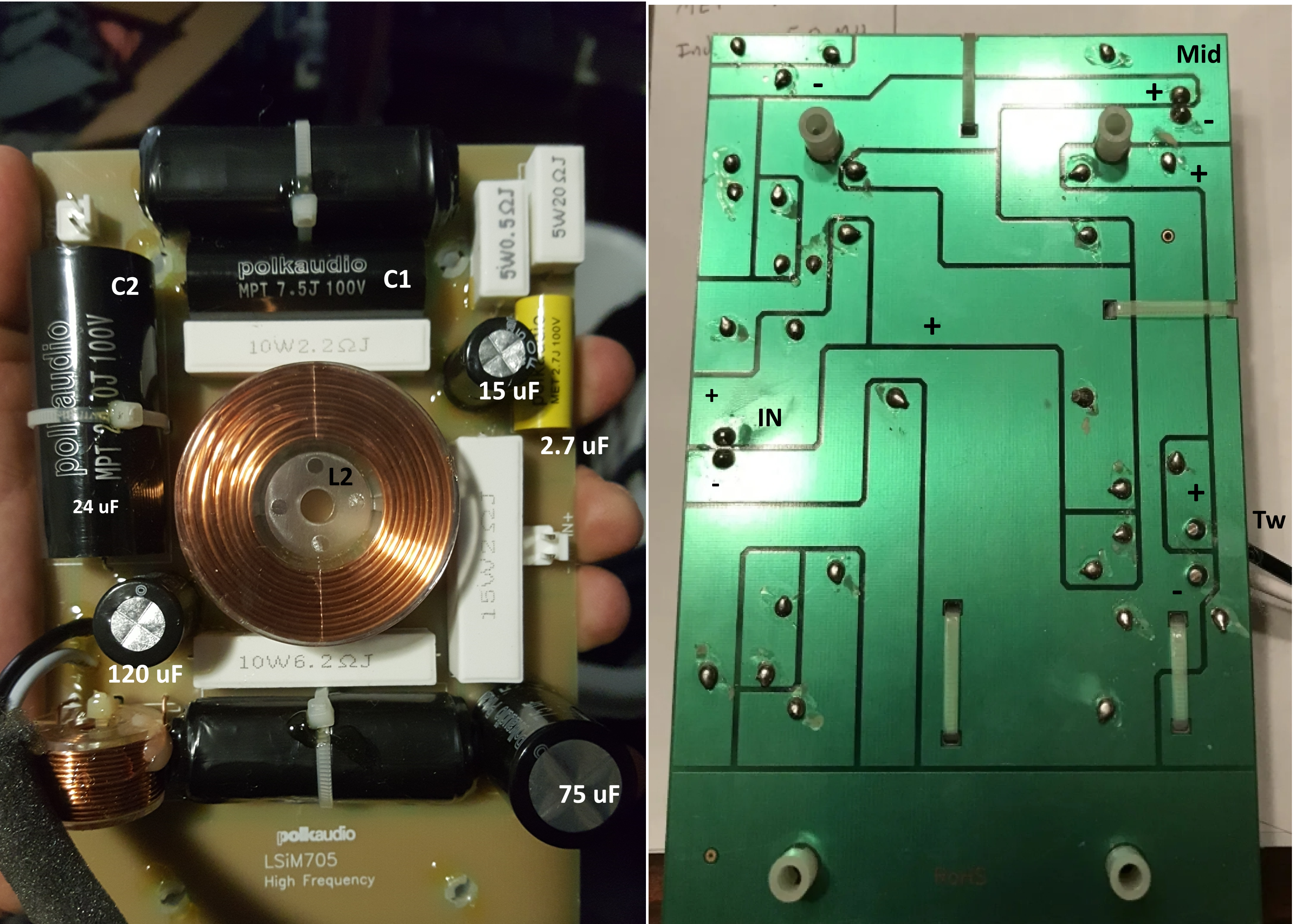

Recently I scored pair of LSIM 705 locally. They sound nice!
Now my front stage features all LSIM line up
Anyone has 705 crossover schematic? -
Need a little help with figuring out LSIM 705 XO schematic. this is how far I have gotten:
Best way is to draw it on paper versus piecing it together on the back, atleast for me- Not Tom ::::::: Any system can play Diana Krall. Only the best can play Limp Bizkit.
Ok, I figured it out. updated picture with mapping and it matches what Falcon sent me, however his component values table was not from 705 and that threw me off.

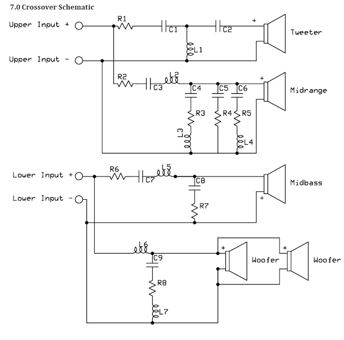

here is the lsim 705 XO schematic:
