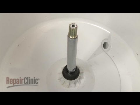

    Thanks, guys. I actually found this video, which makes it look easy for replacing the seal.
    https://www.youtube.com/watch?v=gnUfWVZEgCI
    I don't hear the bearing making any noise, so maybe fixing the seal will save the bearing, because changing the bearing would be a ****. Anyway, I found a seal kit on Amazon, so wish me luck!

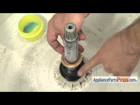

    I had to replace the lid switch on this Frigidaire a couple of years ago, but that was easy peezy. Yeah, some of the comments on that video I shared mentioned how nice and new the unit was. Here's a more realistic video on a heavily used washer:
    https://www.youtube.com/watch?v=Lhz3RCagTEI
    My unit is exactly the same as these, so I feel pretty certain that I got the correct part. But, we shall see!
