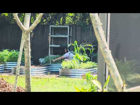

https://youtu.be/4xP8QsobctM?si=pH-flS4AhmmdK-Qf
Just an idea of the yard I'm trying to fill with sound. Took this today. She is in her happy place. -
Which BT speakers have you tried? For that size space it would need to be one of the expensive JBL models I'm assuming, or one designed for PA use.
Edit: This? https://www.crutchfield.com/p_109PBULTMT/JBL-PartyBox-Ultimate.html
It weighs 87lb ffs. -
