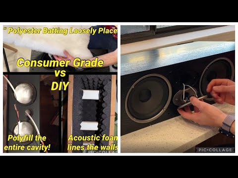

Hi. Guess I will post this here.
I've got this center channel, I was watching this handy youtube video to see how to open it up as well as see what its internals are about.
https://www.youtube.com/watch?v=E-lxErO5QKI
Here's my issue...
Found out some mice got inside and made a mess.
They chewed up the left side cardboard tube... which seems to be just glued onto the box on the inside back of the wood box.
I also want to throw away the original insulation blanket and toss in some better quality fill.
I am open to any suggestions on this!
Of course I still have to fire up this speaker to hear if it still works!
