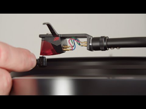

    Ortofon recommends a simple stylus brush and a simple cleaning method. Nothing else is required. Given the low cost I'd just get a name brand one or two. I also agree that clean records reduce the need for cleaning the stylus.
    https://www.youtube.com/watch?v=-rpR_OsSjb0
