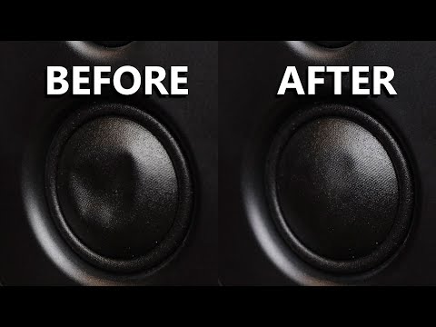

  • Emlyn
    Emlyn Posts: 4,844
    Strap a piece of duct tape on the 6510 and give it good old fashioned tug or several gently.
    Disclaimer:
    I haven't done that so I take no responsibility if you ruin the driver.
    Here's an example though...
    https://www.youtube.com/watch?v=vAvjTjTB9uU
