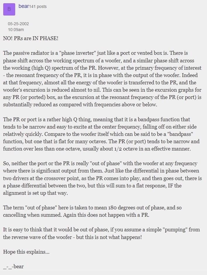

  • Not sure of the need for derision. Seems like a fair question to me and definitely something interesting to ponder over the first cup O joe. This guy on Audiogon seems to have an insightful answer and I hope he doesn't mind me posting it here:
    George / NJ

    Was this the one @xschop ? You can see the notch in the output of the driver at the passive radiator resonant frequency, where it is dampened by the PR and the PR predominantly takes over.4cw4ff8sa7pi.jpg

    Yes, that was like it. Reason why I Power Ported my first CRS+ set as they took less power to achieve higher bass spl in those frequencies.
