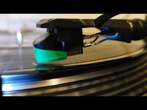

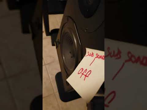

I have a Audio-Technica AT-LP120X with AT-VM95E cartridge. Completely as it came from the factory. Only 2 months old or so. They other day I cleaned up some of the albums that were given to me. Steve Winwood BITHL is what I started with and I noticed the woofers banging away. At moderate volume (like in the video) you can see the amount they are moving. I tried two other albums including a new Evenesce LP and the issues is still there. The IFI phono has a sub sonic filter. It seems to help some, as you will be able to see in the video. Around the 30 second mark, I pause the recording and turn the filter on. I also took a video to show that the records don't appear to be warped.
I double checked and recalibrate the anti skate and weight on the needle. I put 2.5g as stated by the manufacturer.
Should I be doing something different? The table is level and away from the music. Different room entirely actually. Lid is up.
Or is this nothing to be concerned about?

    That's weird! That looks like a lot of extra activity.

    Maybe I should try reducing weight half a gram. I thought increasing .5 gr but Drew said I should maybe reduce a .5 gr.
    I'll try that tomorrow.

    Even though your TT is in a separate room, what is the sound like there? Is it echoey, or reflective, or a place for sound to amplify or anything like that? Any way to cause feedback? It seems like this phenomena works a bit like feedback, even without anything playing. Does yours only do it with music playing?

    Only with music and gets worse with volume. Sound level in that room is very low.

    F1nut Posts: 52,380
    I agree with Scott, your cartridge/tonearm are bouncing.

    Should the cartridge be sitting so close to the record? After looking today it almost looks like the cartridge is hitting the record.
    Clipdat Posts: 13,104
    It does sit close which is normal, but I just re-watched the video and it's definitely bouncing strangely in the first 5 seconds if you look closely.
    At the risk of sounding stupid, can you confirm that if you pick up the tonearm and twist the weight to read "0", the tonearm will float freely in the air?
    I keep thinking it's something about the weight being off on the tonearm, or the suspension of the cartridge/stylus being damaged. Do you have another cartridge you can try?

    Of course the cue lift should be in the down position when testing for zero balance. The manual doesn't mention that. The weight and the dial move independently of each other, which is needed when calibrating to zero. But then when setting to 2.0, you can turn just the weight, and the dial will move with it. If the cart is truly bouncing, that would indicate the VTF is too light as it is, and a downward 'bounce' could be causing the hyperactive woofer.
