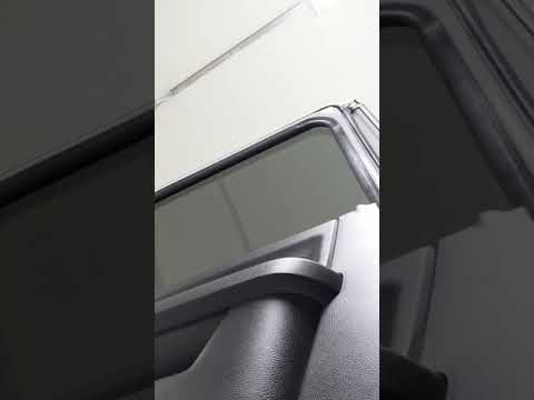

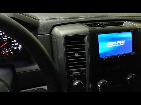

Here are two videos, the first is a normal ignition on (no engine start), and the second, is me jumping the power wire to the remote wire. Both videos the sound starts 6 seconds in.
https://youtu.be/obXWAiVEp3g
https://youtu.be/dUz-FFJmVkA
I believe I am now at the conclusion that this is a faulty amplifier. How else should I test to confirm?

Hello,
It sounds like you've done all you could to determine that the amp is at fault. Probably the best place to begin is by contacting Polk at: 1-800-377-7655 and follow the prompts for car audio. Or, you could send it to: Polk Service, One Viper Way, Vista, CA. 92081 include a note with your name, address, email address, telephone number a description of the problem and a copy of your sales receipt. They'll quickly get things straightened out.
