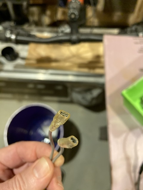

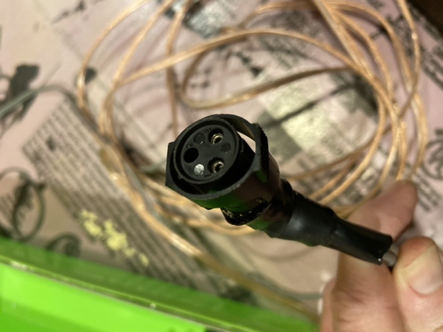

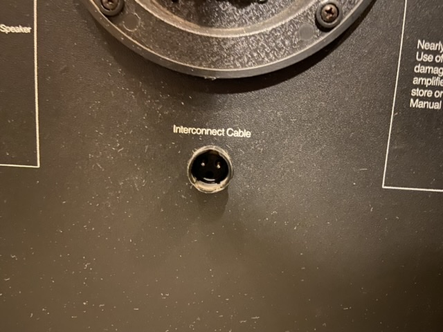

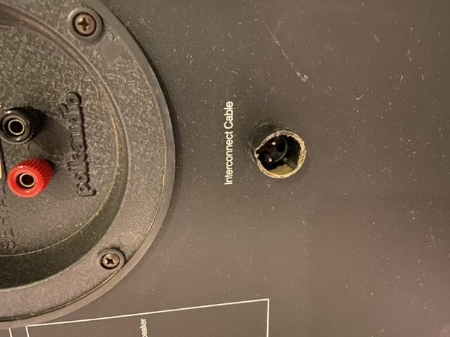

    I was mistaken about the blade thing I wrote above. Somewhere along the line, somebody made up the cable using blade style connectors on one end, but everything is pins on the speakers themselves. Here are a few more pics:
    Basically, my questions boil down to:
    1. Where can I get a plug that will fit the pins so I can make my own cable?
    2. How can I be sure I’m wiring things correctly? What I’ve been able to read on this seems confusing. Do I wire both right side pins together and both lefts together or do they need to ‘cross over’?
    F1nut Posts: 51,933
    That connector was the original SDA type. You can't find it today. Your best bet is to convert to Neutrik SpeakOn connectors. A search here will show the ones to get.
    The wires do not cross over in the cable.
