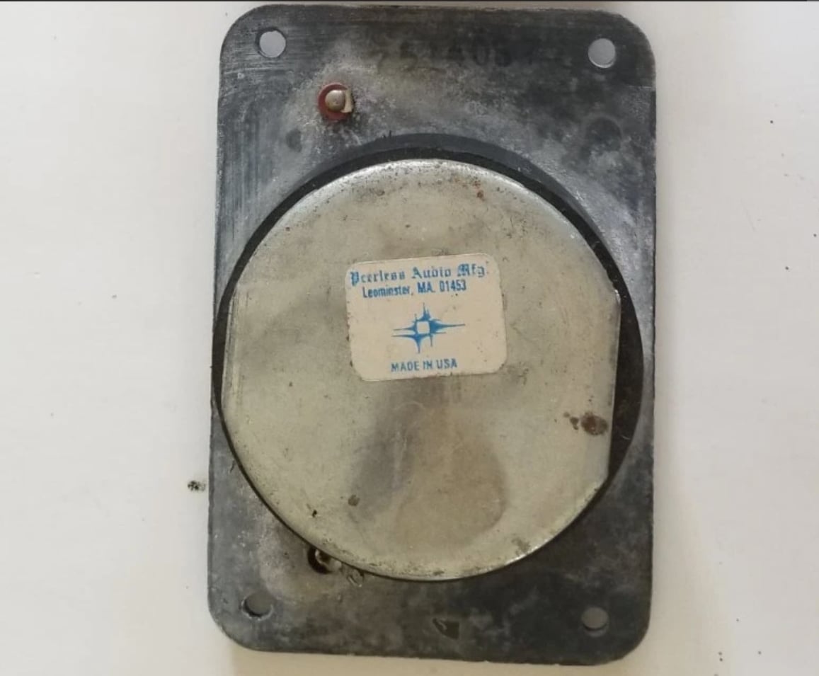

    Looks like they (Peerless) were stamping the prefix 7514 at the Leominster, MA manufacturing location as early as 1977, probably earlier even.
    George / NJ
    Onkyo A-8017 integrated
    iFi nano iDSD DAC
    iPurifier3
    iDefender w/ iPower PS
    xschop Posts: 5,820
    The offset flats are an enigma. Strange.
  • odcics2
    odcics2 Posts: 396
    They got a deal on slightly undersized bar stock.
  • Gardenstater
    Gardenstater Posts: 4,932
    And they didn't bother to center it 🤣
