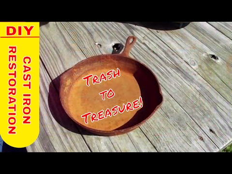

    I received some pre 1960s lodge cast iron today. 3 dutch ovens (8, and 14), couple of skillets and sauce pans.
    I have some rehab to do on them. They were my grandfather's and have sat rusted for a bit. Got some vinegar and steel wool. Will tackle it tomorrow.
    Vinegar doesn't work. When rehabbing pans you want to use lye to get rid of the thick black crud. Find a plastic container the pans will fit in and put maybe 1/8 to 1/4 cup lye to 2-3 gallons of water (search the internet). I never measured but I would start out low and if nothing happens overnight I would add more lye. Most pans will just wipe clean after a couple days soaking but occasionally you will get some that needs some extra scrubbing and soaking. WEAR GLOVES AND BE CAREFUL. You can also use a spray oven cleaner just make sure it has lye as an ingredient. This is handy for an occasional pan or two.
    When you are done wash the pans well with soap and water then you will need to season them.
    Pans with a lot of thick crud usually come out looking like new. The crud protects it from rust. Light rust spots can be removed with fine Emory paper but pits are difficult to get rid of and impossible by hand. Even with an orbital sander or a wheel on a drill it can be a lot of work and it is never perfect.

    The type of brush this guy used is what I used. You can get one for drill or angle grinder. Do not use brass use steel or stainless steel only. I also no longer use hydrogenated type of grease. I've found that vegetable or canola oil works for me just as well. When i wash in hot water after use I always dry completely by using the stove just until all water is gone then let cool in place.
    https://m.youtube.com/watch?v=VrJSyvMtTfE

    codycatalist, you had mentioned vinegar to get rid of rust. I am probably late in responding to this thread, as you may already be done restoring all of the pans but I just wanted to let you know what vinegar does and what it doesn't do. @delkal touched on it already. In those videos posted above, vinegar will not restore them alone.
    The reason for the vinegar is actually to stop flash rusting of the CI pan when brought back to its original iron (no seasoning at all) condition. Flash rusting is actually pretty cool looking, as I saw it with my own eyes rusting right in front of me within less than a half a minute when I realized I had left the vinegar spray in a location other than right next to the sink after washing off the lye. The vinegar still took the flash rust off without having to re-strip the pan.
    If they are badly rusted, they may be pitted but no worries. The pits will fill in over time and you can't replace the memories that came with the pans.
