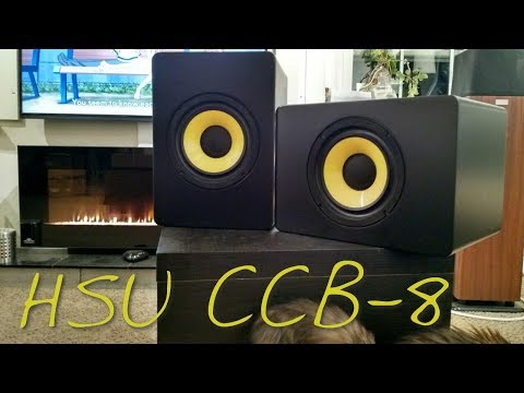

Another great option for a high output HT, in the same price range, with about a 6 dB higher sensitivity, and are very detailed are the HSU CCB-8. Coming from the detailed mids, and Lynnfield tweeter in your Boston's, you might really dig the HSU's for home theater.
