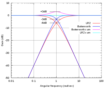

    FWIW, is that one should be very careful with crossovers in the midrange. Evolution has left us with tremendous acuity in the midrange; our species would probably have died off without it! As such, we're incredibly sensitive to distortions of all kinds in the midrange.
    I agree you shouldn't place the crossover spot at the area people are most sensitive at hearing. It should depend more on the optimal frequencies the driver / tweeter can produce.
    Unfortunately crossover points do not give a totally linear sound output. As one speaker it tapering down the output the other is ramping up. The goal is to not see the slightest blip at the crossover point............but in reality this can be very difficult.
    Here is a diagram for some of the common crossover designs to illustrate.
