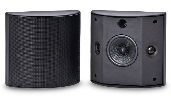

Trying to find a good pair of bipolar speakers for a 5 channel setup to match my Polk 705 and 706c. The couch is a foot off the back wall. So looking to either put them on a tall stand or screw on the back wall. It is an open space floor plan so the room is wider than it is deep. Goal is to have sound in a defined pocket of the seating area. The 702's might not get the WAF due to their size. Could not find a similar thread besides ones just discussing FXI models. Any feedback is welcome. Thanks!

    The FXI A6 sound good, but are pretty large. They stick out about 9 inches from the wall, so I would suggest the smaller FXI A4 with your couch that close, if going with the FXI A series.
    Just think this is a case where bigger isn’t necessarily better.

    Just FYI, the 702s are not bipolar, but have only one midrange and tweeter that is angled about 45° from the wall. They will work best slightly behind for 5.1 or slightly ahead of the MLP for 7.1.

    Thanks all I think I'm leaning towards some Fxi 4's on a pair of speaker stands so I could play with placement. They are cheap enough to experiment with and dump if I don't like them.

    Looks like the planets aligned and I found a pair of used FXI A4’s in White for super cheap. Guess I won’t have buyers remorse if I dont like them :)

    I have my FXiA6's on 30 inch Sanus Ultimate stands with 1.5 inch tall spikes. This puts the tweeters at around 42/43 inches, a bit above ear height. I can't imagine why it's suggested to put them 6 feet up resulting in sound way above my head.
