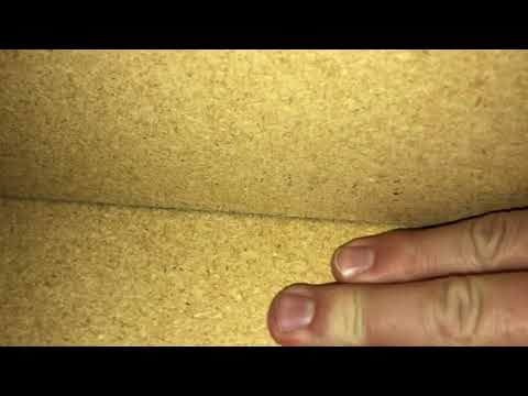

    So I took some time to listen to these ol gals tonight. Everything sounded great until I turned it up. Nasty resonance in the right cabinet. Fooled around with a tone generator. Sweeping low frequencies I found the vibration @ 110Hz. Check out this video, give me some suggestions on how to glue/seal the cabinet.
    https://youtu.be/M7NR2l3noa4
    Should I just run a bead of powergrab along the seams? I’m guessing this was a miss during manufacturing! Bet this cabinet has buzzed for 32 years!
    The left channel cabinet is sealed up good!
    Thoughts? Thanks!

    pitdogg2 Posts: 27,430
    Does it move visibly when you push on it? Yes I'd run a thick bead along all sides after I chiseled off that glue that ran. There are silicone caulk tools that will help push the glue into the corners and up the sides a bit which in turn will seal the cabinet much better.
    @pitdogg2 - yessir. It appears that they were never glued along those seams when they were assembled. I didn’t remove the polyfill when I was reworking the exteriors and I didn’t notice it the whole time they were disassembled! Any guidance for ways to force glue into the gap between the backplane and sidewalls, short of removing the backplane would be appreciated!
    If there is enough of a gap you may be able to either force very hot hot melt glue or some sort of thin glue that could seep into the seam. Either way the powergrab would be going over it and up the sides a bit on every corner of both cabinets.

    xschop Posts: 5,469
    Maybe use a 16 gauge needle and syringe.
    How about some extra cross-bracing while you're in there?

    edited March 2019
    For future reference, the 2-P10 will stick MDF and every other thing it touches together (skin, tools, paper towels, speaker cabinets, cement, table tops, sawdust, shoes, et. al...) that is some crazy stuff, use with caution. Ran a bead down each gap on the inside of the speakers, some clamps to pull the backplane up tight, wicked up in there perfectly, worked like a charm. Ran a bead of powergrab over the top just for good measure. No more resonant buzz. Sade, No Ordinary Love - bass for days. Sweet!
    Just need to redo the grille cloth and these will go up for sale! Only took me almost 6 months! Fun project though!
