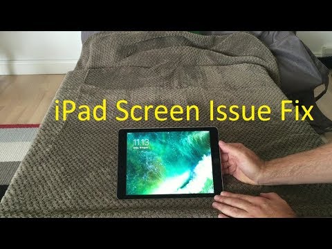

So I did a bit of research, and I found a YouTube video from a few years ago, in which a guy knocks on the back of his iPad Air and fixes a very similar issue. I said to myself, “What have I got to lose,” and gave it a go It now won’t come back at all (well, it did the first time I tried, but I only lightly tapped, whereas the guy in the video did a lot more pressure, second time when I did it like him, I’ve had no problems.) and if it was to happen again, I would simply repeat the process.
This seems to be a fairly common issue with some Apple tablets, along with other display issues. The YouTube guy’s display had a flickering issue, and he said he’d used the technic to fix several other display problems. I’m guessing the connection for the display inside become so lose after a few years, and the knocking is enough force to push it back into place?
Anyway, if you have an Apple tablet with this issue, give it a go. It worked for me, and it might for you.

    Here is a picture of the issue. Not my tablet.
    And here is the link for the video I found.
    https://m.youtube.com/watch?v=ayRPWsvZvAA#
    Not the same issue as mine, but the same thing worked.

    It’s a chip issue. My iPhone 6 Plus had similar problems. Tapping worked for a bit then didnt

    Oh, good to know. So far so good with mine, although it’s only been a day and a half or so.

    So guess what? As I was typing the above line, the issue returned! :neutral: Oh well, I’ll bring it down to the Apple store at some point and see what they can do for me.
    Well, for anyone else who has this issue, you can do what I did for just under two days of perfect display quality. :wink:
