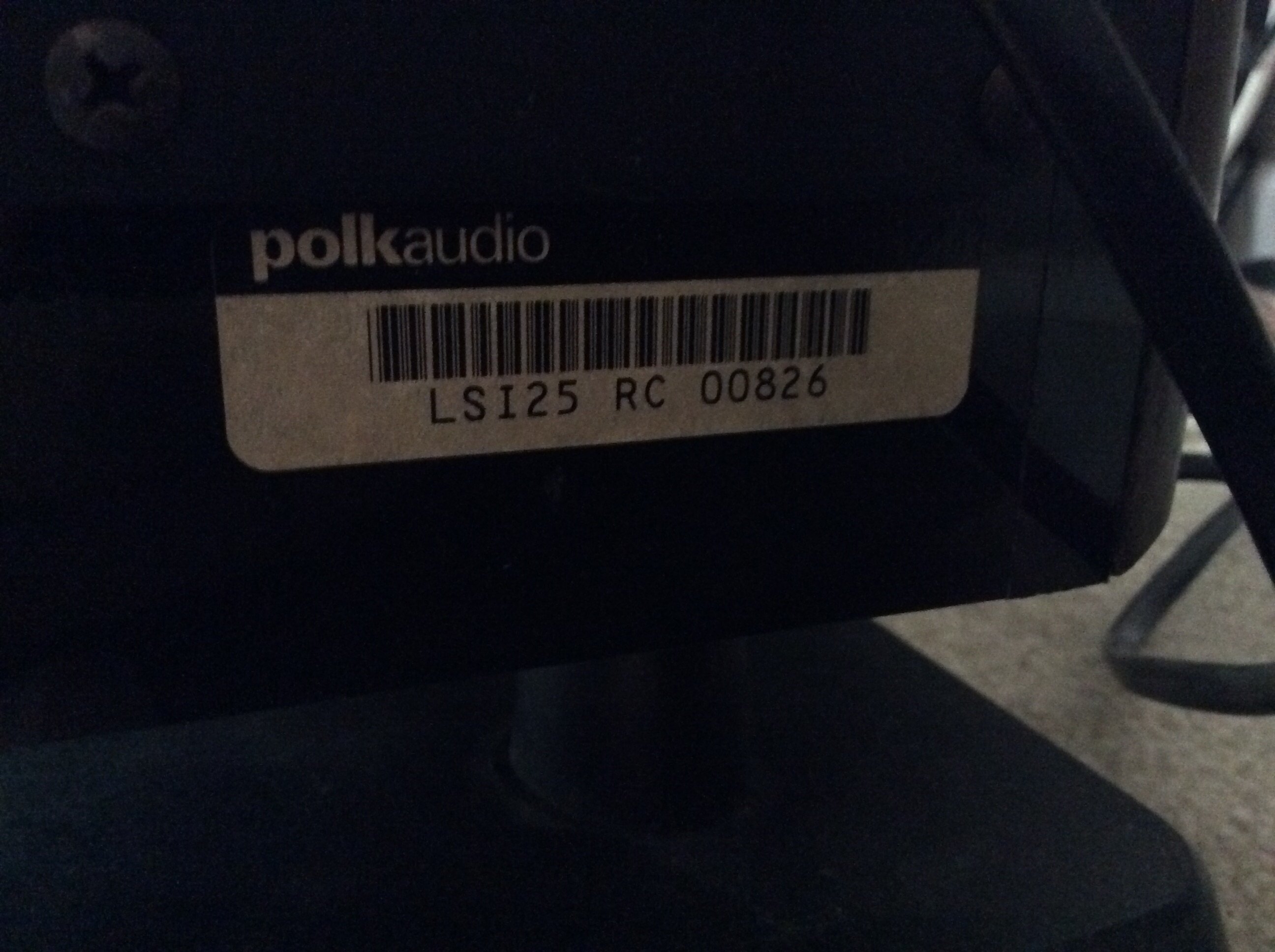

here is a very silly question. As I had said, I have recently inherited these lovely speakers, and I was reading the manual on the internet as to how they should be positioned. If each speaker is considered a left or a right, where does the side speaker (woofer) face, toward each other or facing the outside walls? I think I have them reversed! Thanks everyone, more silly questions to follow I am sure. -
Outside walls if they are the same as the 25s. The tweeters face in towards you. Look on the back near the serial number and it will say something like model LSi15 R (or L, depending on which one you look at).
Edit: I was wrong before, it will look like this except it will say 15 instead of 25:
