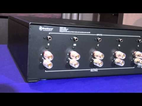

    tonyb wrote: »
    Tests on AVR's power ratings and other specs are done with a sine wave in a special chamber. Nobody is playing full range music to gather their specs.
    Advertised power output is based on full range playing conditions. Of course that does not mean that all freqs are being played at once. But, the advertised range represents basically the full spectrum for audio listening purposes. According to this tutorial, some manufacturers will base advertised output on @ 1Khz to increase advertised output. Therefore, it would stand to reason that full range vs selected range output does have an impact on overall output.
    https://www.youtube.com/watch?v=njnRckulS2A
    Again, I am not saying either configuration has any merit. What I'm saying is that there is nothing in this thread establishing that avr "bi-amping" is "doing more harm than good. "
