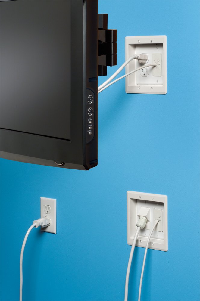

This is what I ordered to run power to the TV, with an extra outlet for the LED backlighting kit I want to install later

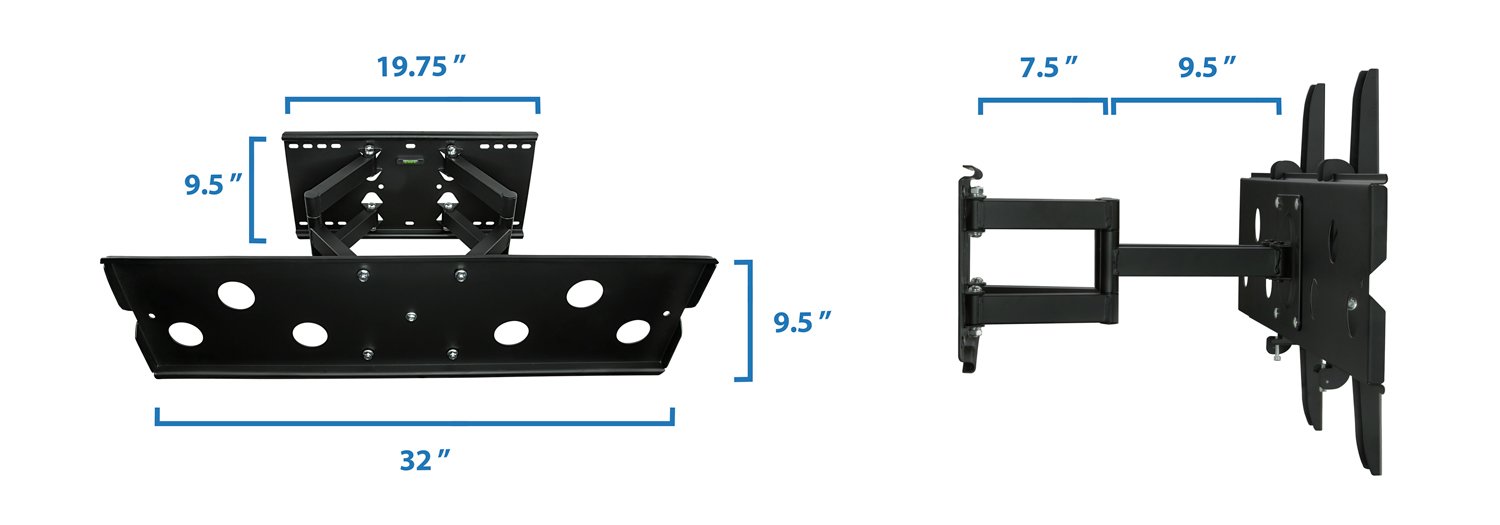

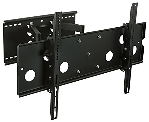

This is the wallmount kit I have, which was bought so I can swivel the TV for my kids if they are off axis.
And then this is the "fun" I got to have. Please note, the mount is made for a 16" on center wall, you know the STANDARD way you build a wall.
My wall is 24" on center so I had to span 3 studs with two pieces of wood (soon to be replaced by a single piece of plywood) and then mount the TV bracket to those.
As you can see, there is a fair amount of space to the side I can use for just the HDMI/Optical/Component cables separate from the power.
Keep in mind I'm not done with this room, and I'm also mounting things a bit higher as I am anticipating buying a larger TV (either a 50 or 55" compared to my existing 43") and dont want to have to adjust the mount up any at all.
