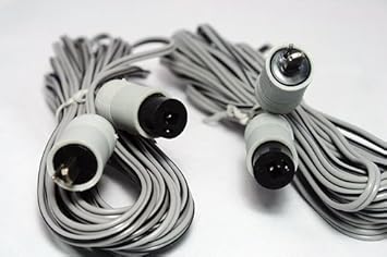

    Curious also, I see other images of the DM4's on the web, where that gray thing is actually has a black cap...example

    Does that plug have two flat blade connectors on it (EDIT: or a blade and a pin*)? It sort of (?) resembles a DIN plug (e.g., as used on European hifi equipment, especially older equipment, from brands such as b&o, Tandberg, etc.).
    EDIT: this sort of thing:
    __________
    * heh, yes it does have a blade & pin, doesn't it? :/
    Pretty sure its a way to use DIN loudspeaker cabling on that loudspeaker, just as some US-made loudspeakers in former times would have both screw connections and an "RCA" jack for connection. Radio Shack, e.g., commonly did this in the 1960s and into the 70s, and not just on their cheap loudspeakers. The idea was to give "flexibility" in connection options. Nowadays they'd probably call them "cable-agile" ;)

    Here're some pretty darned typical 1960s European loudspeaker cables :)

    Yep, blade pin it is.
    THANKS M!!!
