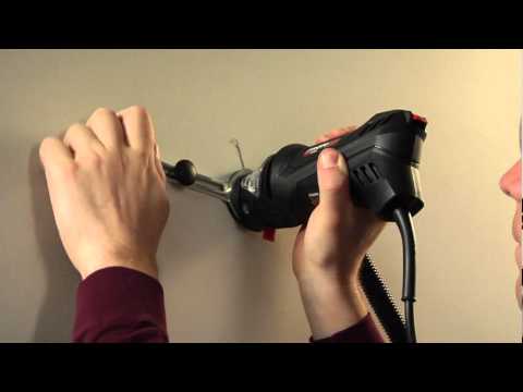

When it's time, rent, beg or borrow a Rotozip (or other brand) drywall cutter. They have attachments to cut circles. They also offer a vacuum attachment for the tool to suck up dust as you cut. Use a shop vac though, drywall dust can kill a vacuum cleaners motor bearings. Very fine and abrasive.
For rectangular cuts you can attach straight strips of wood to cutout portion for perfect straight edges. Or take a walk on the wild side, go freehand....
You can just use a drywall knife too.
https://youtu.be/Fmicz_HpbPg Salk SoundScape 8's * Audio Research Reference 3 * Bottlehead Eros Phono * Park's Audio Budgie SUT * Krell KSA-250 * Harmonic Technology Pro 9+ * Signature Series Sonore Music Server w/Deux PS * Roon * Gustard R26 DAC / Singxer SU-6 DDC * Heavy Plinth Lenco L75 Idler Drive * AA MG-1 Linear Air Bearing Arm * AT33PTG/II & Denon 103R * Richard Gray 600S * NHT B-12d subs * GIK Acoustic Treatments * Sennheiser HD650 * -
I own one of these
http://www.lsdinc.com/drilling-tools/7344/dual-bladed-hole-cutter2-channel: Modwright KWI-200 Integrated, Dynaudio C1-II Signatures
Great suggestions on the tools you guys. I certainly have no skills with drywall so any help I can get with getting the cuts right is good. Got a final appointment with the design center this week and then I sign the papers. Cant wait for the house build to get started.Sony BDP-S6500 | Raspberry Pi 2 | XBOX One S | Wii --> Yamaha RX-V667 --> Adcom 5006 bridged to 175 watts for front LCR -- >Front: Polk Audio RTi8s | Center: CSi5 | Side Surrounds: RTi4s | Rear surrounds: FXiA4s | Cheap 12" sub woofer|Samsung UN60KU6300
