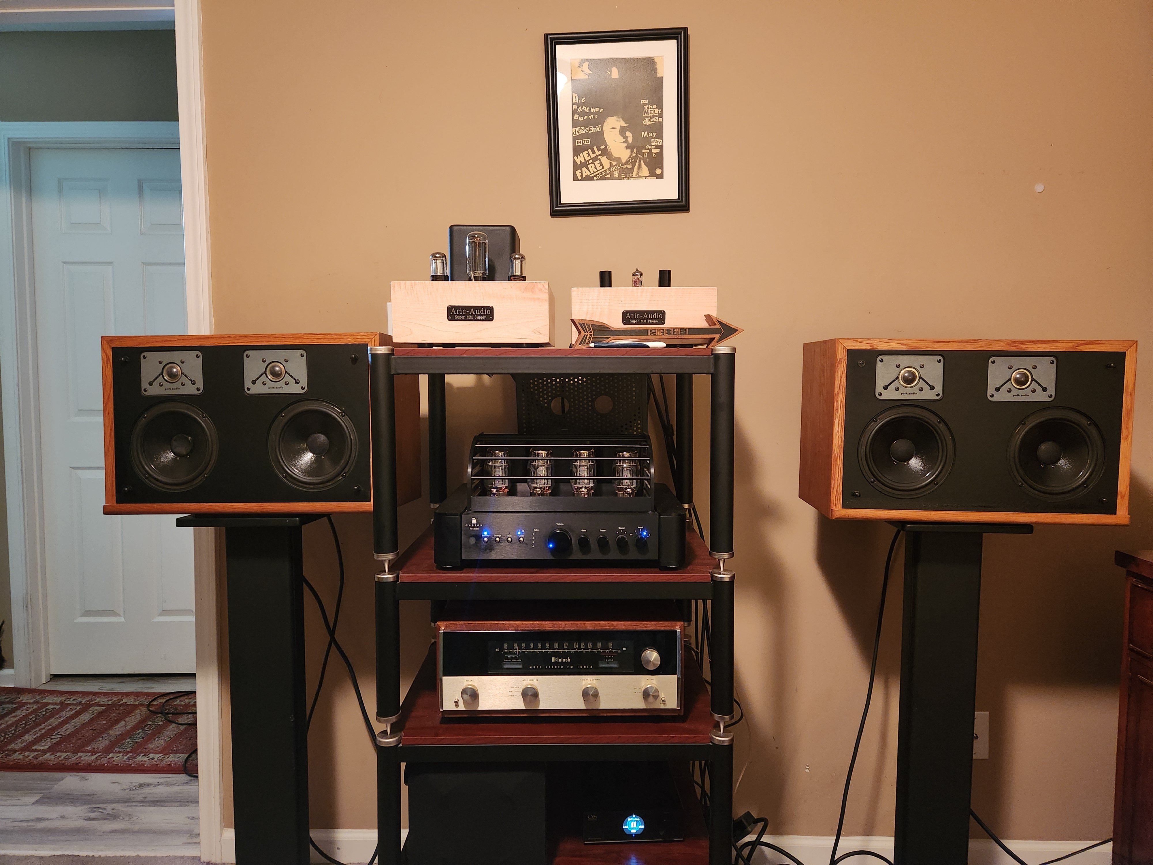

  • scottdavis_1967
    8 years later, and I found a pair of these on Craigslist. I'm using all but dimensional tweeters, and they sound amazing. From a system built in 1984, they are built very nice.
    I feel like I'm listening to an old big JBL speaker. Very nice!!!

  • scottdavis_1967
    scottdavis_1967 Posts: 5
    edited April 2025
    SDA/CRS. The 1st generation with two tweeters per speaker. These sound delicious on my setup. A Gallion ts120se integrated. They sound like they look. I have never owned anything from Polk. I've been missing out!! 😂 I mostly got on here to revive an old speaker system that surprised me, on being really terrific with a few adjustments. 😎
