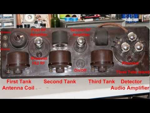

I saw this today while I was at Polk's ARAD facility. It belongs to one of the guys there, evidence they truly are audio geeks.
In case you can't make it out, it was made by Atwater Kent.

    That's a tuned RF (TRF) receiver; pre-superheterodyne; i.e., no IF nor mixer stages; multiple tuned circuits, all needing to be adjusted manually.
    Atwater Kent was from up this-a-way (Worcester, MA). The man himself (Arthur Atwater Kent), I just read, was born in Burlington, VT.
    The TRF radios have (or at least can have) very wide (audio) bandwidth -- bad for crowed conditions but great for audio :-)
    Yes, cool.
    I have one early radio, but it's an RCA Radiola (superhet), no TRFs here -- so far.

    That is a frikken awesome "set"... my dad tells me that's what they called radios back in the day. Do you know a date on it?
