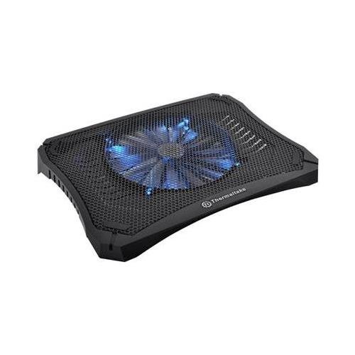

    You could always use a laptop cooler with a large fan to pull their up and through the amp.
    I keep meaning to get one of the Thermaltake ones for my B&K and another for the Denon AVR.

    The only thing I've read about those Antec's is that they don't pull a ton of air out.
    Here is one option I've been looking at. IIRC the LED's can be turned off too
