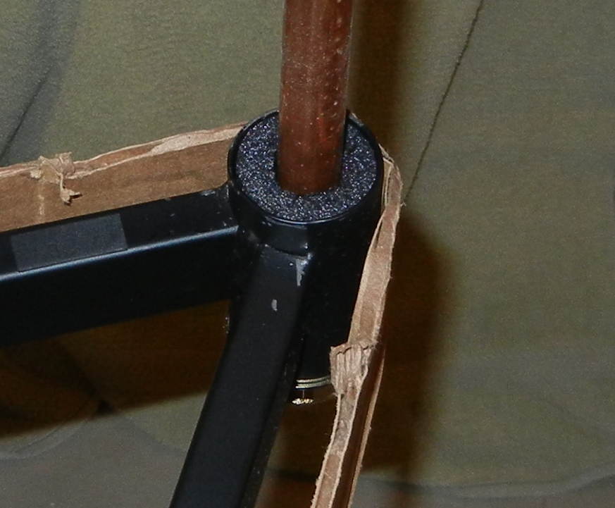

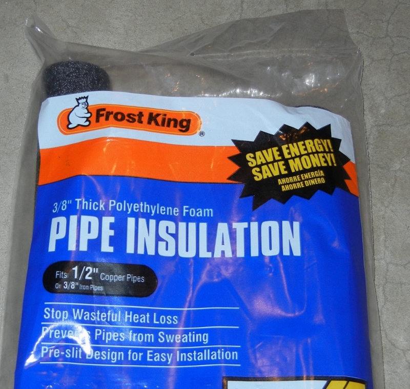

    Consider removing the top caps and using foam split pipe insulation. Of course that is just damping the tube without adding mass. That is what I did on my newest BL rack.
    Another possibility, plastic pipe with plugs or caps on each end cut to proper length that will fit snugly inside the tubes with caps on. Maybe combine with foam pipe insulation? Plug one end of pipe, fill them with sand or shot, seal other end. Note that you will have to shorten any pipes inserted in the tubes to allow for spike threads that protrude inside the tube past the threaded bottom caps.
    Here is an example with foam insulation and 1/2" copper tubing filled with shot with pipe caps sweated on each end. Obviously working with copper is a lot more work compared to plastic pipe.
