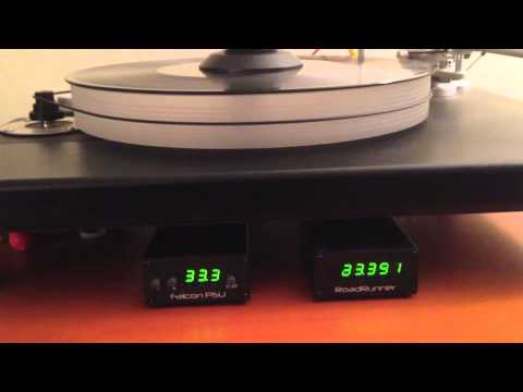

    I think that the combo of the two in the video shows how anal we can get about accuracy in our sound reproduction and without the ability to actually see what changes are happening you may always have doubt about the function. I guess that I am saying that I wish the Music Hall carried the digits out further than 1/10 to prove its ability.

  • That is a nice table, but even at its price point the control/accuracy of speed is left to additional gear. To think that we debate power cords and ICs to death but power supplies seem too esoteric and we trust the bean counters to provide accuracy.

    So if I'm understanding correctly...
    The Falcon and the Music Hall basically do the same thing.
    The benefit of the Falcon is that it can be paired with the Roadrunner tachometer to verify its speed.
    In the video he says that the Roadrunner is the more important unit. Why would it be when it can only measure and not assist with stabilizing the speed??
