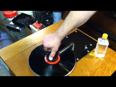

    Here's a manual RCM I made for someone getting to vinyl. He got out as fast as he got in LOL. With somewhere between 6,000 and 7,000 LP's I wouldn't be with out one
    I use a VPI 16.5 and I wish I could afford one of the nifty ultrasonic machines.
    https://www.youtube.com/watch?v=pvF4aBLAn2Q
