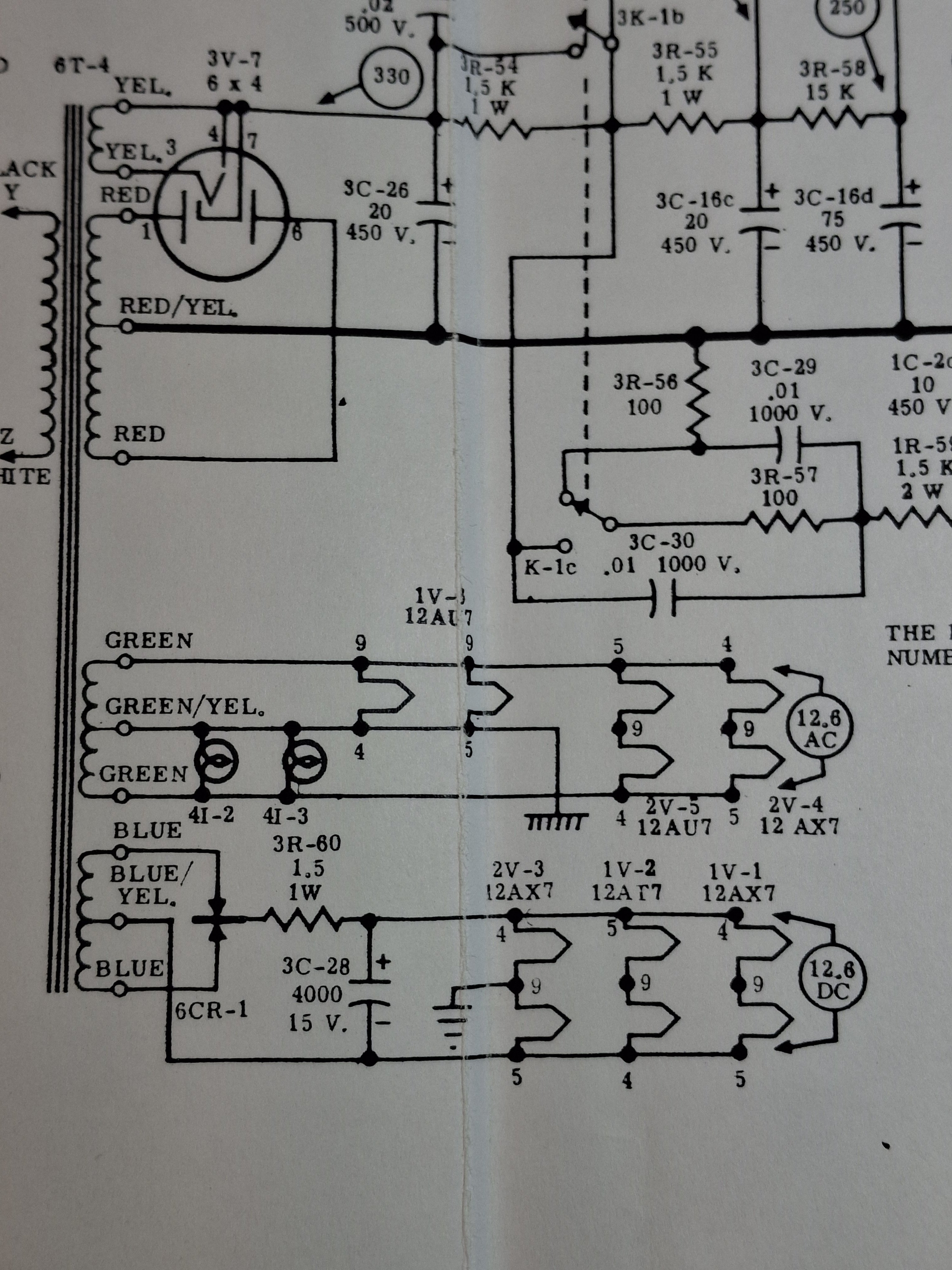

    Hi everyone. I'm about to start cleaning one of these up. I had one for a very long time and loved it. I am a recording engineer, so I always used it as a mic amp, along with (2) 350s and (2) 600s. Over the years I got rid of all of them, except my 351. Anyways, something unfortunately happened to it while in a friend's possession, and they did the right thing and replaced it for me (although not in plug and play shape). This one is a tad different, cleaned up, it will probably be better overall, I hope. It's got all of the vital parts. But I have a couple of questions for the experts:
    1. The face plate is filthy. What did you all use to clean it? Is it aluminum?
    2. My old unit had the green(ish) boards, and this "new" one has the blue boards. What are the implications? Is one better than the other? I imagine they are from different eras? Are the green boards from older?
    3. This "new" unit has a more gold/copper/bronze looking chassis, while my old unit was dirty gray. This "new" unit as weird trap door on the undercarriage of the unit. As far as I can remember, my old unit did not have this door.
    4. If I'm to try to build a diode rectifier to replace the og selenium rectifier, to I need to follow it with any sort of resistor to compensate for the higher output voltage?
    Thank you so much for any advice. I've already ordered the Hubbell 7464V adapter to make a power cable for it. My tech told me I'd never find one and to just replace it with and IEC. So this forum and thread are already helping immensely! Thank you!

    Q: 4. If I'm to try to build a diode rectifier to replace the og selenium rectifier, to I need to follow it with any sort of resistor to compensate for the higher output voltage?
    A: Yes, the silicon rectifier will have a lower internal resistance than a selenium based version resulting in a higher DC voltage going to the filaments of the tubes. Here is a schematic:
    To compensate for this 3R-60 will have to be increased to give the same 12.6vdc to the tubes. Is your unit functioning? If so place a DC voltmeter across 3R-60 and measure the voltage drop across this resistor. Then with the unit switched off remove one leg of 3R-60 and measure its actual resistance. Then take the voltage drop you measured and divide it by the resistance you measured. This will give the amount of the current flow drawn by the tubes. Then go ahead and change out 6CR-1 selenium bridge for your chosen silicon version and replace 3R-60 and measure the DC voltage at the point shown on the schematic. Let me know what you find.
