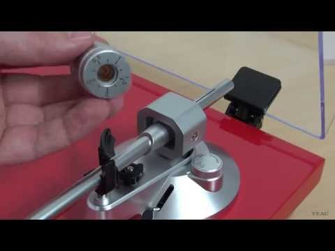

    Did it come with instructions on how to set it up? (Just saw that it did) I could tell you how you're suppose to do mine but mine is a little different than most I see as it has a sliding weight on the tonearm instead of only the rear weight. I can't find a video for your turntable anywhere.

    Here's a video in another language. Basically get the tonearm to balance evenly and level in the air by spinning the weight. Once you get it to do that you spin the numbered dial so that 0 is facing up. Then you spin the entire dial left until the desired weight is facing up. Then set the antiskate to the same number. It starts at about 1:20 into the video. Careful not to let the stylus smash down onto whatever is below it.
    https://www.youtube.com/watch?v=RF04aG7-CYM
