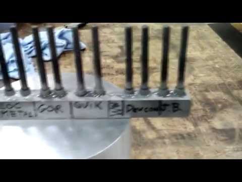

    That really shows nothing, proves nothing. That's more of a shearing strength test, and a very poorly controlled one at that. A more legit test of the strengths of these epoxies would have been to pull straight vertically on the bolts, not exert pressure from the side of the bolt.

    Good to know, thanks teekay. I thought I was passing something useful on, sorry about that.

    I thought it was interesting. The question is what is the correlation between shear strength and the other kind that teekay refers to.
