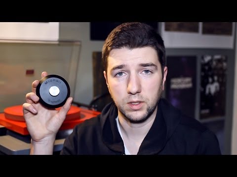

    here is a little video about that one
    https://www.youtube.com/watch?v=cT_4oSL4VgQ

    As a vinyl junkie, I thank you all for the comments. After looking at these clamps and doing some reading of various reviews, I ordered a J.A. Michell clamp. Should help me play a few of my not so flat garage sale finds. Thanks again folks.

    Just wanted to let you know, that my Michell clamp came in last night and I think it works great, but do not over-tighten when you use it. I am currently playing one of my pretty warped Pink Floyd DSOTM LPs that was previously too warped to play. Though it is still not flat with the clamp, it is now playable and I am loving it. I will probably not use the clamp on all my LPs, but my warped ones will get the Michell.
    Thanks for the thread. I may try the clear-audio twist for the bedroom, but I have to say I really like the Michell clamp, so I may decide to purchase another one. I got my clamp off ebay and it's the all black model.

    I have the Michell also, but don't like it & rarely use it. I find that using it on unwarped records can give the music a bit of a gritty texture. On warped LPs, I need to tighten it fairly tight in order to compress the inner felt ring or the clamp will slide up as it's playing. Of course it then becomes a PITA to get it off.

    Agree with the comments on tightening. I use the clamp on my Dual 1229 single spindle. The first time I used it, I over-tightened it and couldn't get the clamp off my Dual spindle. I had to remove the clamp and spindle off my Dual together and then had to use vice-grips to hold the spindle while I removed the clamp. Luckily, I didn't trash my spindle. I tighten now until I just feel a little resistance, then about a sixteenth of a turn. Please folks be careful not to over-tighten.
